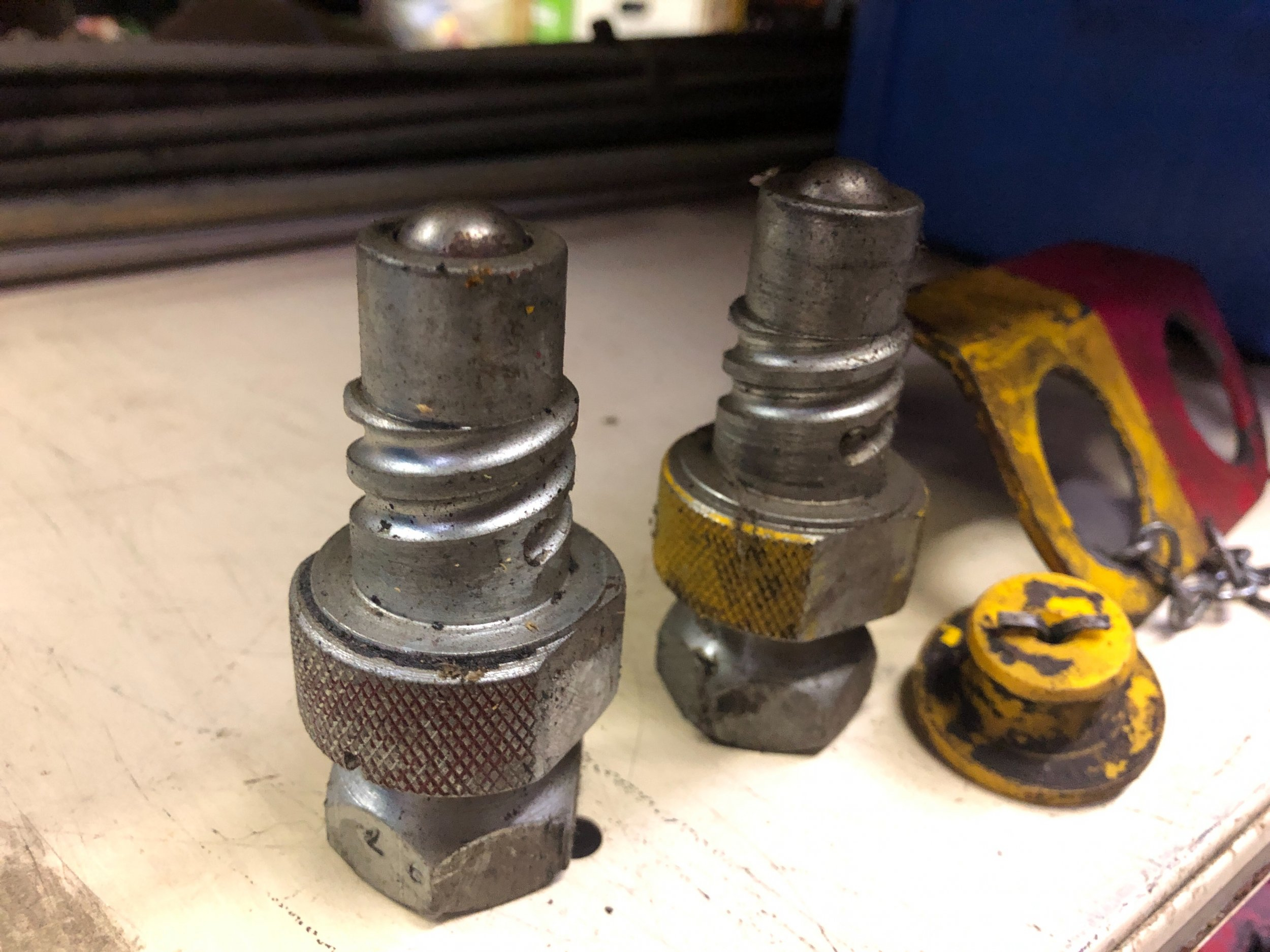

I’m new to having a tractor and have discovered quick connect hydraulics can come apart very easy. One of the hoses to the backhoe shifted while in use, the fitting was sitting on the PTO cover and the edge of the cover put enough pressure on the quick connect collar when it shifted that it popped open.
It was one of the return hoses and it damaged the backhoe control block with too much pressure on the used oil discharge side (three hose system).
Anyone have any tricks to guard the coupling collars and prevent accidental release?
find a bicycle innertube cut the tube in 10" pieces uncouple one at a time slide the rubber tube on the line and reconnect them slide the rubber tube to cover the connection and zip tie tops, may help.
