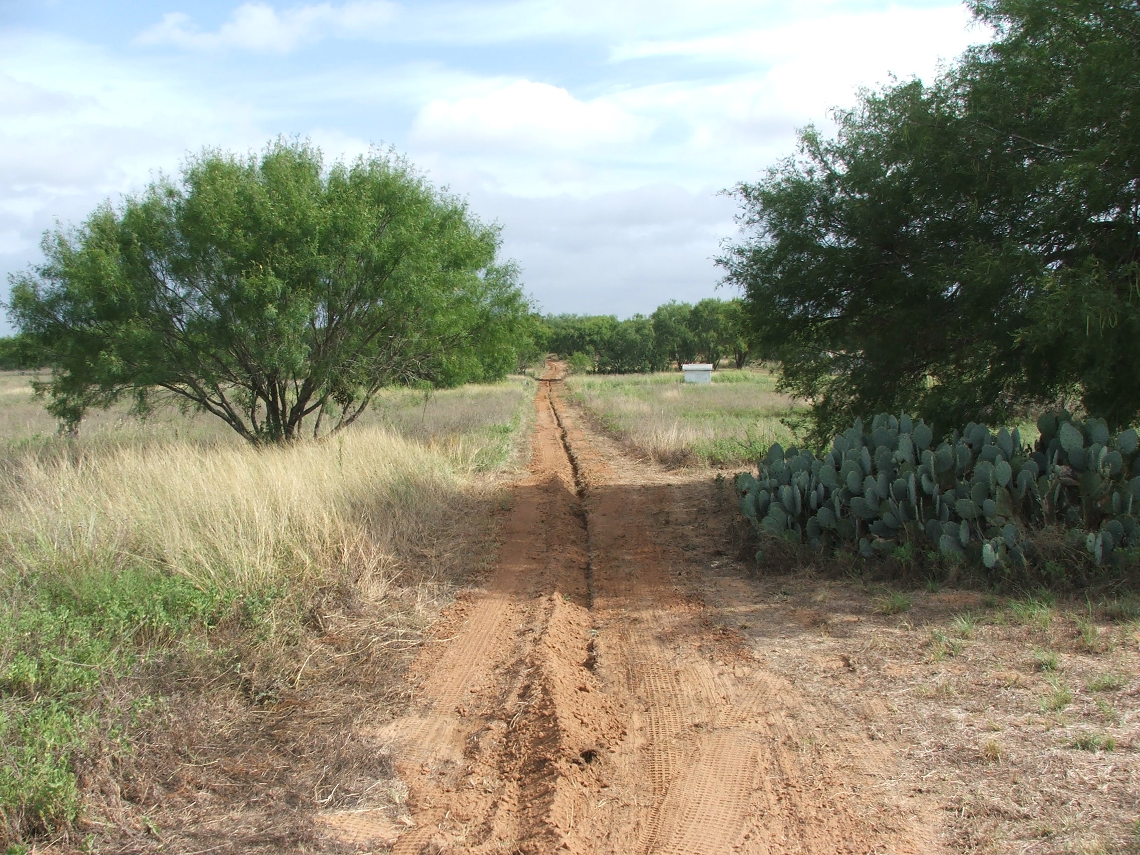

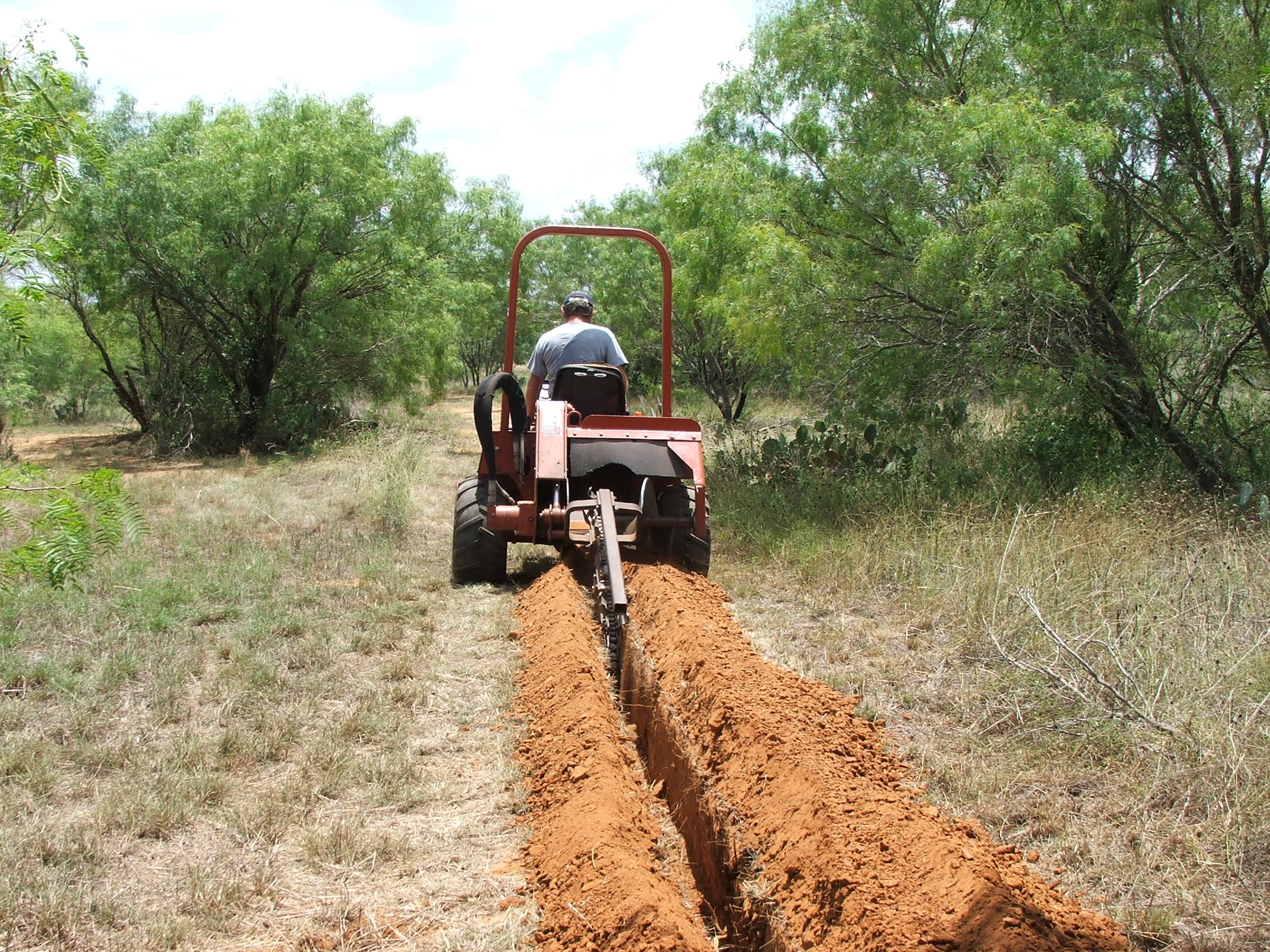

I rented a trencher and dug about 1300 feet of trench 3' deep for my water line. That was about as deep as it would go. That was hard clay and rock soil, and I did it in one day. Laid 2" pipe in it the next day and had "city" water before dinner.

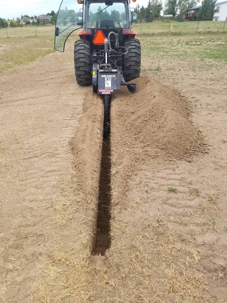

L4060hstc. 40hp & 6 speed Kubota HST+ tranny is barely slow enough. A geared machine wouldn't be slow enough & a normal HST may not be as well.
Bradco 612 trencher I got off Craigslist, some propane company stopped using it for installs. 3' by 6" blade. Due to angles it would dig a trench a little under 30" if I recall.
I've done a several hundred yards on a couple projects with it. Projects are done & I haven't used it in a few years so I need to take it to an auction or sell it. I also have an in with an ISP plowing fiber in all over the area if I need to do any more trenching. It got the job done ok. Not that much more problematic than any other trencher, but a 3pt on a tractor isn't as well setup as a real trencher. A fraction of the price though.
