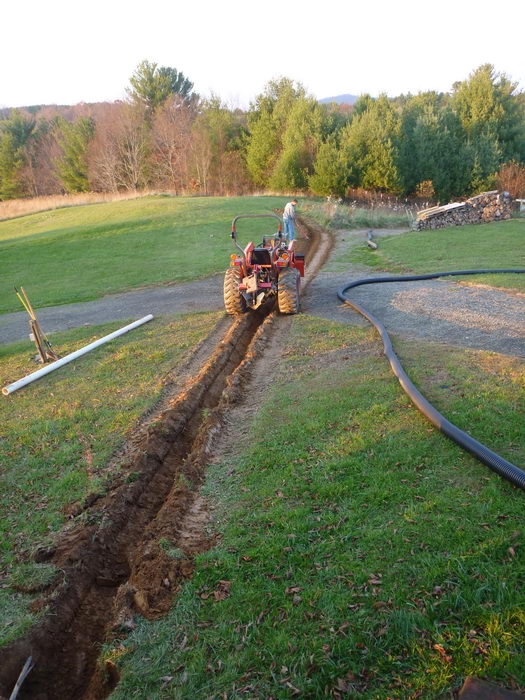

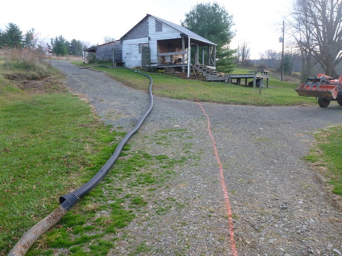

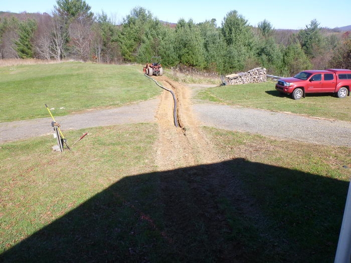

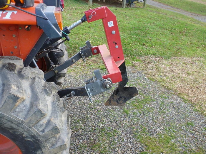

I've used a potato plow once... (had to add more weight to it).
I also trenched a sewer pipe (about the same distance) with a trencher (which was way EASIER). $75/half day.
I have a rear blade that could do a great job cutting a deep ditch (didn't have at that time...) Would use that if I need to do it again...
