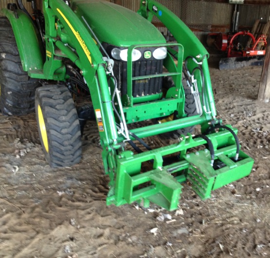

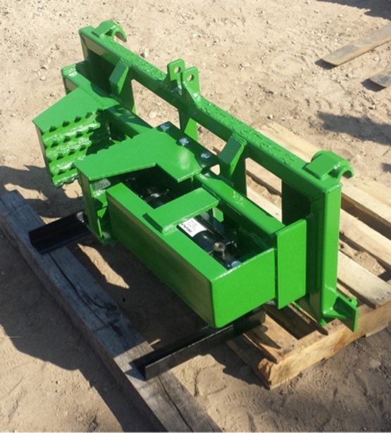

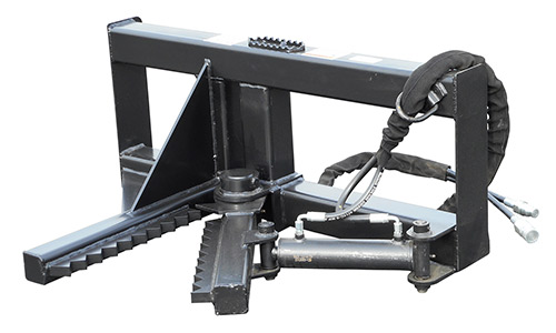

I'm in the market for the same thing and have been watching this thread with interest. A neighbor of mine has this unit from Carolina Attachments that he likes. He brought his tractor with the unit to my farm and pulled about 20 trees from 2" -6" in pretty quick time. The ground was just the right dryness and he was able to easily shake the roots until very little remained on the roots. I called CA time morning and was quoted $1500 shipped and set up for JD loader and pioneer couplers. 10-12 biz days to build, 1 yr warranty, American made. I asked about the Titan unit I was also looking at and rep said it was made in China and there were QC issues. FWIW

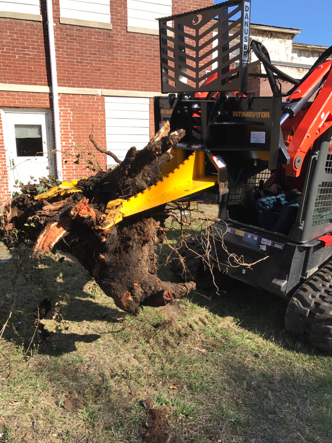

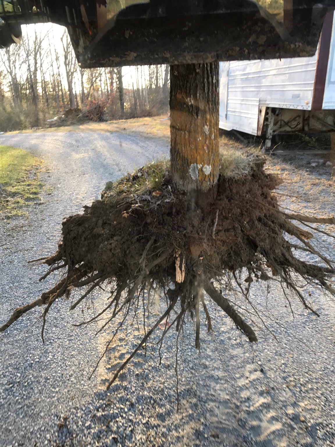

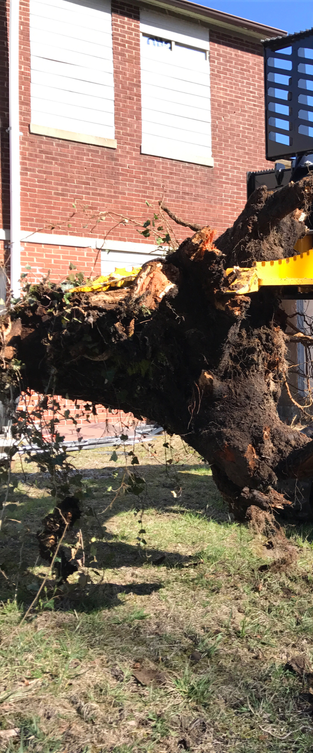

I used a Danuser intimidator today. Coupled with a Kubota SVL 95 it was a beast. I can't help but think it would be nearly useless on a compact tractor.IMG_9354.JPGIMG_9353.JPGIMG_9364.JPGIMG_9367.JPG

I used a Danuser intimidator today. Coupled with a Kubota SVL 95 it was a beast. I can't help but think it would be nearly useless on a compact tractor.View attachment 500616View attachment 500617View attachment 500618View attachment 500619
I'm jealous of your ability to use it on a CTL. You can see EVERYTHING that is happening. I have about 15' between me and the pull, and a tractor front in between to boot.
I'm going to get a CTL to use with it when I clear out a small grove of trees that needs cleaned up. My tractor won't have the ability to deal with the side hills and tightness of the trees. But... I have to get an adapter to hook SSQA to GLOBAL.

Even on the CTL the shield ( which is 100% necessary) on the puller blocks a lot of my sight. I haven't ever used one on on a tractor ( and don't plan on it ) but I think it would be doable. I think you could use the shield to fairly accurately gauge your position.

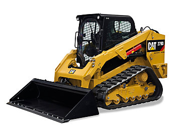

Curiosity has got me, I'll show my ignorance and ask(I already googled it), what does CTL stand for? :) Gary
/ Tree / Post Puller Type & Manufacturer? #33
Compact track loader.
/ Tree / Post Puller Type & Manufacturer? #35
Thanks guys. I was pretty sure it was a "skid steer" of some kind, but couldn't think of anything that fit. Seems like that happens more often as time goes by :rolleyes: Gary

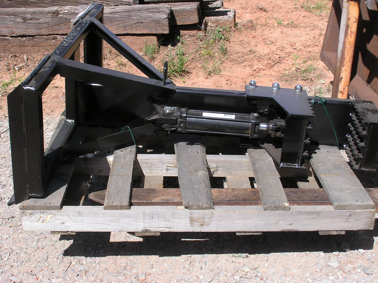

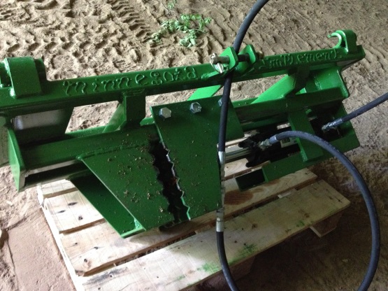

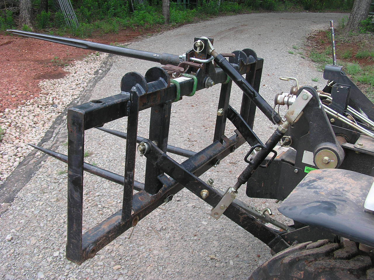

I just made one for the loader and it works good. Mine is in the center of the loader and I have seen them off to the side, don't think that is a good ideal. What I found not so good, I wanted to be able to see the base when I hooked on to the tree. The cross tube on the loader is right in the way. The only other thing I didn't like was I would cut off some of them. I only have a 2" cyl. I think I might put a pressure regulator on it. It sure pulls them out good and you have control over the tree, beats the ---- out of a chain and only one person can do it all.
Update on mine: Used the 2nd time on flat ground and was able to pull 3 and 4" stuff easy. Then thought I would give it a good try, hooked onto a hickory tree about 4 to 4 1/2". Forget that and when I got back to the shop I bent the bottom cross frame. How I bent it was by moving fwd and back, it did not bent it going fwd only when I moved back.
Tried to pull it without heat with the loader, but couldn't. After braking a chain I put some heat to it and got it back where it was. As you can see in the pictures, I but 1/2" X 3" on the bottom cross and a 3/8" X 2" across the top. Went back out and hooked on the hickory again and could not bent it, just didn't have enough tractor and the hickory is still there.
The pictures the lighting isn't real good the sun was in the wrong place.

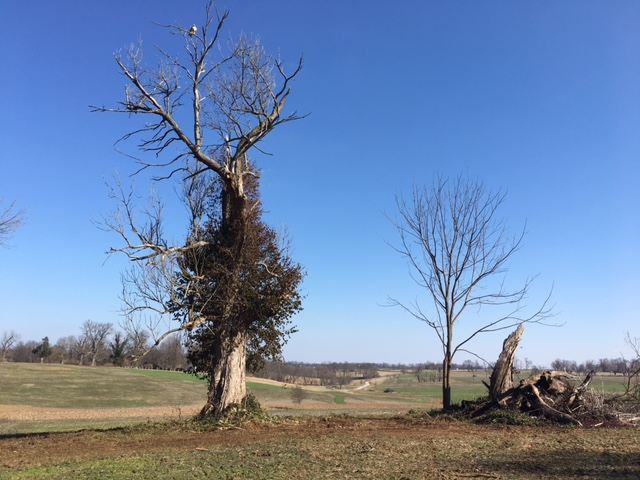

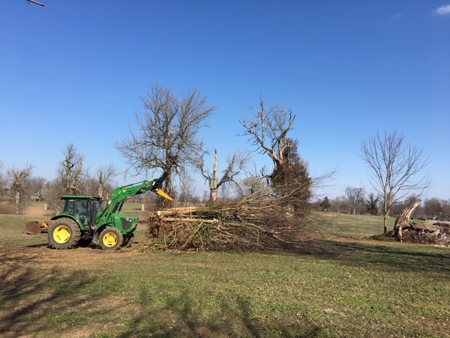

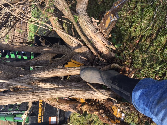

This is a bit of what I've been doing this week. I have about 20 - 400yo blue ash that have been farmed around for 20+ years, without any upkeep. We are clearing everything. Being in KY, we have a huge amount of honeysuckle. Left alone, it can grow into several trunks from a common root. This is an example of why I believe the Intimidator style of puller is excellent.
Size 12 Muckboots
