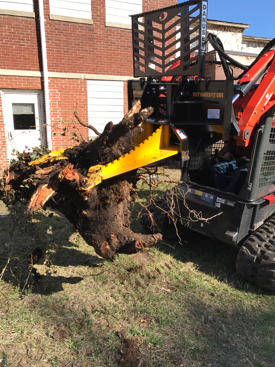

A Danseur intimidator.

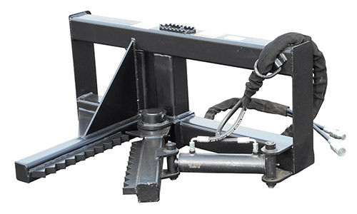

Has anyone on here actually bought one of these from Notch? I like the design concept and the price but it would be great to hear from someone that is using one.
I haven't had time to get back to the forum to post. I bought the Notch, and it is a beast. Works as advertised. I am not an expert on it yet. Different plants require different techniques. I am primarily using it on "Huisatche" re-growth which has been shredded for years. It sprouts new trunks from the stump each time it is cut off. So there are multiple trunks to try to grip. A tree with one trunk is much easier to get a "bite" on that will hold. I am well satisfied with the Notch, and will be more so as I learn to use it better.
I installed a camera which helps, but still can't see the total image of the puller. I am using a Kubota M7060HDC tractor. I have used 3 point devices before, but my neck bothers me too much for those.
The notch is VERY similar to the Danuser Intimidator. It is about $ 1k cheaper, customer service at Lake Henry Implements is great. I have about $2300 invested including the hoses, connectors, backup camera, and misc hardware. If I were to clear all the huisatches, the price per tree would be very small:D I'll post some more pics as time allows.

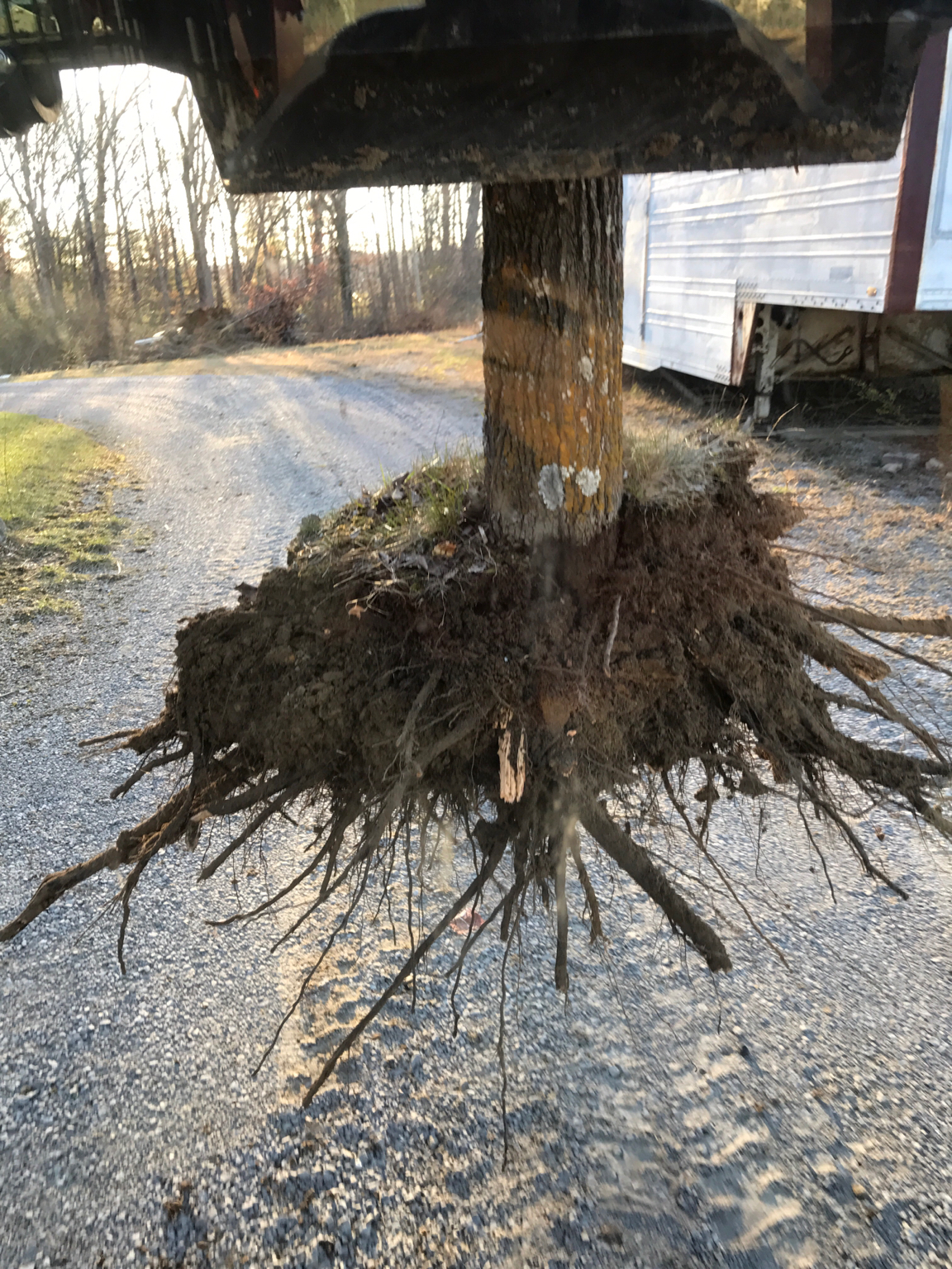

I also just picked up a Notch tree puller... it's incredibly well built and works very well. I was worried that it would be too much implement for my L2501, and while it's at the top end of my tractors capacity for attachments IMHO, technique and design more than make up for the slight mismatch between tractor and puller.
I like that it has grease zircs in all of the proper places. The cylinder is tucked behind the work area. Overall excellent value and excellent build quality.
It has turned otherwise equipment abusive projects into less stressful, less time consuming ones.

Dadnatron and 4570Man, the Danuser Intimidator arms are 12" longer than the Notch (according to the specs.) and have interlocking, replaceable excavator teeth. The saw teeth on the Danuser are smaller but more numerous than the Notch. My question is this: based upon your experience with the Danuser, are the 12" longer arms / tip design and smaller saw tooth design of the Danuser a worthwhile advantage over the shorter arms and large tooth design of the Notch?
/ Tree / Post Puller Type & Manufacturer? #54
I use every inch of the blades in some form or another. So my knee jerk reaction would be to say 'Yes'.
However, on a SCUT or CUT, they might actually be a hindrance. I have a 100hp tractor, so I've been able to take advantage of the size of the blades. I can't really believe you would ever 'replace' a blade as they are huge, thick, and buttressed. I think the weak point in the chain will be the FEL every time, hence the 'however'.
Having never seen the Notch, other than on this thread, I cannot discuss its merits. But if you have a larger tractor or especially if you have a CTL, I would certainly look carefully at the Intimidator/Notch size variance. I dig with it when the trees can't be pushed over initially. I have only ran into 1 tree that I couldn't get out of the ground, and it was an 18" Oak. I pushed it over, but couldn't get the roots out of the ground. As you can see in my pics, the size of what you can remove can use the entire size of the blades. So, for my purposes, I needed and had the ability, to use the large size.
However, if you have a smaller tractor, the FEL might not have the breakout power to lift something that would require those larger blades, so they would go unused and all you would have is a heavier puller trying to level your back wheels off the ground.
I don't know how 'tooth size' would relate to utility. I know that I like the short sharp teeth, in that they dig in and grab rather than cut smaller trees. (you can cut them, but if you are gentle, you get the feel and can 'grasp' them and pull out 1/2" stuff if you go slowly.) The ONLY issue I have with the Intimidator is at the very end, there is a large tab on one blade which inserts into a slot on the other blade, to keep the blades from torquing and twisting when digging. This is a VERY good thing, however, the design flaw is that the slot becomes compacted with dirt and debris and keeps the blades from closing completely. It is a non-issue on anything larger than 1", however, sometimes I will 'slip' off small things, and have to check, and sure enough, the blades are not touching when fully closed. This is because the tab has compacted the slot and halts the closure. I have a small prytool with which I clean out the slot, and we are back in business. Its not much of an issue, but it is easily fixed with a design change. I contacted Danuser, and they said they had a new design they were testing. If you purchase one, I would insist on the new design. Its not in a 'strength critical' location, and just needs a clear spot to eject the debris as the tab enters the slot.

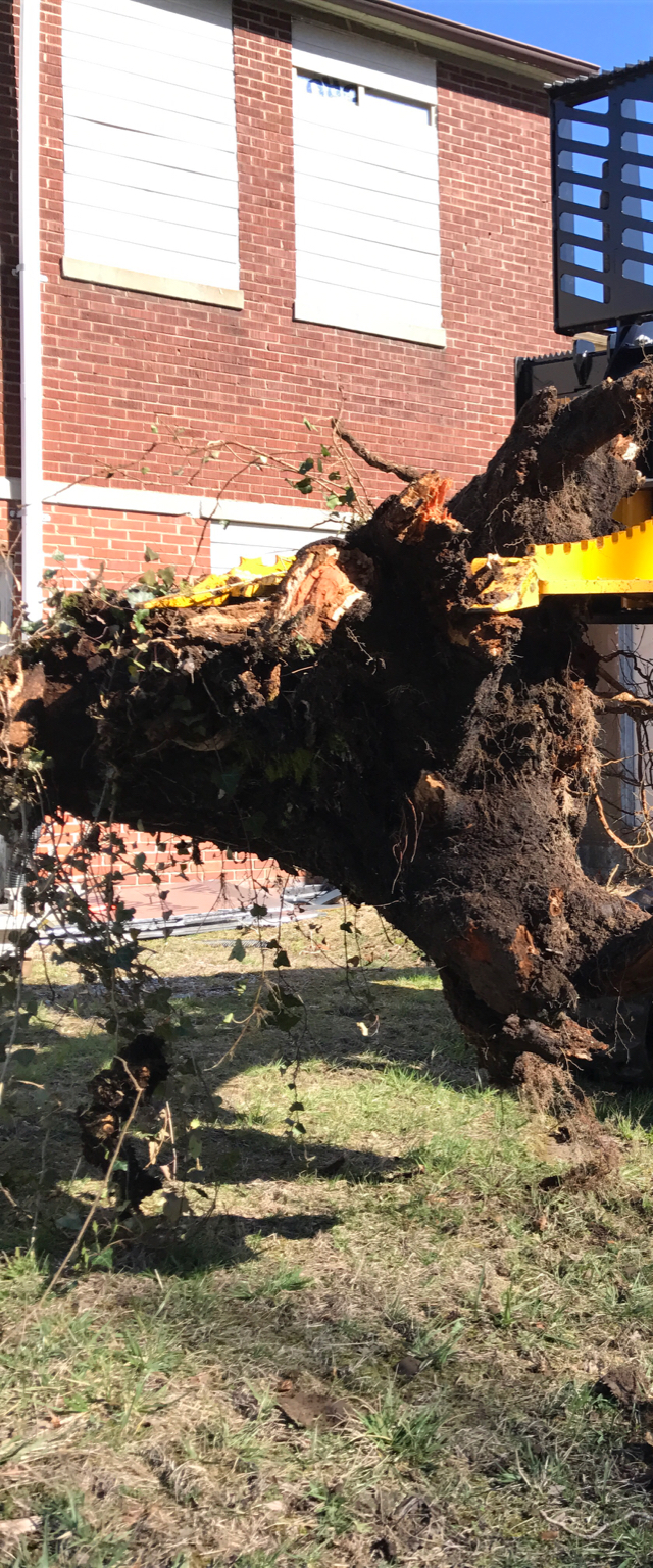

Looking at the design of the Notch, one issue I don't like is that it puts the center of pull towards the right of the FEL. If you have a 6" tree, you will be stressing the right arm along with torquing the arms, to a much greater degree than with the Intimidator. For me, given the stresses I place on the FEL as it is, I would not purchase the Notch unless I had things which were either not very large or not very 'tough' to pull.
I'm not knocking it... but I know how hard I've used mine, and I am glad that it is always centered and not torquing my FEL.
This might not turn out to be much, if you have light duty, but if you are 'getting busy', IMO this would be a deal breaker. That extra $1K up front is going to look pretty good compared to replacing a bent FEL arm.

It's difficult to tell, but the non operating pincer is offset slightly to the left so as to evenly center most diameters of tree trunk.
The people at Notch did a nice job engineering their puller.
/ Tree / Post Puller Type & Manufacturer? #57
Ahhh, OK. It doesn't appear thus from the pics. That's good.
