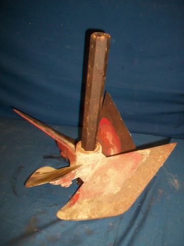

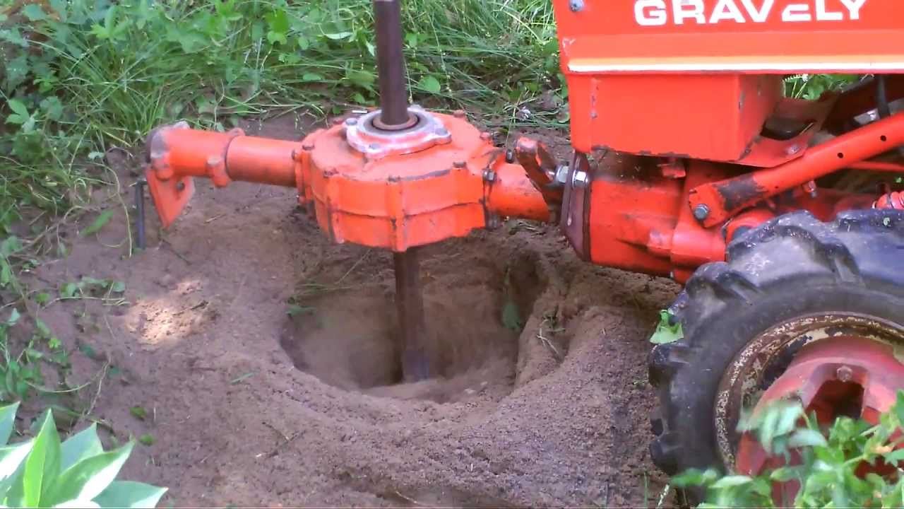

Three point post hole digger with a retrofitted Gravely rotary plow auger:

I use my Gravely walk behind with a sulky with the rotary plow pointed straight down to plant my saplings, it works perfect.
