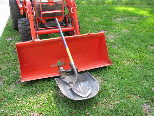

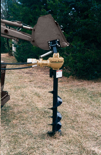

Could you bolt something to the side of your bucket? That way you could use the weight of the loader to provide down force, and it would be off to the side so you can see what is going on easier than in front of the bucket. Sort of like a lane shark how it bolts to a bucket.

I hate those one person and two person post hole augers only because of the potential to destroy ribs and arms. But if you could mount one to the side of the FEL bucket securely enough, it might work. You'd have to concoct a way to control the throttle and speed. Use the FEL for up and down. Don't know if they reverse though.

^^ Looks interesting but I can't find any pricing on it. Why list something for sale only to say 'Call for Price'?
Then again, I always have trouble figuring out where your post ends and the advertising begins.
/ tree planting auger #8
My guess is they're several, 3, 4 thousand. :( Call any land pride dealer and ask.

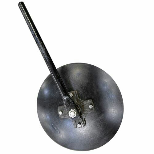

As a kid my Grandfather planted Christmas trees using a Farmall tractor and a single disk harrow, similar to this but larger diameter and mounted in center of tractor.
He made long rows about 10-15 ft. apart. He grew a variety of maybe four type trees.
We kids went along spacing trees maybe every 10 ft., it went pretty fast just flop soil over root ball, the trench held water.31752.jpeg
