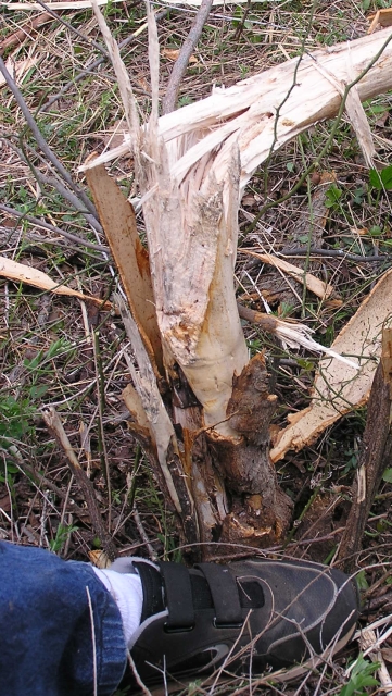

The picture with the shoe in it is to illustrate the size of trees I routinely cut with my Kubota Grand L4610HSTC. Decoded, that means a cab tractor with heat and air, 4WD, 39 PTO HP. The shoe in the picture is size 13 to give an idea of the size of the "brush" I cut. I cut up to this size by driving over them like mowing grass. Larger trees require a different technique.

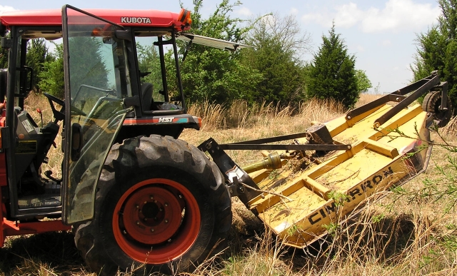

For larger trees and sometimes even for much smaller ones than pictured, I raise the brush hog with the hydraulic topping lift and back up to the tree or brush. Once I make good contact I then slowly lower the brush hog, "eating" the tree down to the preferred height.
I prefer to leave a stump at least 6-8 inches tall for small stuff and higher for the big stuff. This allows me to drive the tractor or my trucks over the cleared area with out puncturing a tire on the "punji sticks." When a tire contacts the taller-than-standard stumps they are pushed over harmlessly instead of poking a hole in the tire. I have been doing this successfully for hundreds of tractor hours.
Previously, not knowing any better I thought shorter was better for brush and I found that if I remove my wheel with the flat tire on it and use a winch to drag it onto my trailer and drive it 60 miles round trip I can have the flat fixed for $50 per episode (rear wheels.) I can get a front done locally for $10. I only ruined one good truck tire. It has been over 5 years since I poked a hole in a tire due I believer to cutting brush a bit higher.
Lots of the plants cut off 8-10 above ground die, the trunks rot off at or below ground and next year they just fall over when you run over them with the brush hog. Sometimes they put up shoots and try to recover. These can be mowed again the second year (depriving them of solar panels a second consecutive year - solar panels are leaves, without which the plants don't do very well.)
Also depicted in the accompanying pix is a shot of the Cimarron brush hog. It is a 6 ft HD model. If I recall correctly it is rated for at least 80 PTO HP (more I think.) It has a slip clutch, NOT shear bolts for self protection. By using a brush hog designed for over twice the PTO HP I have and with the slip clutch, it is unlikely that I can easily break it. I have broken blades (they are 4 inches wide and 1/2 inch thick and I distorted the mower around the edges and welded on reinforcement. The braces on the deck are channel not bar or angle.

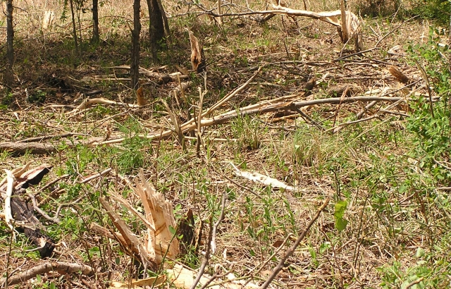

One of the pix shows an area after mowing it and the picture with the cute little BBQ's to be shows the motivation for removing trees and brush to get more grass so the little fellers (so far 6 steers and 1 heifer but more coming soon if the "Girlz" stay on task) have more graze.

:eek: Those aren't work shoes :p
Right again! Of course driving a cab tractor is not all that foot endangering. Oh, and for what it is worth... Do not be too hasty to judge footwear. I have a catalog with ANSI approved steel toed tennis shoes that look a lot like what I was wearing. (Although those were Wal*Mart $9.99 with velcro instead of laces.)

I enjoyed reading how you go about operating that beast ! That bush hog is for sure a real heavy duty unit, I can see that just with the picture you posted !

Scott, No problem with tires since I leave the "stumps" around 8-10 inches tall. The stumps (AKA punji sticks) get pushed over (they usually spring back) instead of skewering a tire. I drive over everything but the really large ones with front or rear tractor tires with impunity. Likewise my trucks.
Before someone wised me up I cut things as close as I knew how (haven't tried the suggested method revealed to me a few posts up thread.) I got two each $50 rear tire flats and one in front ($10) on different days. I had to walk to the house (1/2 mile plus), get a jack and a big board to go under the jack, take the truck with winch with the trailer too. I then jack up the side of the tractor and remove the wheel. I drop off the trailer and put the truck around in front of the trailer head to head (I have front receivers on the truck next to the winch) attach the winch cable to the wheel and winch it up the ramps onto the trailer then rehitch the trailer for towing, to drive a 60 mile round trip to pay $50 for them to fix the flat.
Needless to say I am very pleased with the lack of tire problems when the brush is left 8-10-12 inches high. Much of it dies and next year it breaks off at or below ground when run over or mowed. Some of it resprouts and is a candidate for spot spraying or re mowing. I might get a slightly better kill if I mowed close but tire damage concerns loom large on my priority list. Maybe I can employ the technique given to me in an earlier post and cut, at least the smaller stuff, too short to damage tires.
The biggest stuff I cut is considerably larger in sopme instances just as the trunk gets close to the ground and it wild be much much stiffer close to the ground. Cutting at 10-12 inches on the big stuff is more forgiving, I think.
