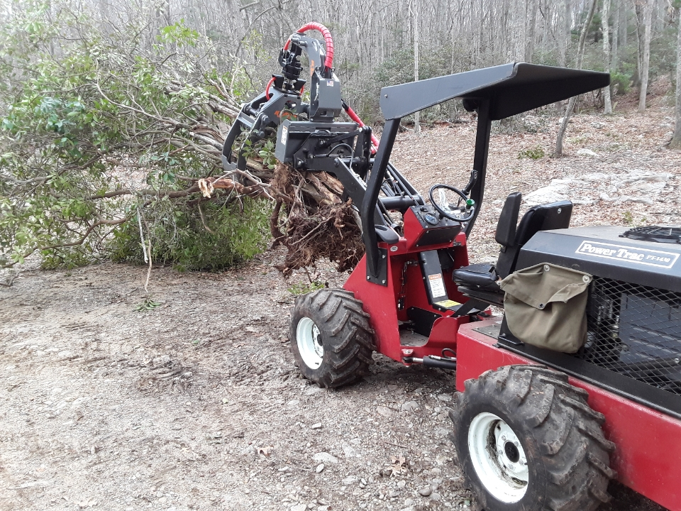

I bought a Ryans 4252 log grapple to use on both my 1430 and 1460 (I think log grapples have teeth near the attachment to the tractor, so you can jam the large end of a tree and pick it up off the ground, just my observation). I got one size up from the smallest because of the 1460 capacity. It works great. With the hyd rotator I can approach from any angle and pick up and move to a pile where I can place it to match directions for a larger grab once the pile gets big enough. I also can carry very long trees out like a crane-boom (20'+ long, whatever the tractor will lift) through narrow areas where the rotator can turn the tree to follow the path before the tractor gets there. That guy did a great job with a selfcentering grapple but I don't think I would have the patients.
John, how do you rotate and clamp the grapple with only having one auxiliary for the hydraulics?
/ Tree Grapple #19
The Rayan's grapple comes with it's own diverter valve. You just need to supply 12 volt electrics to actuate it and then it switches from grapple open/close to rotate.
I installed a diverter valve on my tractor's hoist circuit (I only use the original aux circuit to work the quick coupler, so far anyway).
Then I bought a multi function joy stick handle with 3 elect circuits (only use 2 so far). When I pull the trigger the diverter valve I installed changes from hoist up/down to feed my aux circuit, in this case it is grapple open/close.
Then I wire the thumb push button to actuate both my diverter and the Ryans diverter which changes from hoist up/down to grapple rotate.
If you go this route, I can look up my notes on the wiring circuit as you need 3 relays to make it work. As best as I could figure out anyway.
Wow! That’s an awesome setup! I seen your push button joystick and was thinking you had something like that. That’s cool.
