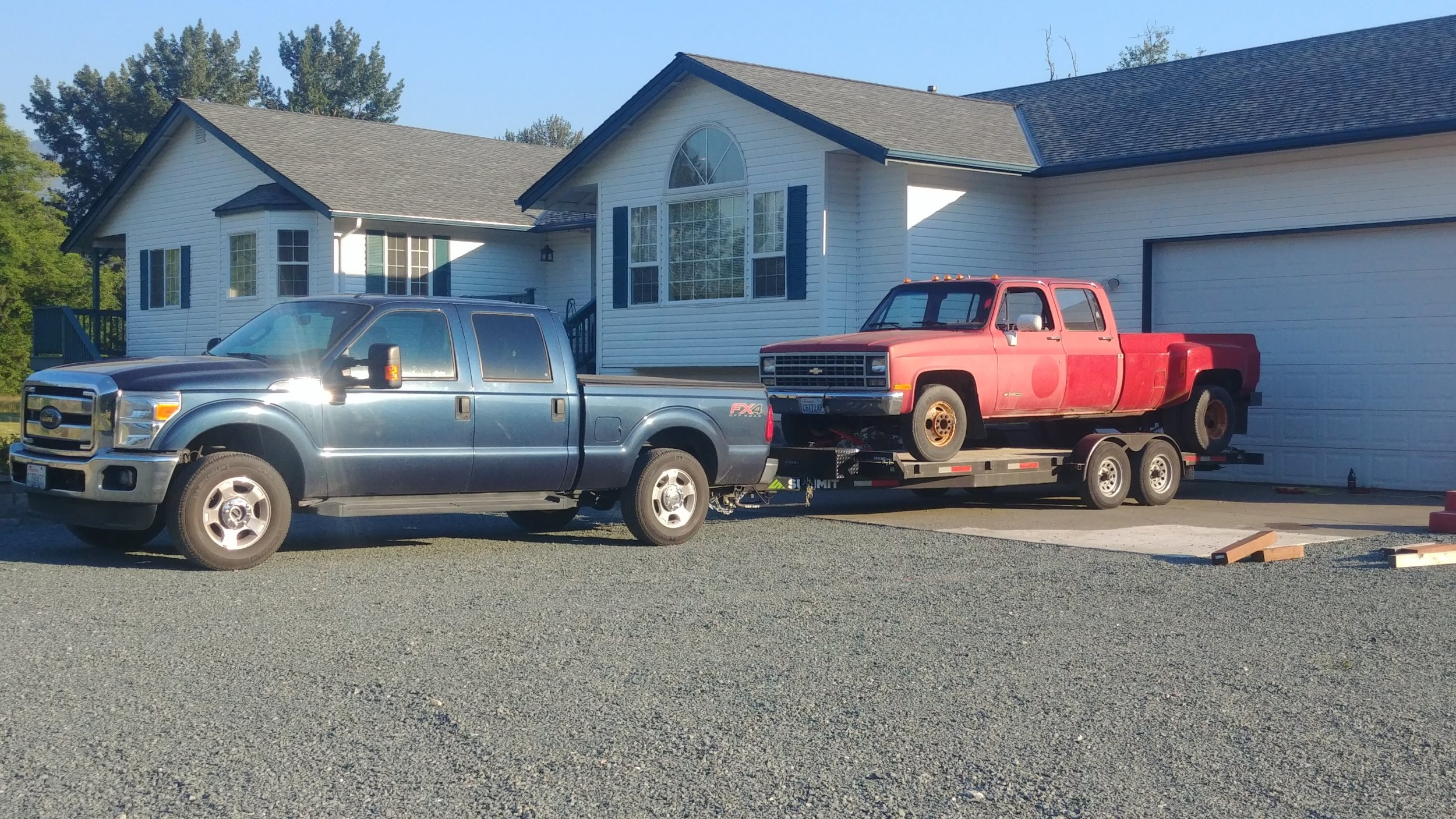

I hauled a one ton dually over here from Puget Sound and I had to cross chain it which worked out well for me. I had no one to guide me when I loaded it, so I used the cross ratchet binders to pull the truck sideways to center it.

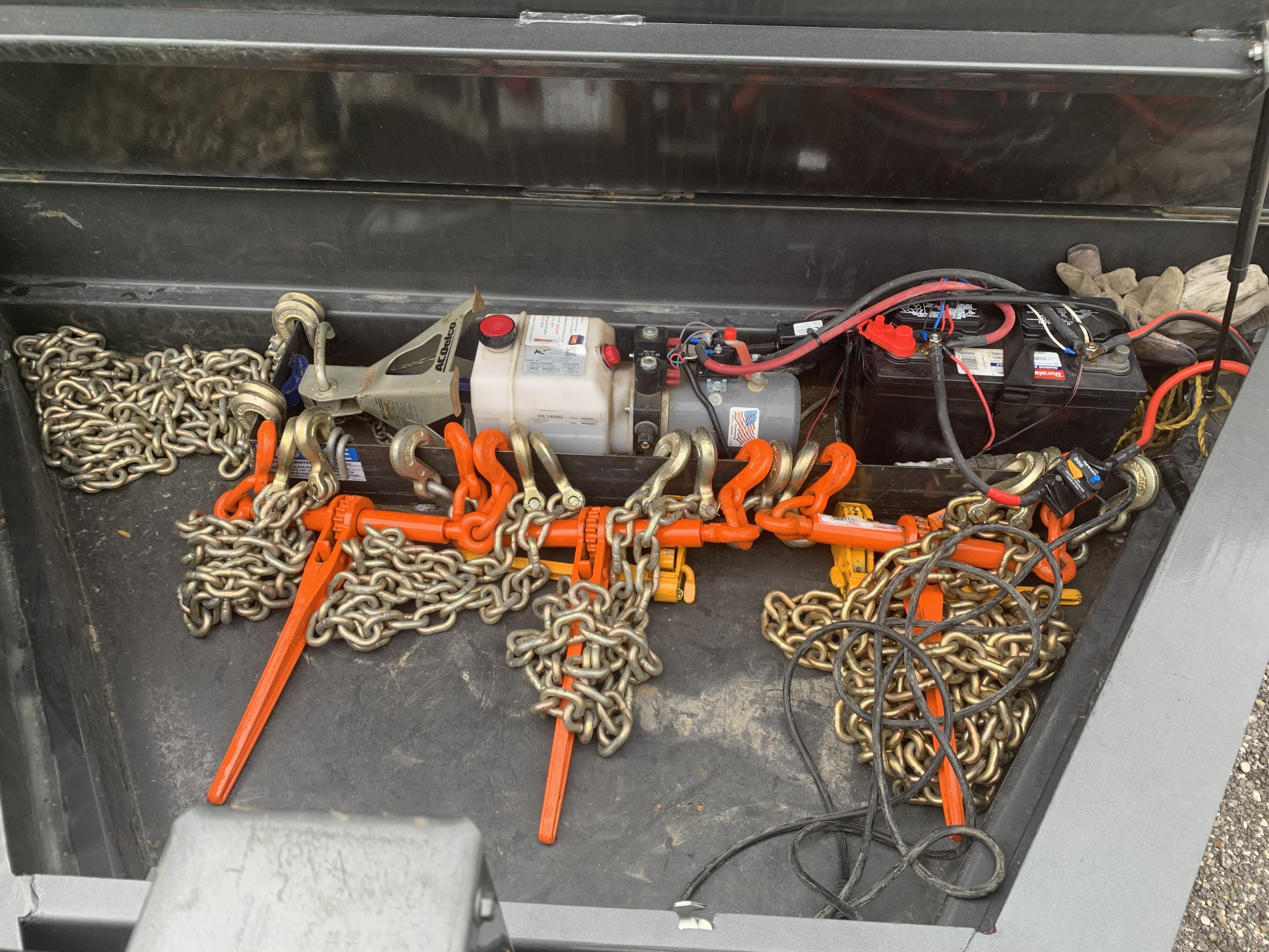

Here is how I have my chains and binders set up:

Mine aren't as neat and tidy, but in a bucket within the toolbox of my trailer. Keeping the chains and binders under cover keeps them so much cleaner and less rusty.
