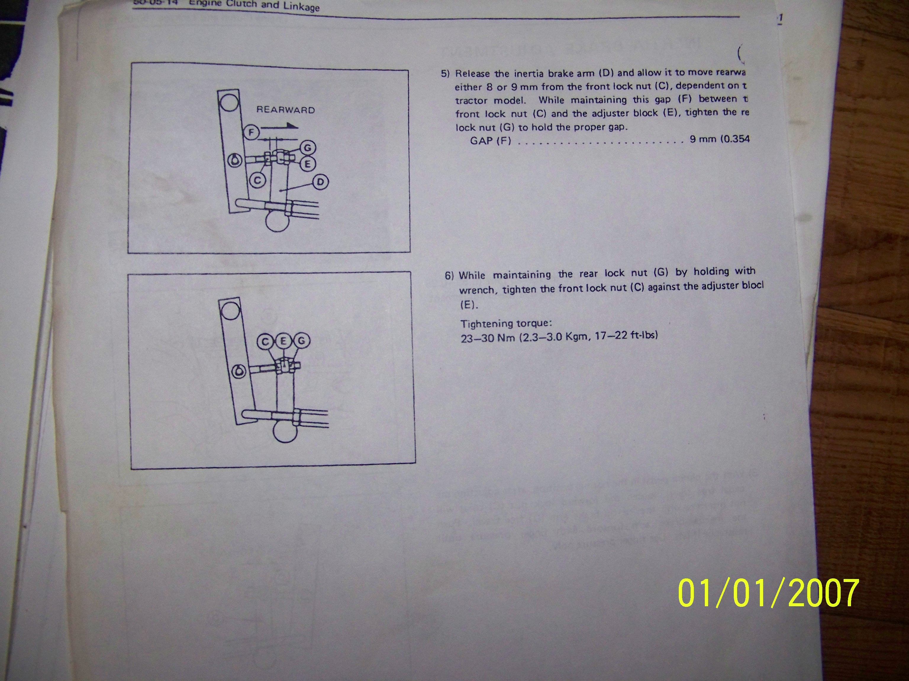

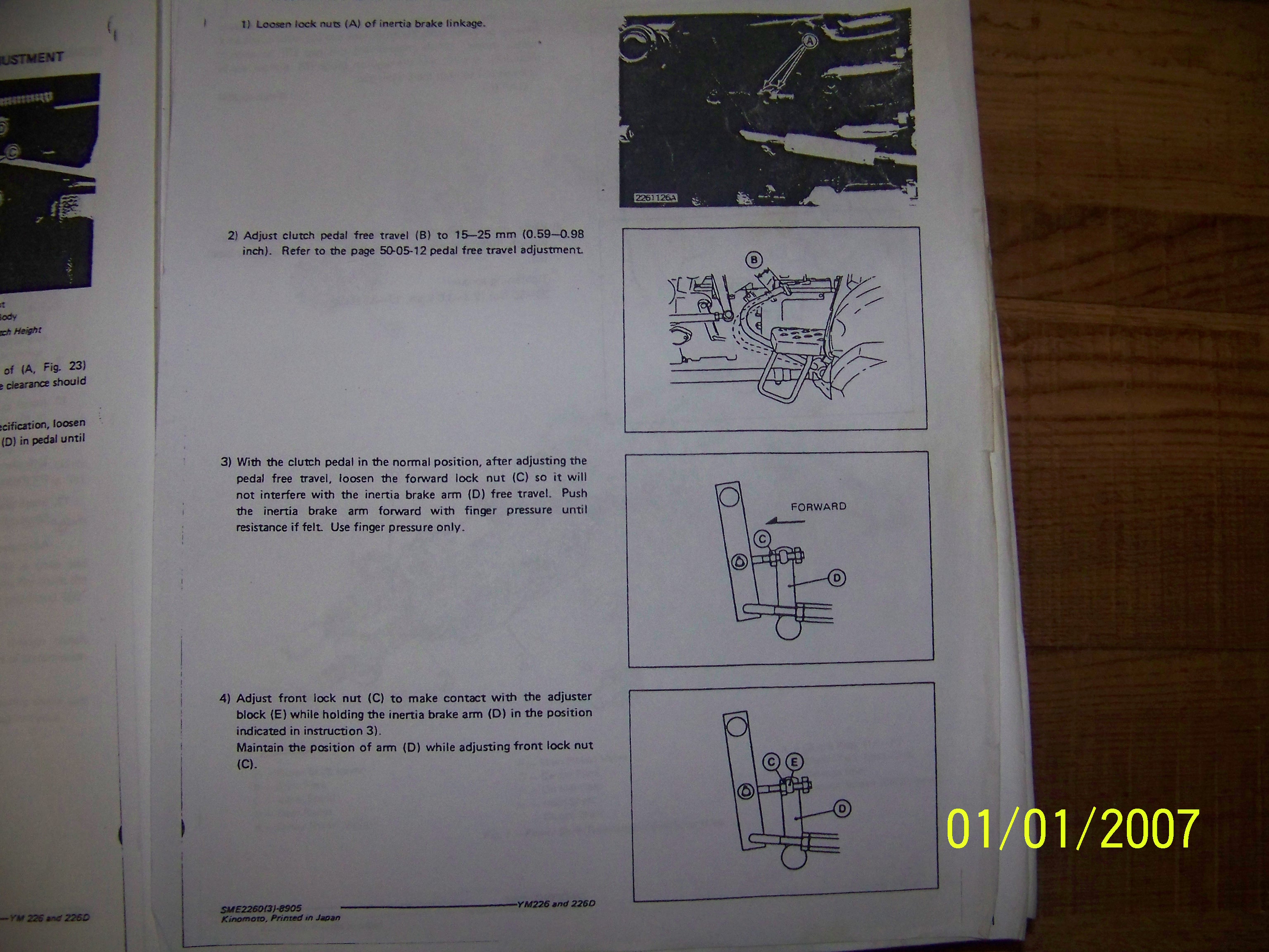

no this is what i was talking about.. large is throw out bearing...
the small turns with no resistance
Called the inertia brake. Adjustment procedure out of 226 manual.
thanks
but the problem is "push till resistance is felt" i have no resistance
what exactly does it do?

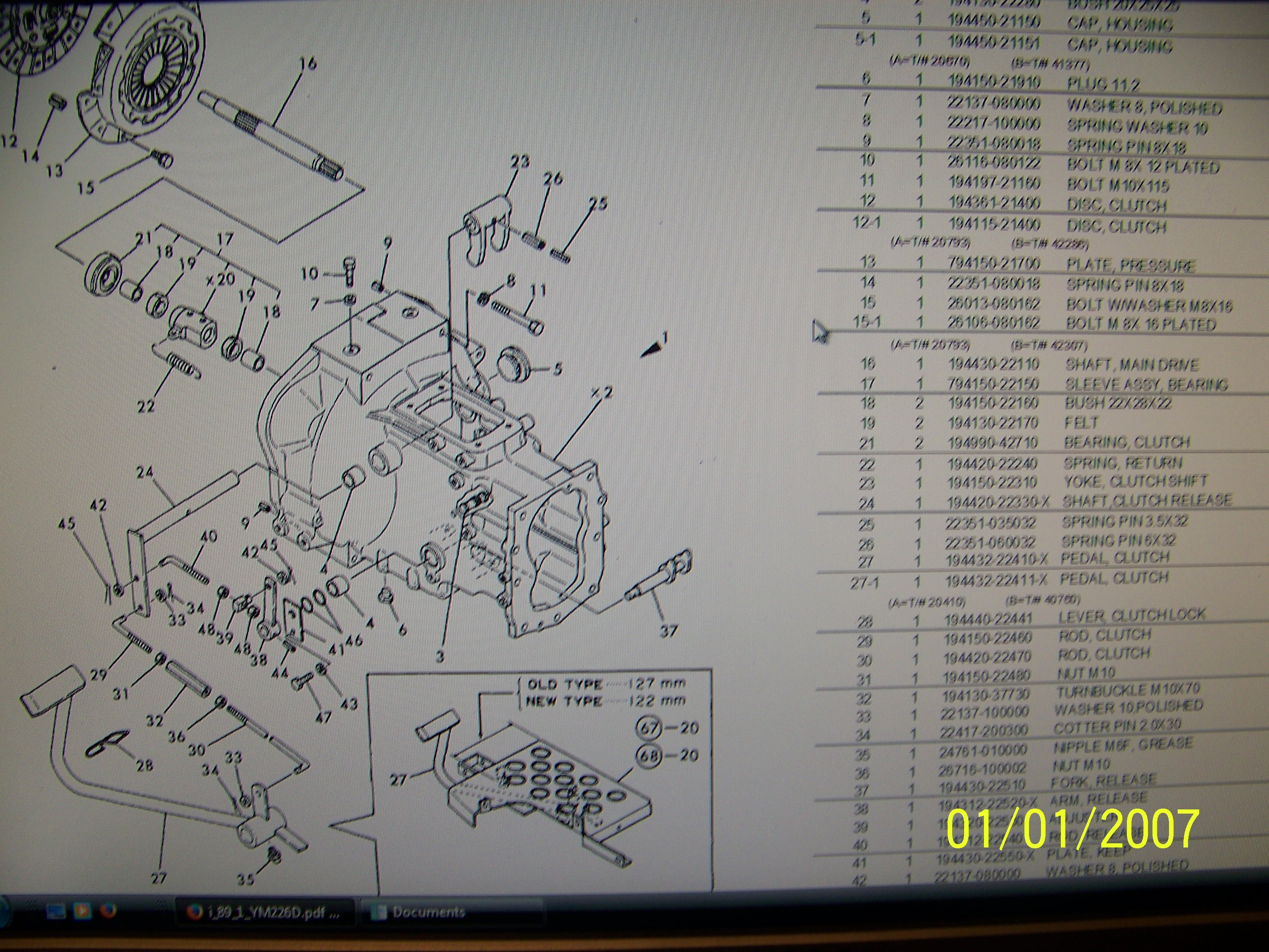

It pushes against the inertia brake which is located on the end of the power shift clutch shaft. Reference D on this drawing. That protrudes into the clutch housing.
Reference #37 is the release fork connected to clutch pedal.
