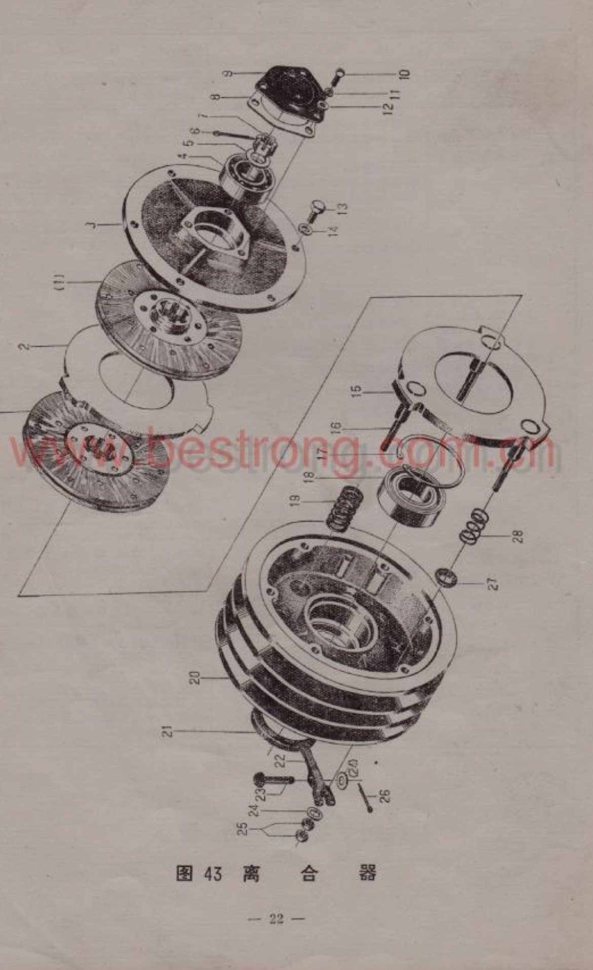

Break down of the clutch.
Good afternoon; I purchased a 2024 traner tr45 and when first driving it - it ran fine was looking at posts here and filled up the oils as instructed in videos however now it will not move when running in gear. do you know anything that would make this happen with this tractor? looking for answers about how to get it moving now that I put the oil in it. also put in grease erks and changed motor oil filled up the hydro. oil but now it will not move starts fine just will not move. Any help is greatly appreciated

Good afternoon; so I purchased a 2024 trainer tr45 and filled all the oils on transmission and diffs. did you fill the transmission oil all the way? I had to go thru the top cap to fill however no way to tell how full it is as no dip stick for it. also after filling all fluids it now will not move it starts fine but will not move when letting out on clutch and putting it in gear any suggestions?

Hi there, sounds like I have the same issue with mine. I just picked it up at auction and ran it just fine for about an hour. Put it in 3rd gear and ran it for a few seconds before shifting it back to 1st and now it won’t drive. It has perhaps 1% power now. Enough to roll it forward or backward a few inches but that’s all.
Hoping someone here has some suggestions.
   / Traner TR45/ FLand FR45 #28
same here it ran really good for about a hour and then it started acting like it had no power I checked all the oils and fluids put filled them all put in grease erks, changed the oil new oil filter. adjusted the clutch filled the front end and back differencials with 80 w 90 oil. I am going to tear into it here soon cant today have other things going on but if I find anything I will post what I find on here. Hopefully didnt burn up and thing. At the moment it is up on blocks and when starting and running I can stop the tires movement with my hand at full bore.

Sounds like the Clutch is Stuck, Slipping.
