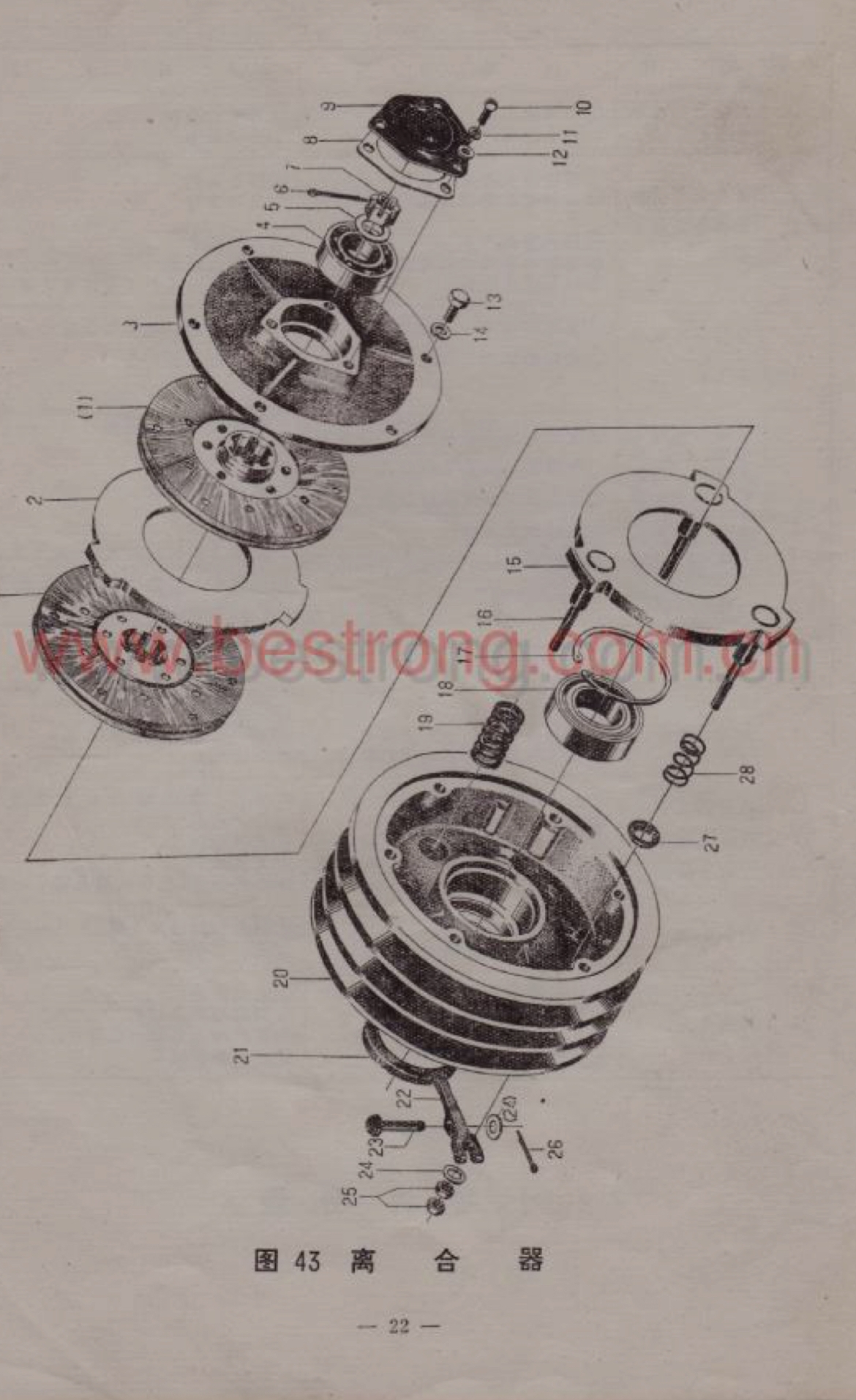

Break down of the clutch.

Hello,
I recently purchased a Traner TR45 and the clutch is not working properly. Any one has an idea on how to adjust the clutch?

Hello,
Make sure the clutch is engaging. Some owners have had the clutch sticking. Go to YouTube. I posted a video. Another guy has posted one also. Break out the wd40 for a quick fix.

I bought one. Can’t find a manual anywhere. Make sure you go over all the bolts and fittings. Most of them were loose. I still need to adjust the clutch. Anyone else have one so we can pick each others brains. Thanks Bob
I bought one. After 20ish hours the clutch release bearing went and I'm currently ordering. One showed up and the numbers wrong. Maybe I can return
