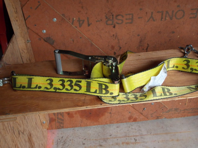

I use two of these ratchet straps when I trailer my Kubotas. I'll been on the interstate with the BX-25 and never got stopped. So I must be doing something right.

If my Kubota can break one of these straps, then it must be from the Planet Krypton!

My straps were 10k or 15k lbs rated holding down a under 4k lbs tractor. The issue isn't the weight. The issue is metal corners starting to cut through the straps. You can see the strap going over the bumper/brush guard above. At both corners where the strap went over the corner it cut & frayed a significant amount. Those corners were not sharp in the slightest either, I couldn't cut my self on the unless I punched them or something. Welding on D-rings so the strap runs from the tractor to the trailer & can't chafe on anything would work just fine I expect, but I went with the flexibility of chain instead.

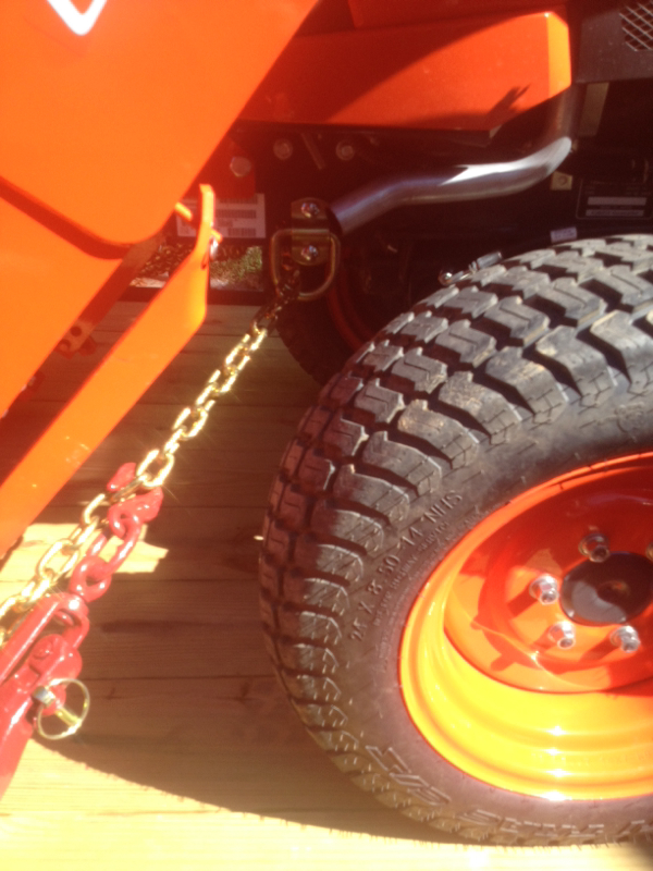

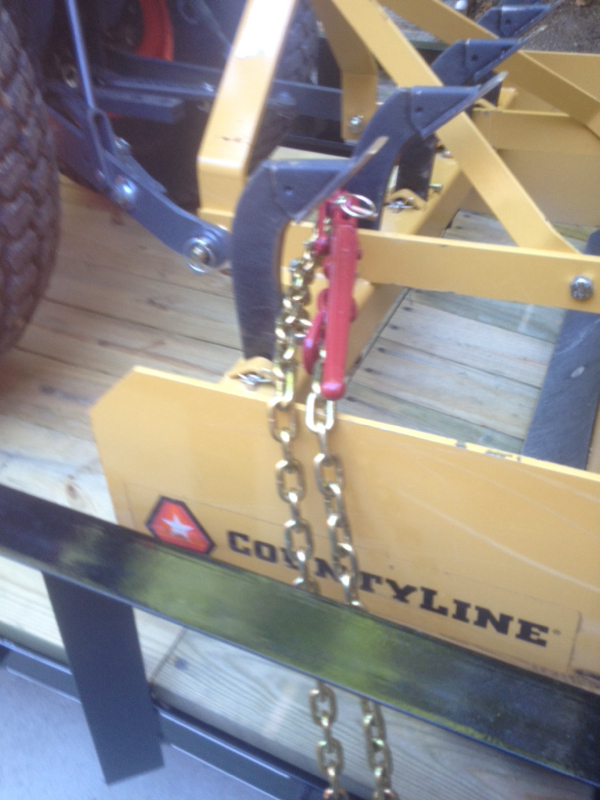

I added two bolt-on d-rings to the frame of the tractor and ran my front chain through each. The chain doesn't hit or rub against anything but the d-ring.
I suspect I should strap down the loader too? On the back I looped my chain around the box blade from the back to the front. This looks like it'll work. I may add a ring to the hitch bar later.

From what I understand according to DOT regs, you need to strap down the loader too. Probably excessive, but easier than having a problem or a ticket.
With my bucket sitting over the tongue beam I just go over the center of the bucket & around the beam.
