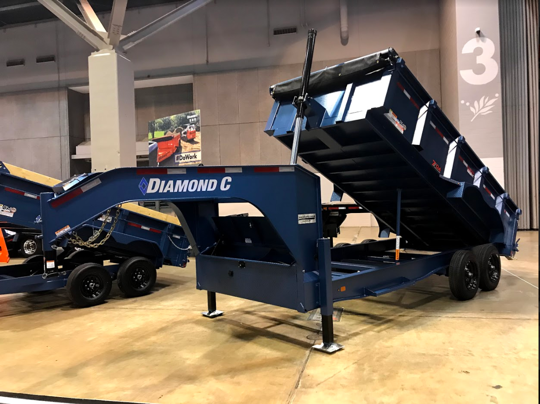

By telescoping you mean an extending cylinder like this and not a hoist like this trailer right? They’ve both been around since about the invention of hydraulics so I don’t see scrapping either one in the next 5 years. Honestly I think the hoist is the better way because it leaves the inside of the bed unobstructed and works in flat beds.

Most dump trailers have the cylinder mounted outside the bed, not like a dump truck. They are super powerful but really slow, especially the first stage since it is the biggest, as the stages go smaller it goes faster. It is powerful because at the most it lifts half the load, the others lift most if not all the load depending on where the builder installs the hoist. Also, the scissors hoist are not all created equal, you have to watch out for that. Some only have a channel iron for the bottom joint, rather than a square tube, some are massive like my Lamar.

Heres a load trail telescoping hoist

Piss poor design with the cylinder extending above the top of the front panel.
Telescoping cylinders will not take over the industry that way.

That’s what I thought. They’ll get bent. My 1990 truck has a telescoping cylinder and I’m sure they existed before that. I’ve got a forklift from the 50s with one on it. They’re nothing new.
