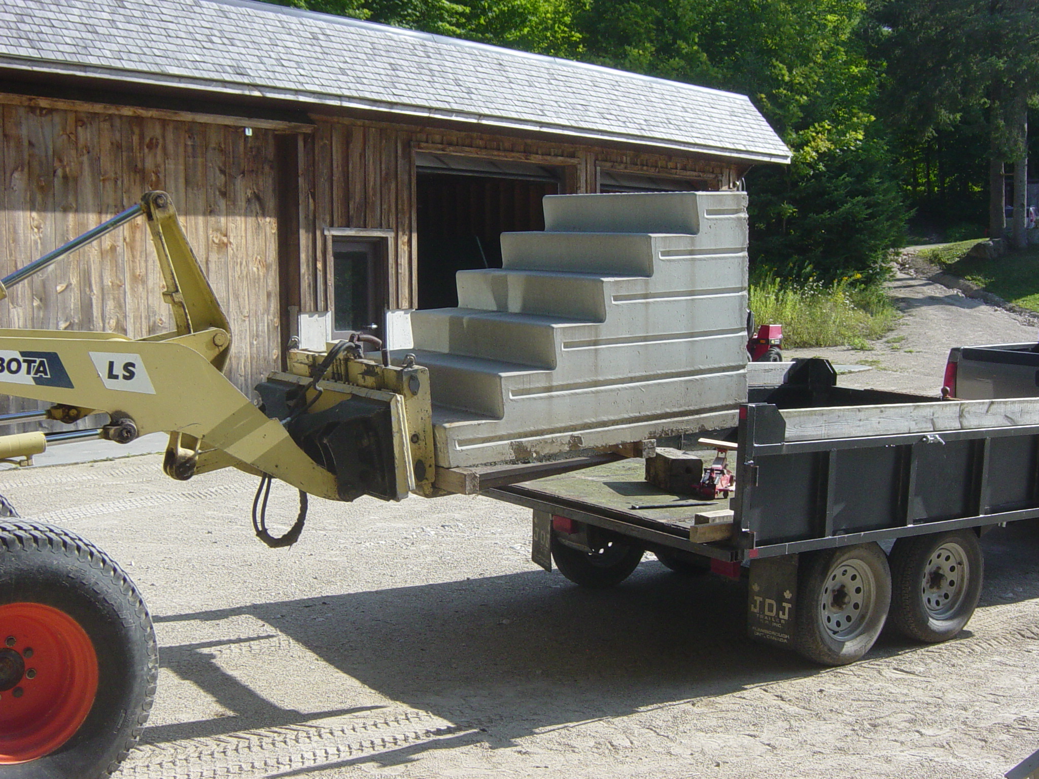

I got a very cheap $500.00 deck over dump trailer from a buddy. He fixed it up and then found one conventional one, he liked better.
The wide box is nice. I was at the gravel pit a week or so ago and the 3 or so yard loader had no issue dumping material into this trailer.
The BIGGEST issue I seem to have is just the GOOFY look of the thing.
DSC00049b.JPG I don't have a lot of pictures of this abonination. The width does come in handy.

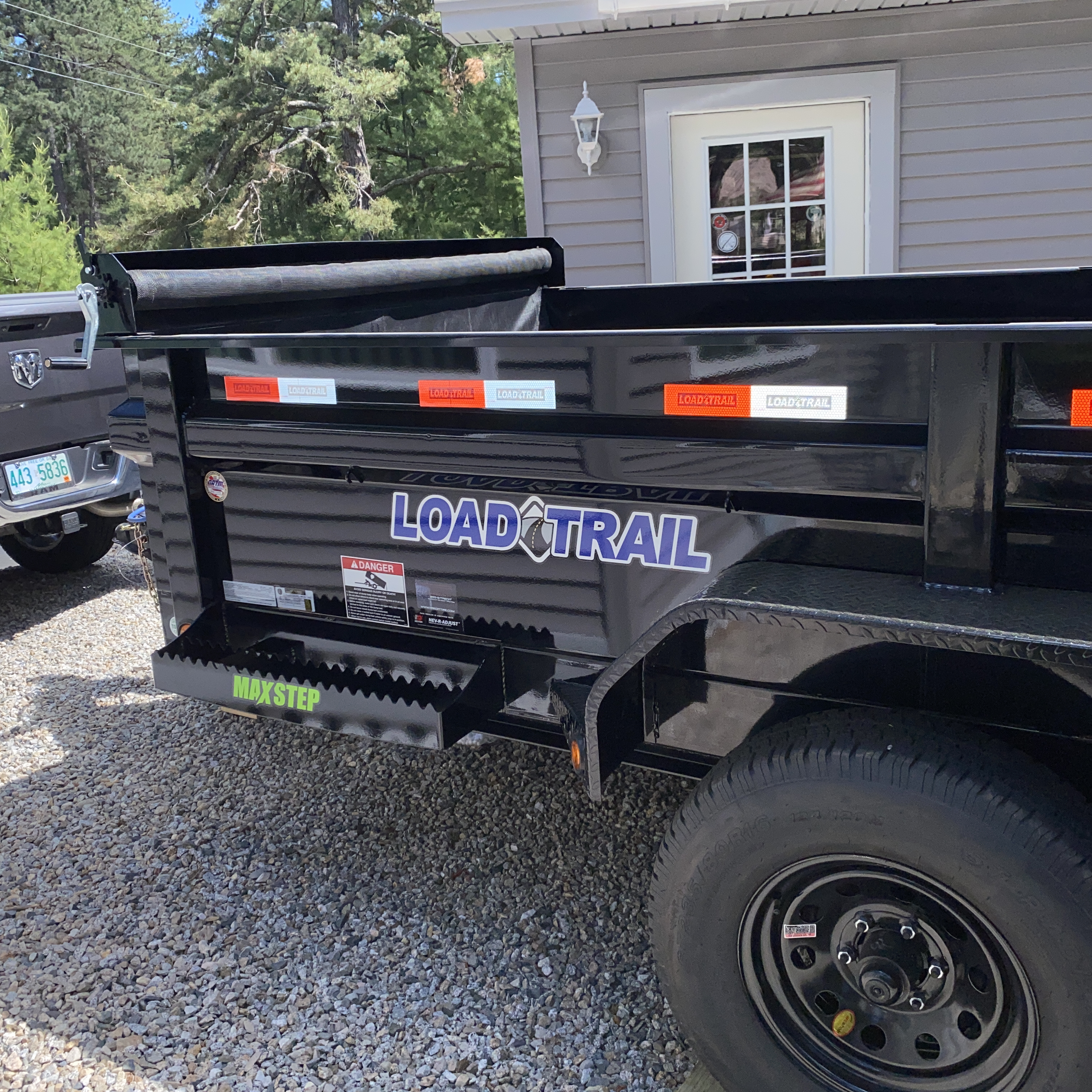

B0E2DDCC-0196-4698-B227-BFACDDAA988A.jpegThe problem with a Deckover is the height - some equipment will have clearance issues - you can load with a ½" on each side - issue will be tie down if it's tight I normally set / secure the axle straps on the tractor prior to loading, I had a step put on the left side of the trailer so I can get into the bed on one side, on the right I step on the chock blocks - but I'm 6'5, so I can reach it, tractors are normally narrower in the front so again I can get to the front from the right step - the other issue is getting off the tractor can't go by the tires, the front step works - obviously the rear is not an issue, with the doors open easily tied down.
