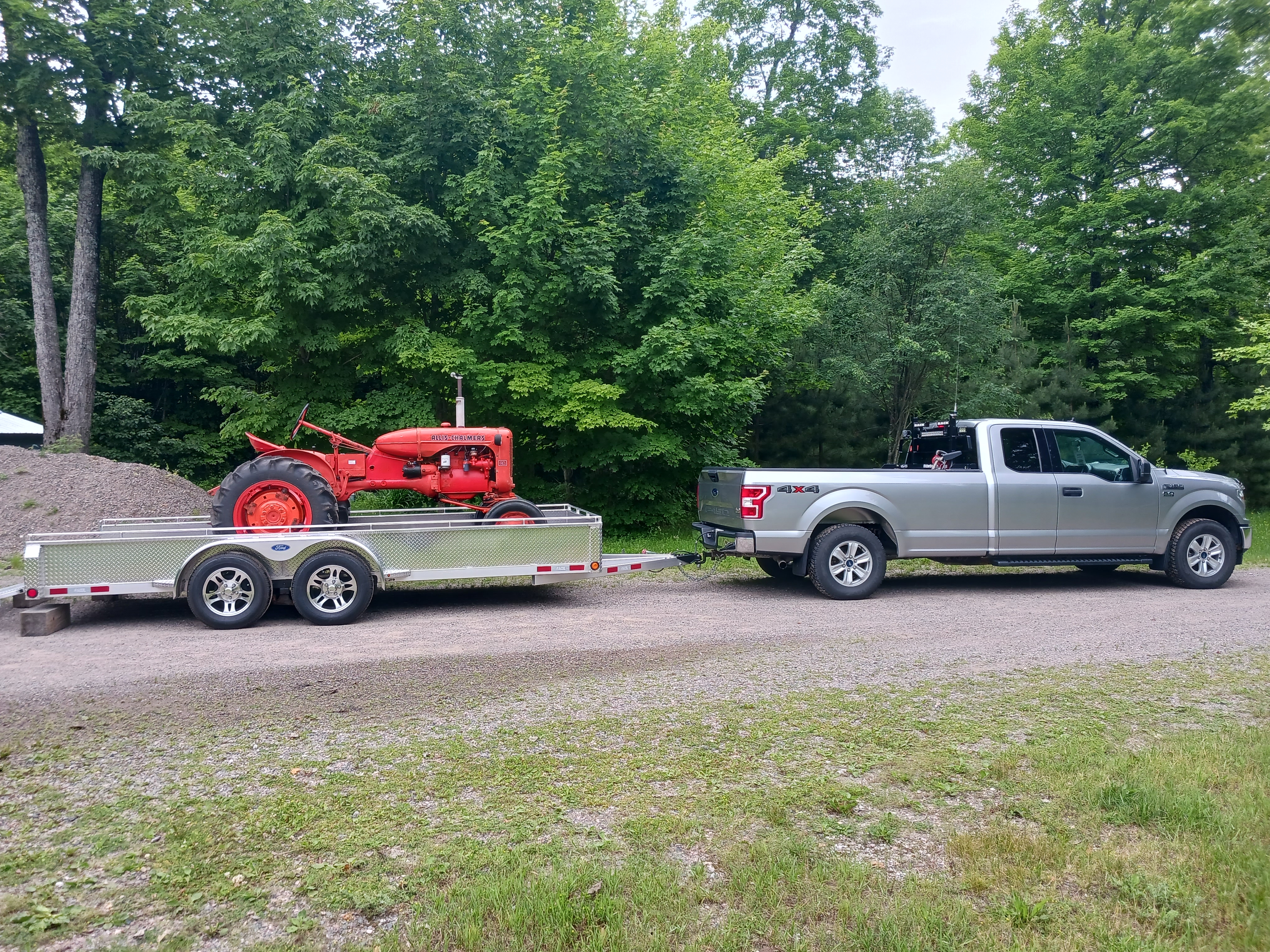

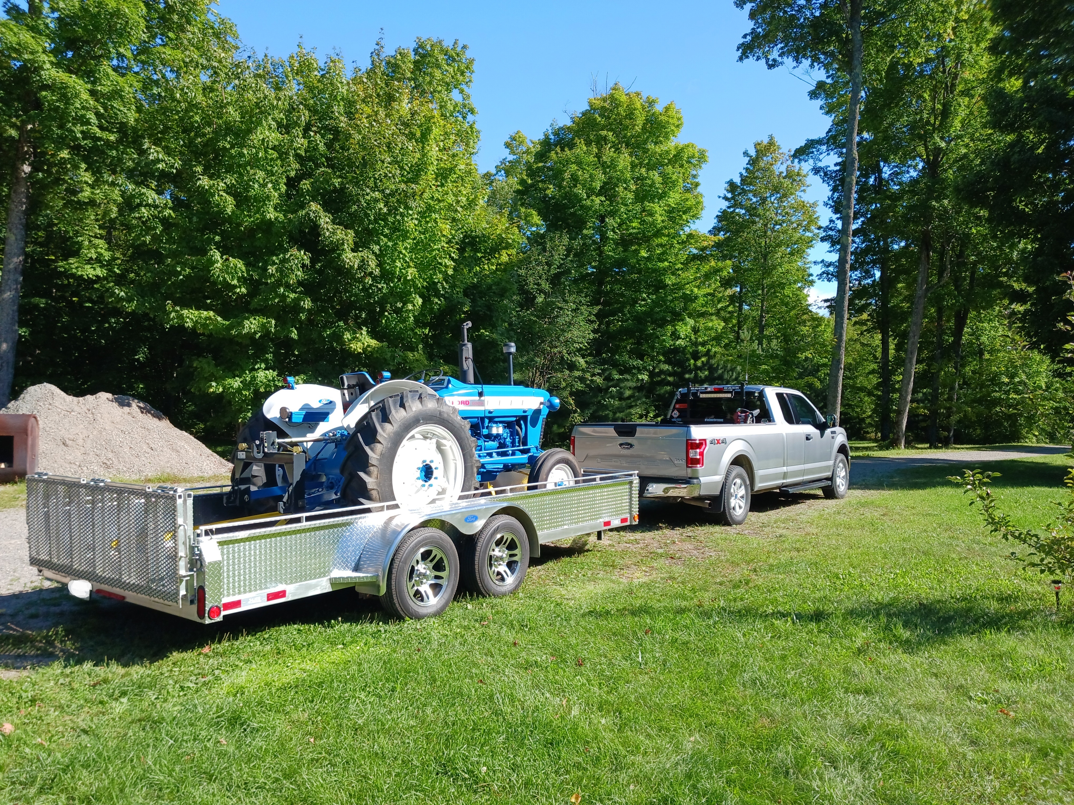

This summer I had the chance to go axle weigh two of my tractors on the way to a parade. I always loaded them with the rear tires centered between the trailer axles because I had extra crossmembers added under this trailer. So in this spot the rear tires are sitting on 3 square tube cross members and the front tires are on a cross member.
