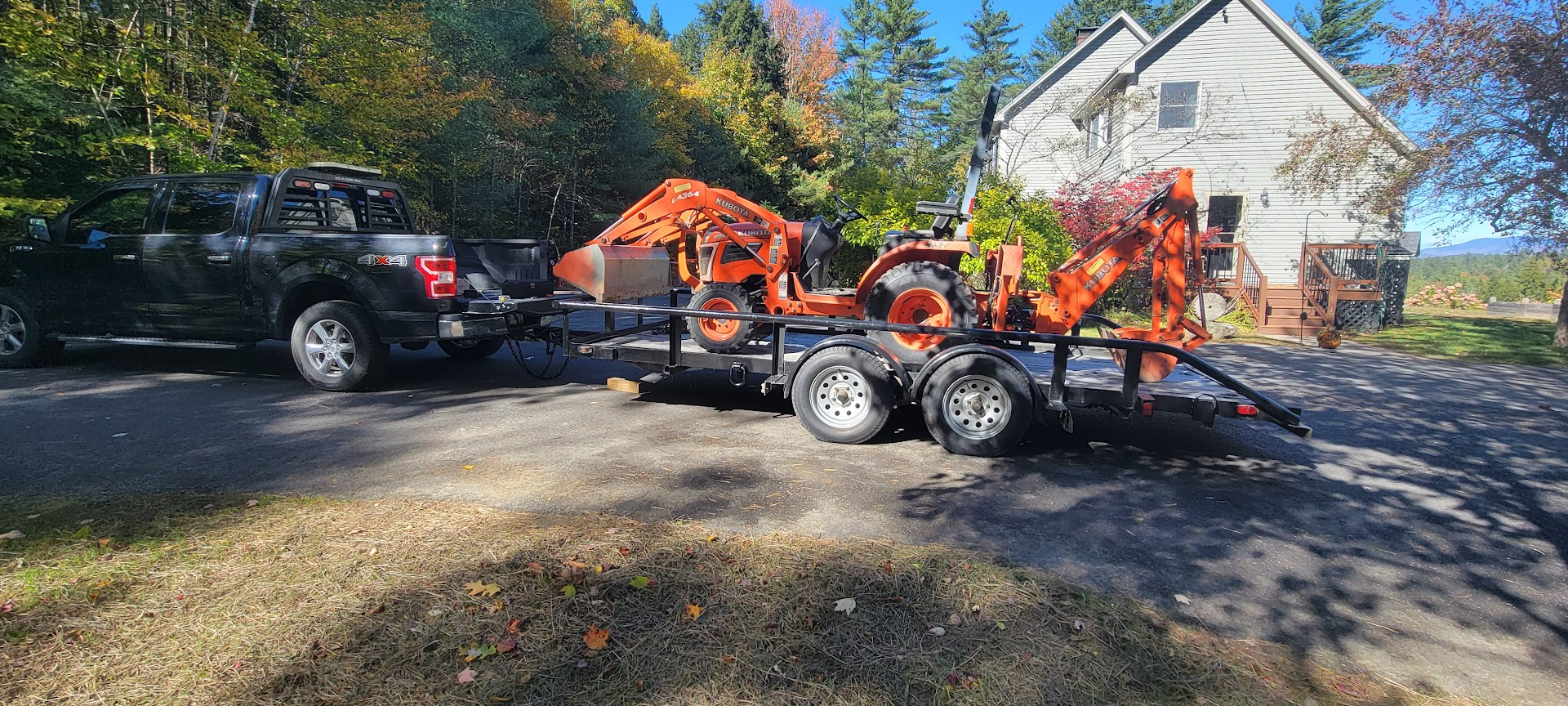

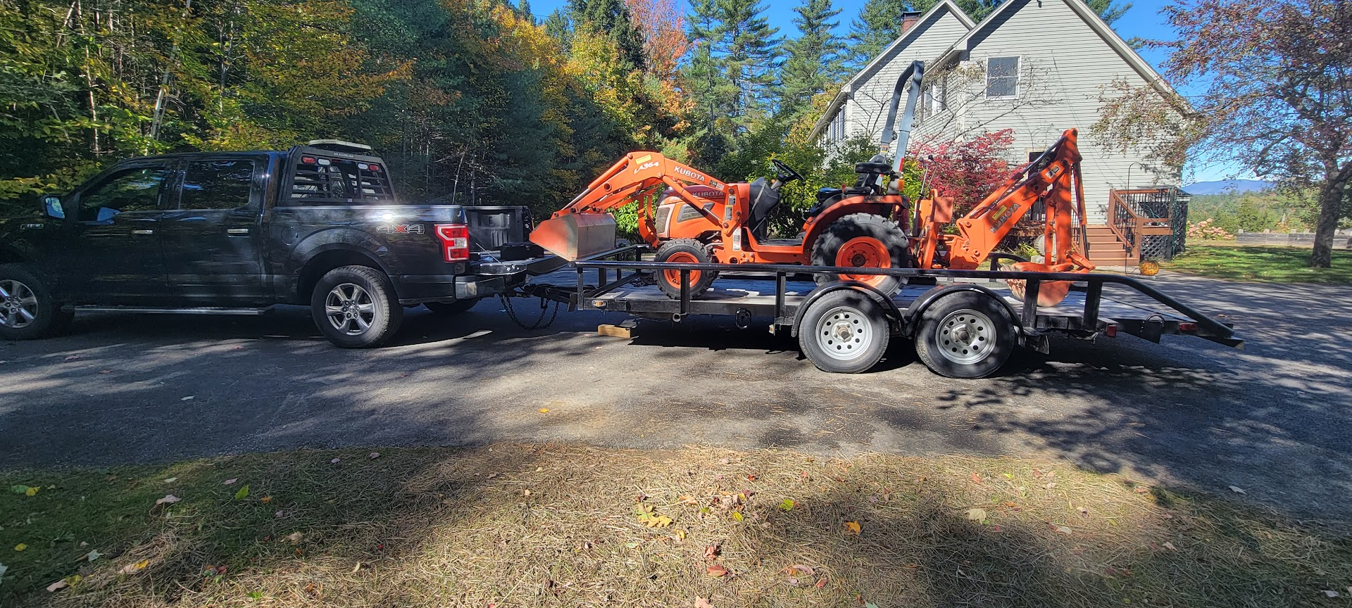

I have never towed this tractor on this trailer.
I measured from ground level to the top of the rear wheel well and got 39" with the unloaded trailer attached.
With the tractor backed onto on the trailer the measurement is 38".
If the tractor is driven up onto the trailer, bucket first, and the rear wheels centered between the trailer axles then the bucket extends over into the truck bed.
In photo #2 The tractor is driven on with the bucket just behind the trailer tube and the measurement is 38"
Photo #3 The tractor is a bit further ahead with the bucket just passed the front tube and the measurement is 37 1/2"
So my question is I need some experience opinions considering safety first and then determining proper tongue weight.
From what I see, the last two photos will most likely cost you a tailgate if you have to back the trailer into a tighter space. Just something else to consider.

Since I didn't give and opinion on the actual trailer loading proposals, I vote for number 1. It all fits inside the trailer, would be easiest to tie down and doesn't seem to be too unevenly loaded.
What I don't like about numbers 2 and 3 is that it would be hard to secure the loader bucket to the trailer (which, at least in my state is required) and even if you could, as the hydraulics bleed down, it would be constantly loosening the straps or chains and then the loader bucket is moving around.

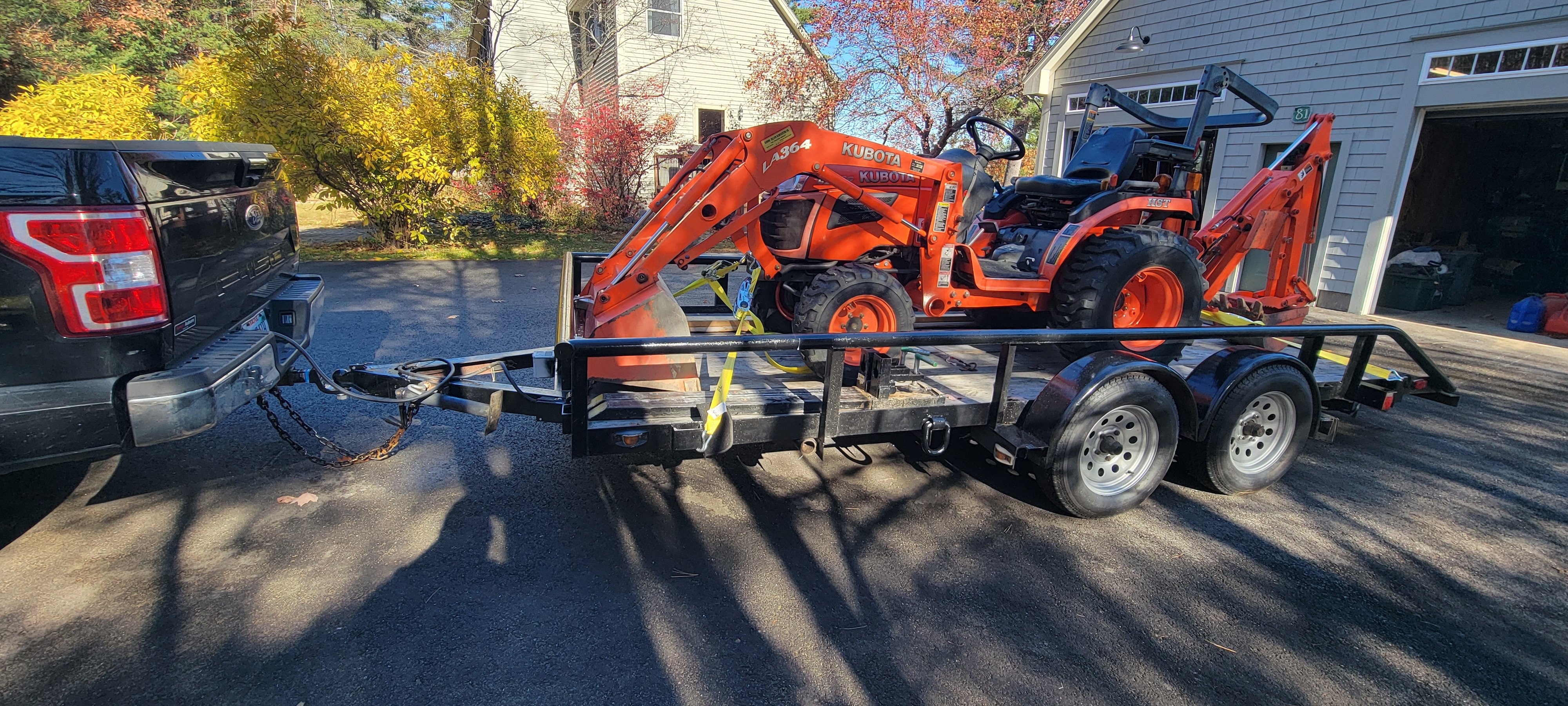

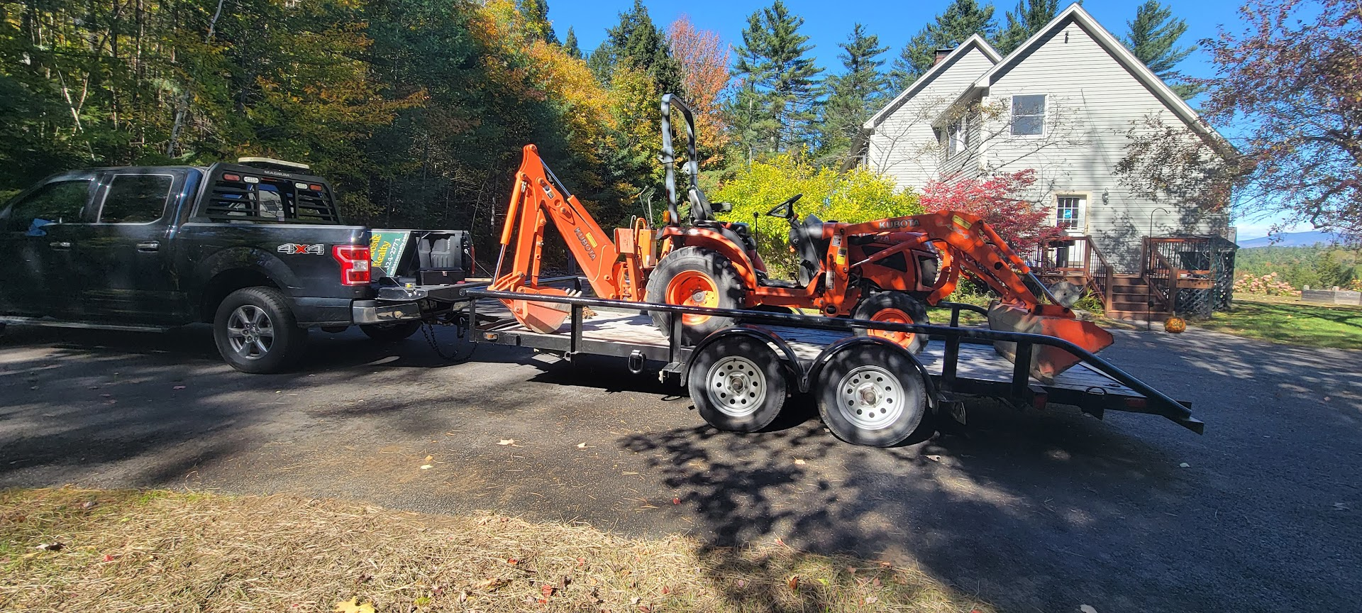

I have a Kubota B3030 with loaded tires and an 18' utility trailer with a beaver tail. I haul the tractor like picture 2 with either my BH80X BH or the Woods Brush Bull. The loaded tires go between the trailer axles, balancing the load of the tractor to either the BH or mower. The drive-on ramps just clear enough to raise and stow.
I've seen a lot of equipment trailered, but I only recall professionals loading backward when they have two pieces of equipment facing each other.
Your bucket looks like it could be secured to your front trailer rail.
As for the bucket hitting the tail gate, lift the tailgate up and lock it. Mine would bind on the trailer jack handle if I left it open.
As for the bucket hitting the truck, if you jackknife it that badly, the front rail of the trailer will take out the taillights, even with nothing in the trailer (as my son so aptly taught me).

First check your door sticker to see the combined weight allowed.
I recommend backing it on to get more weight on the tongue. Be absolutely sure that the Trailer brakes are working. Get the rig weighed if possible. Block it and chain it down well, then add a couple more chains!

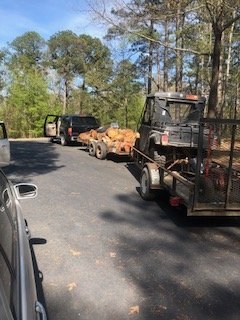

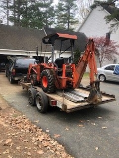

Been pulling trailers for over 55 years of all sizes and kinds.
Here of late most is with a double axle {6K lb each} 14' trailer I made for my asphalt business in '82 with my Kubota B20 and always pull it on -- never back it on.
Although I like "LittleBill21"'s comments, I don't recommend loading tail heavy and "take a ride. when it starts swaying at 45+ you will get it." as this could cause a blown tire, accident etc.
Most of the time I have a 5' Bush Hog on and it hangs 4' past the back of the trailer -- in AR that's legal -- but sometimes I'll have the Kubota BT750 Back Hoe on and lower to the deck.
The Bush Hog and Back Hoe are about the same weight as the motor and front end of the tractor and therefore balance the weight producing a tongue heavy load.
I also keep the loader bucket on the trailer against the front of the trailer as I don't really like it over the front unless I'm pulling another trailer behind the loaded one -- I also do this quite a bit.
You might also consider a "leveling hitch" and/or air bags for your tow vehicle.
I'll try and find a couple of pictures.

I think you have more tongue weight with it backed on than you think.
It looks like your truck is a 1/2 ton so you may want to weigh it and see what you have.
I have too much tongue weight with my tractor backed in the attached picture with my 2500 truck, but not if I pull it on. That said it tows great either way.
This really depends on the size of the tractor and implements your hauling.
My Grey market L1501 fit and hauled best when backed on. I could drop the bush hog wheel on the chain box, and the loader even with the tailgate.
It ran nice and smooth down the road.
My trailer 16ft.
I really need a longer trailer for my Massey
