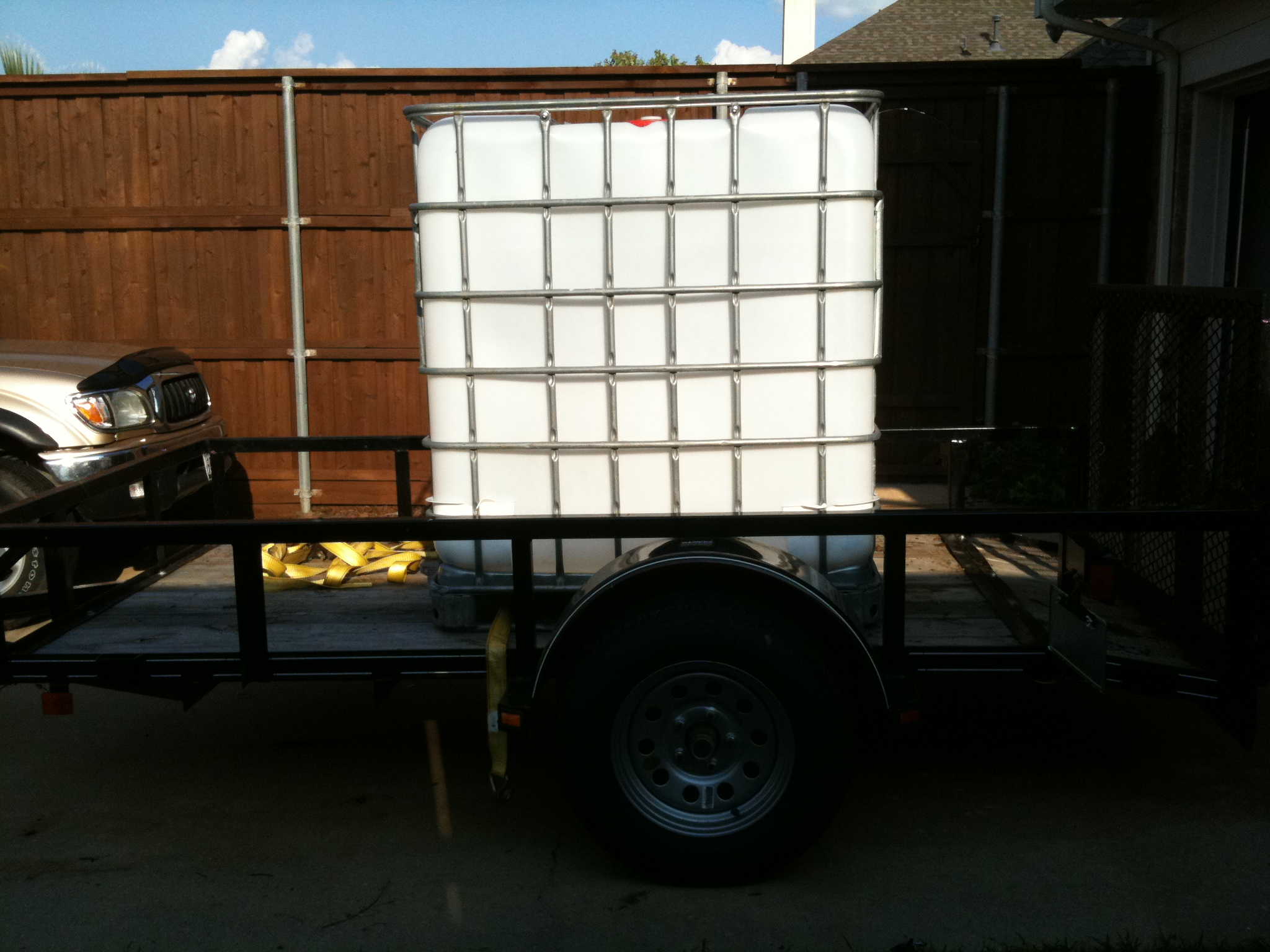

This is the first time I've had to use my new trailer with any significant weight on it. All my numbers check out, 3500lb single axle, 900lb trailer, truck towing cap is 5,100lbs. The load is a tote container of 330 gallons of good ole H20 weighing in at 2,753lbs.
My truck's OM says I should have 9 to 11% of the total trailer weight not to exceed 350lbs on the hitch , so I'm shooting for around 10% tongue load.
Here's the tough part, I'm not sure how you determine the position over the axle that gives me this 10%. I have to get it right to begin with because once I fill this puppy up, I really don't want to drain it to make it light enough to start over. Any help from you old pros is greatly appreciated.
Take a look at the pics and let me know if I'm close where I'm at or if I need to be looking for a tongue scale that can measure up to a 1/4 ton?

What I would do is place the tongue on a piece of 4x4 supported one end with your bathroom scale and a scrap of wood the same thickness on the other. The use of the pipe like in the pic is not that crucial. I have done it both ways and the error is negligible. Fill the tote with water and you should read 1/3 the weight on the scale. In your case somewhere around 120#
I think you need to come forward 6" or so. To little tongue weight is 100 times more dangerous than too much.

You look fine in the pic. When you crank the trailer down onto the hitch make sure that you get an inch or so of sag.

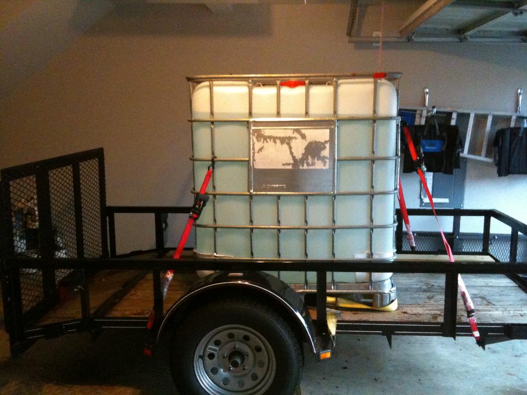

One other thing is strap it down good. I would go though the bottom of the tote where you pick it up with a fork lift and also from each of the top 4 corners with some lighter straps to keep it from tipping.

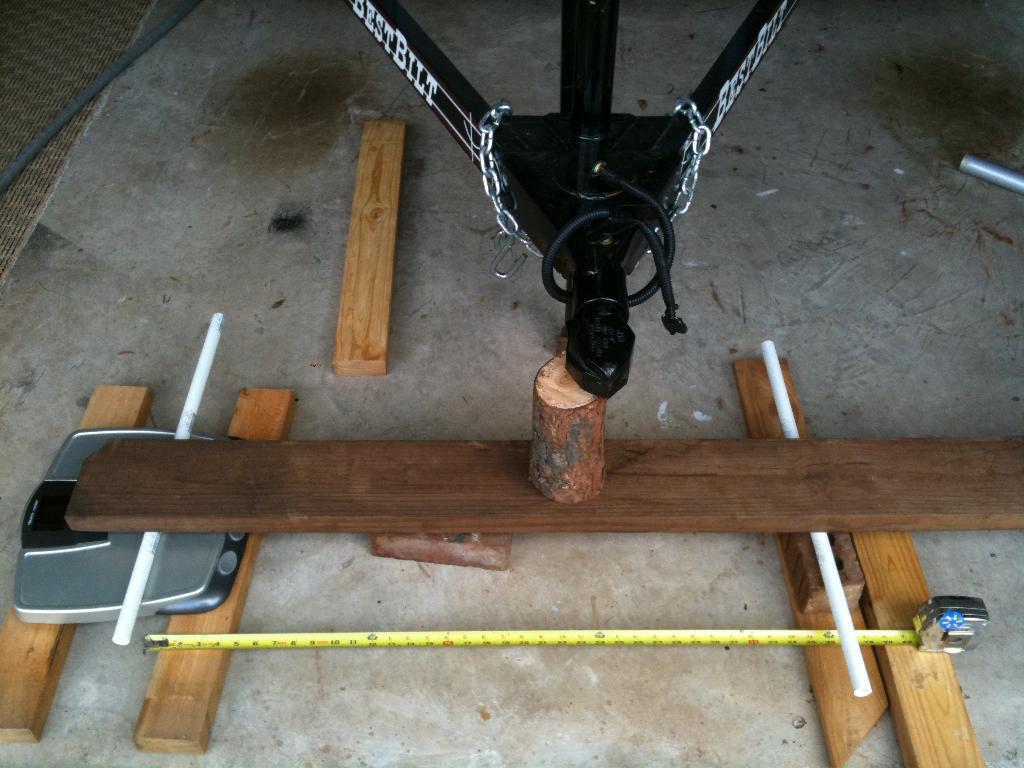

Here are directions to use a standard bathroom scale to measure tongue weight: Tongue Weight Scale
Take that, measure empty, fill the container 1/4 of the way with water and use your straps on the trailer uprights to pull the container forward or backward as needed.
Chris
Chris is right. Move it forward a smidge. I have a very similar trailer and cheating toward tongue weight versus the wig wags caused by having it just bit too far back is an easy choice. Go for the tongue weight. Wig wag is not fun.
/ Trailer Weight Distribution - Single axle #8
Ditto that. The center of your load is favoring just forward of the axle. Looks good.

Interesting setup in the drawings for the bathroom scale.... those "pipes" look tiny. I have a couple of pieces of 1 1/4 " pipe to use but getting them level and balanced makes me think of one of those circus acts I saw as a kid, I may have to find smaller diameter pipe for the scale test.

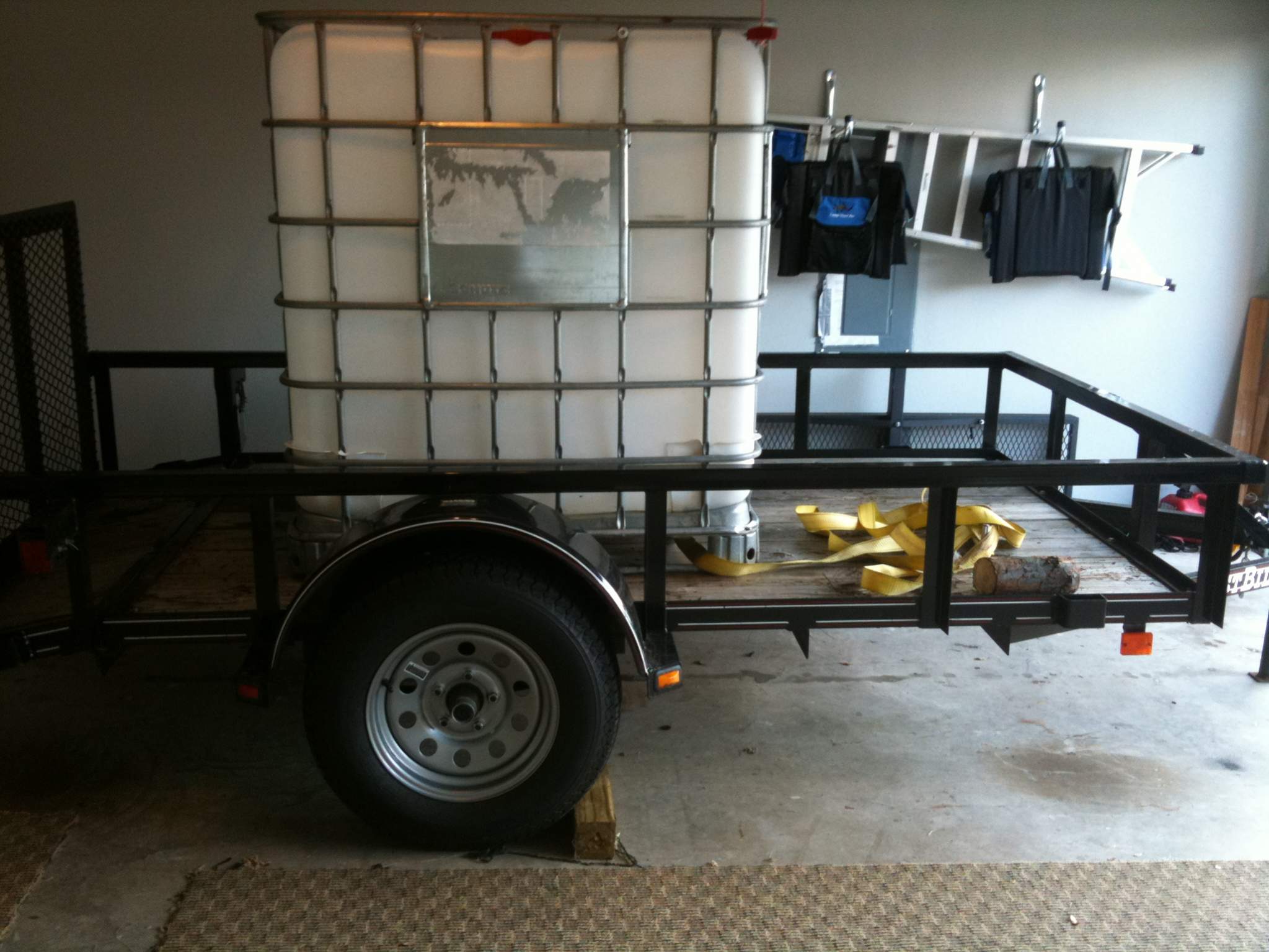

Here's a shot of the bathroom scale in action, the brick under the board is not touching. I almost spent another $20 on an analog bathroom scale but this digital worked out OK in the end. I ended up stopping at 300 gallons times 8.3 = 2,490lbs. , the scale showed 104lbs. , multiplied by 3 = 312 lbs. tongue weight. (well under my 350 limit)
I moved the load forward about 6" as recommended and have it all strapped in for a snug ride.

I would be more concerned about the load moving inside the tank- no big deal but remember that the water will be sloshing around in the tank and you will feel it.
/ Trailer Weight Distribution - Single axle #14
I agree. A full tank is a lot more forgiving than a 1/2 full tank. Also on the tongue weight, more is better. I would move the tank forward a few more inches to get you right at the 350# mark.
