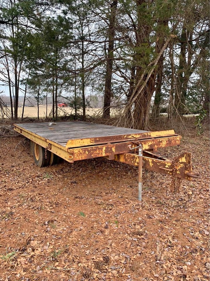

Does anyone know anything about these trailers? Any idea of a manufacturer so I can get specs? Does it have electric brakes? Looks like something you'd load a D3 on haul behind a dump truck.
It is a tilt trailer too.
I've been on the hunt lately for a 12-14 foot tandem axle equipment trailer, preferably a deckover, to use as a utility trailer. This thing popped up and its really got my attention.
I'm contemplating buying it to use as a utility trailer. I'd add stake pockets and make sides for it to haul dirt/mulch/gravel, pallets of stuff, logs, brush, etc...

That would be one rough pulling and riding trailer. It surprises me that it does appear to have a man tag on it because I would swear it looks homemade. If you're just puttering around with it it may be okay but for every day utility use I wouldn't want that heavy thing.

You probably need to go look at. Looks like an ID tag on it but it might be hard to read. It is for sure heavy duty but no suspension. Might be hard on a pickup truck to pull.

I have a smaller lighter solid axle tilt trailer and I can attest to the rough and bouncy ride solid axles give. You really have to secure the load against the bouncing or it will break straps and bounce right off.
Keep looking.
   / Single axle, dually equipment trailer #5
Really hard when you have no suspension. They are venerable to bending parts.
   / Single axle, dually equipment trailer #6
The tires become the only suspension on a solid axle rig. Run low air pressure to cushion the load. But this endangers the tires...

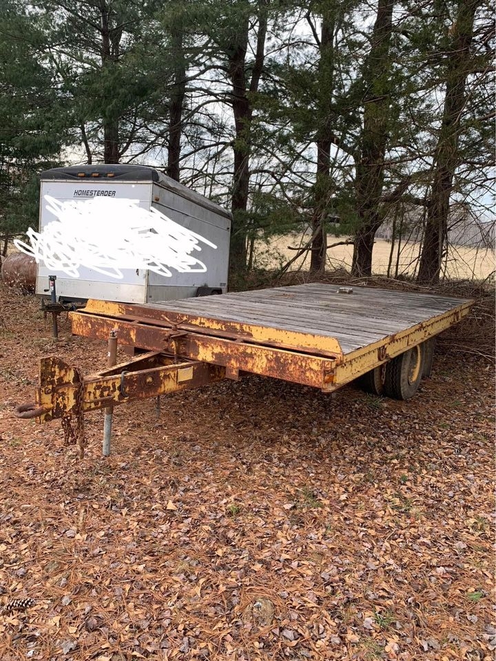

well, it does have brake drums. How good are you at tracking down vintage parts or making them yourself? How much will it cost to strip, sand, repaint and redeck?
For your desired uses, tongue weight will probably be the biggest issue.

There was a single axle dually that showed up on either Facebook Marketplace or Craigslist on the West Coast a couple of days ago here, but somewhat different styling than that one. It probably makes the tilt mechanism work easy as it would just tilt over the axle with a hinge on the tongue.
I don't see the air cans that are part of air brakes, but those could be hidden behind the axle. Or it might not have functioning brakes at all. Most of the old heavy equipment trailers will have air brakes and not electric brakes.
What are you towing it with? Are you planning to license it?
I've been towing a 10K utility trailer behind my RAM 1500. I'd like a couple more K's, but my RAM wouldn't, and I'd have problems licensing a larger trailer.
And, as mentioned, the higher capacity equipment trailer, the HEAVIER.

Thanks everyone. I was a little concerned about no suspension, but I thought that the weight of the trailer would help with that. This definitely wouldn't get used every day...maybe a half-dozen times a year.
I could remove the solid spacer above the axle and install leaf springs. I was planning on welding the trailer together to eliminate the tilt feature anyways. But I think between that, the brakes, new tires/deck/wiring...it may be more of a project than I want to take on.
I have a F350 dually axle and suspension I could throw under it too and use an electric over hydraulic brake setup...but again, I don't think I want to take that on at this time even though I think it would be a fun project.
Definitely not at the price point they are asking for this trailer at this time either...
I'll keep looking for a standard tandem axle trailer I can cut down...
