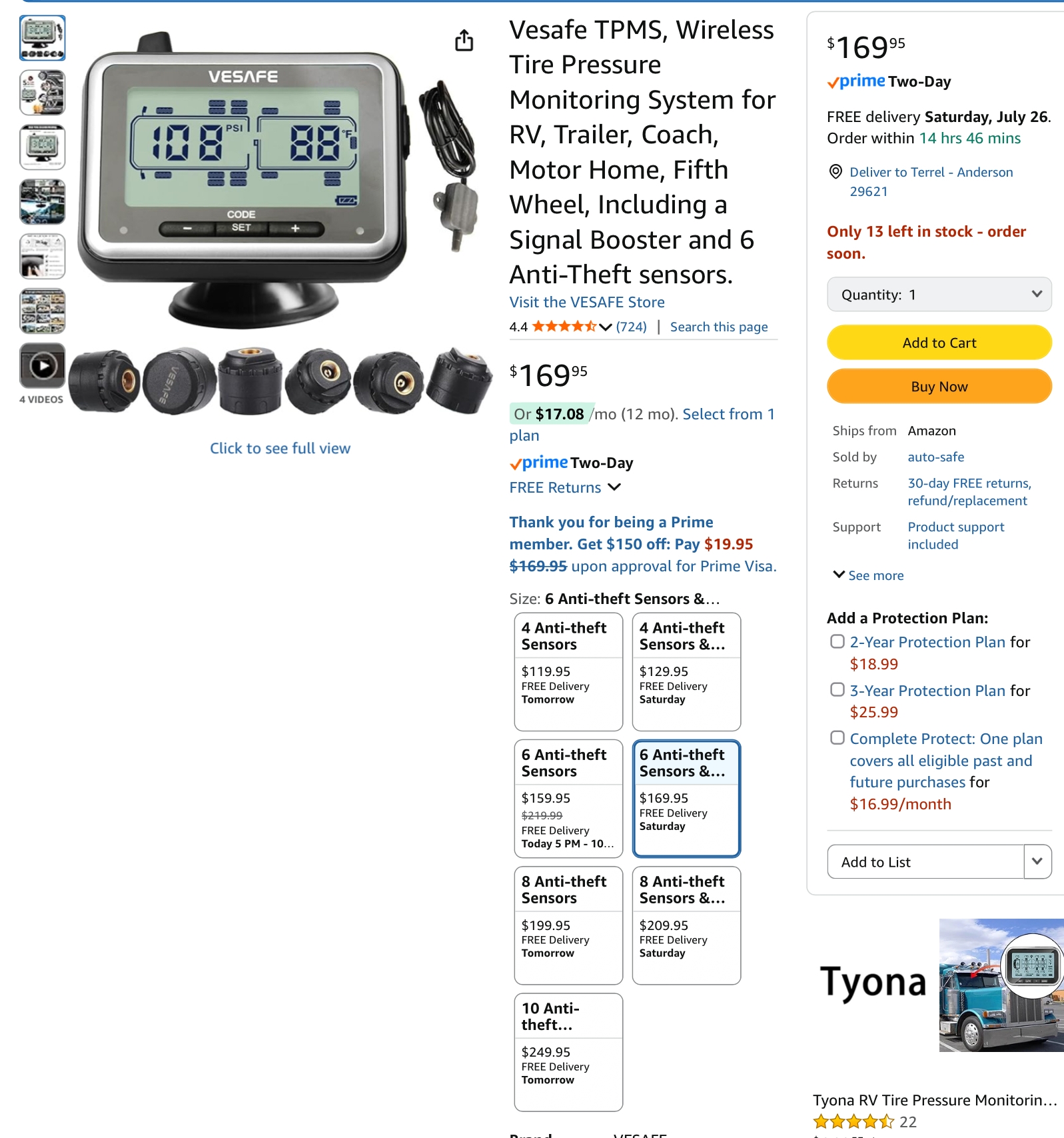

I bought Guta brand for my 5th wheel. We got a newer 5th wheel this year and found out that the GM ones that are able to read on my truck don't got above 100psi. New 5th wheel tires are 110psi so I bought the Guta brand and so far it has work very well after 4 trips. They have one that will monitor truck and trailer.

The cheap/low cost end of the market is: Amazon.com: Tymate TM7 + New Updated M12-3 : Automotive
IMO the best overall is Pressure Pro brand- made in the U.S.A., and TST brand.

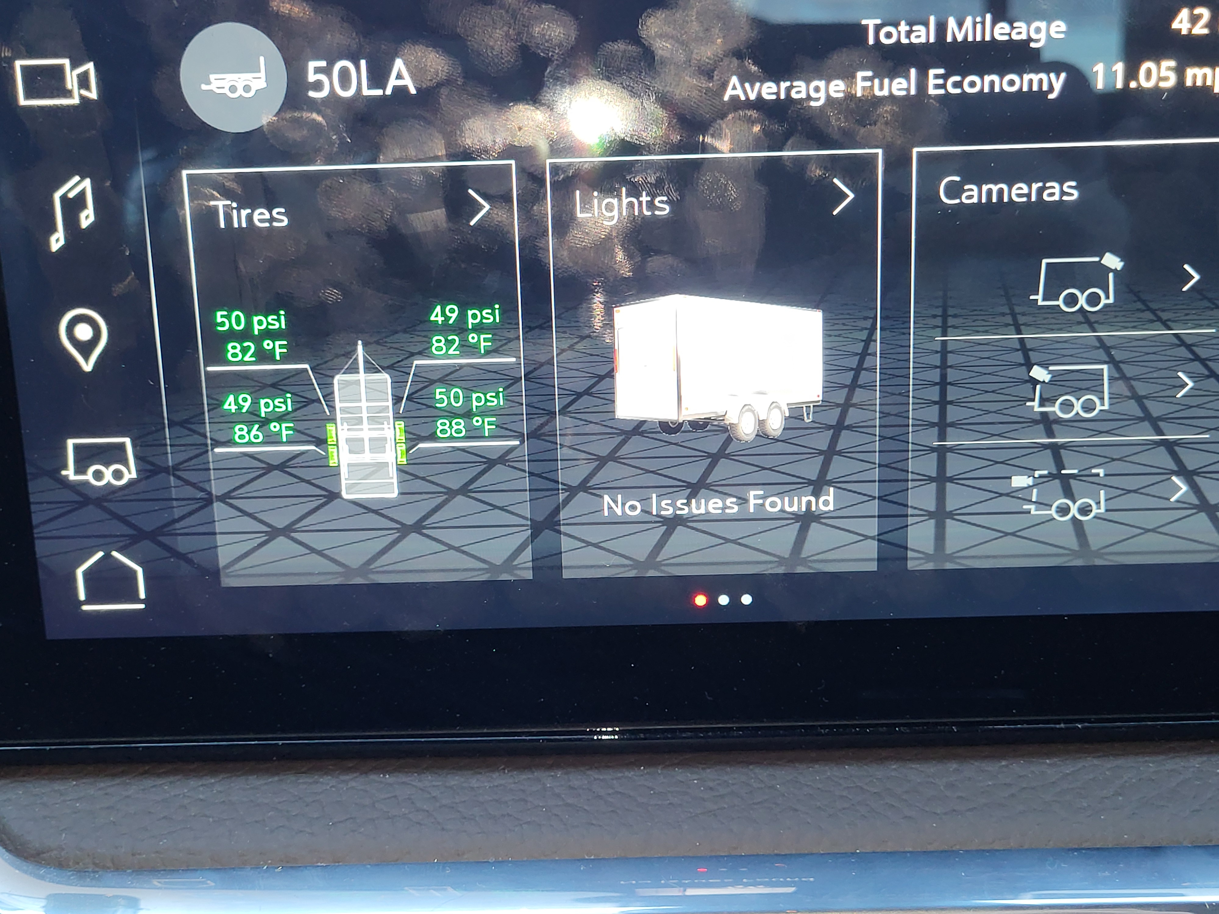

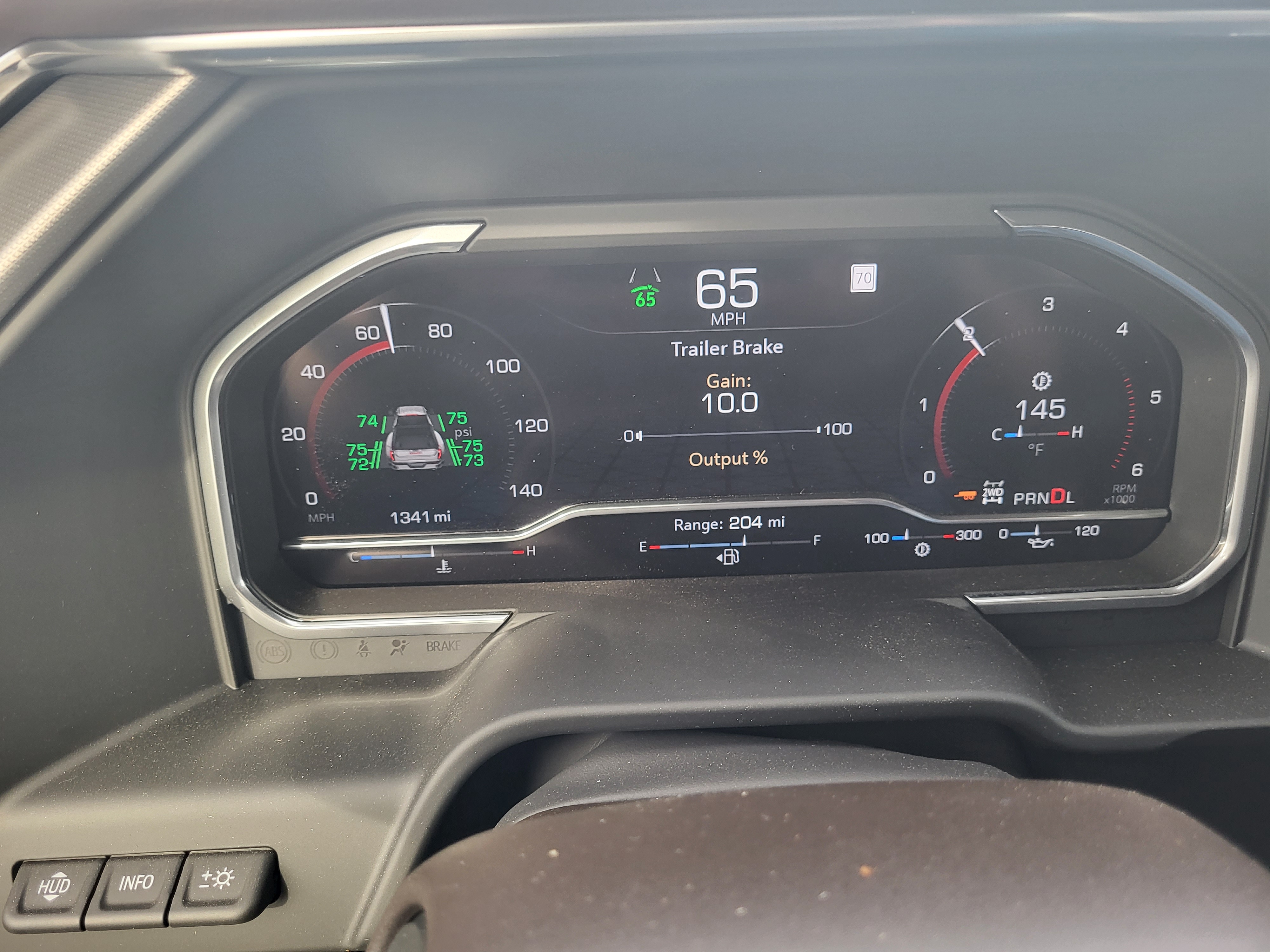

I would add it to the truck and trailers. I have the GMC factory TPMS for the truck and all 5 of my trailers. It is great peace of mind monitoring it. My trailer TPMS also shows air temp in the trailer tires. I figure if a bearing starts heating up it should show up in tire temp.
