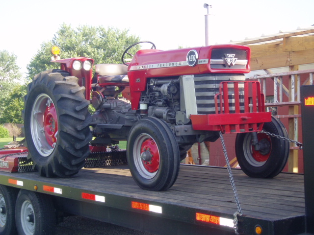

/ trailer tie downs #25
First priority, be safe. Next, be legal.
Here's what keeps my tractor on the trailer, and keeps Kentucky Commercial Vehicle Enforcement Officers smiling.
Grade 70 binder chain with ratchet binder pulling forward. It pass's through O.E.M. weight bracket. Hook ends through stake pockets on rub rail.
Grade 70 binder chain through rear drawbar bracket, hook ends through stake pockets on rub rail. Ratchet binder.
Grade 70 binder chain over bush hog, pulling slightly forward, in back of gear box, with ratchet binder. Hook ends through stake pockets on rub rail.
Chains get replaced every 3 or 4 years.
Scratches get touched up now and then.
