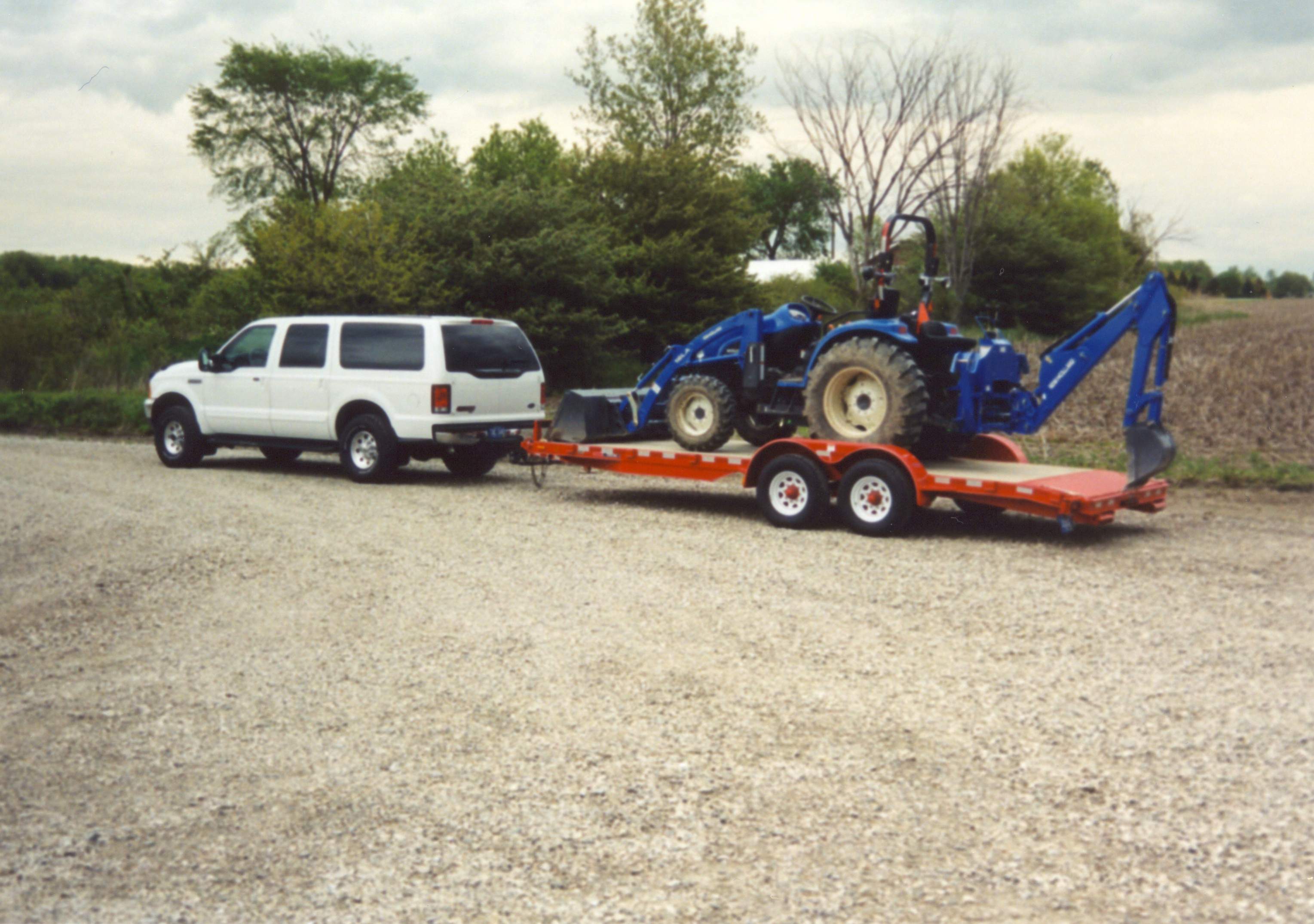

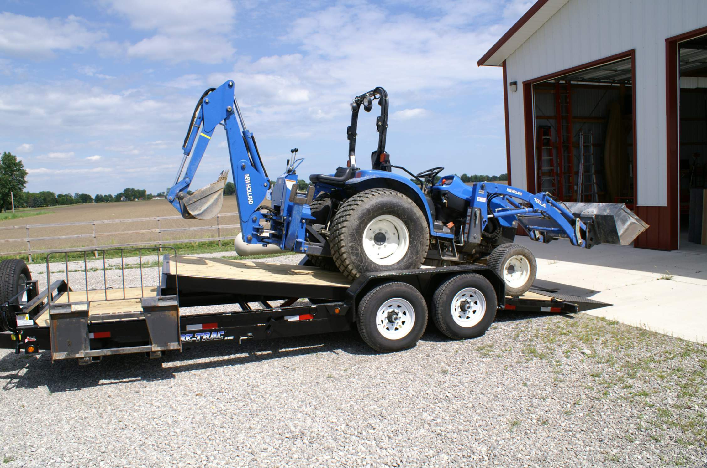

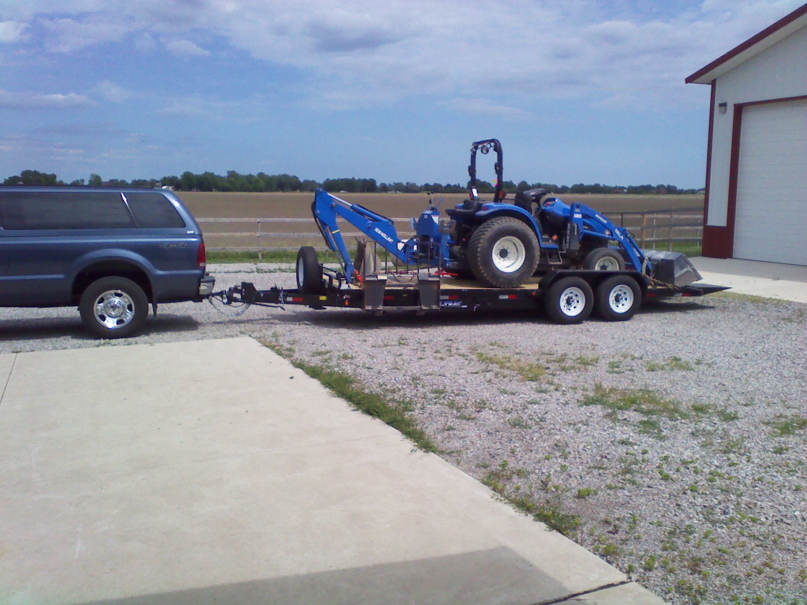

Below are pictures of my TC40D on my old 20' 10K and new 22' 14K tilt deck. The 20' left no room to balance the load which is one of the reasons I upgraded to the longer trailer (besides the tilt deck is great).
