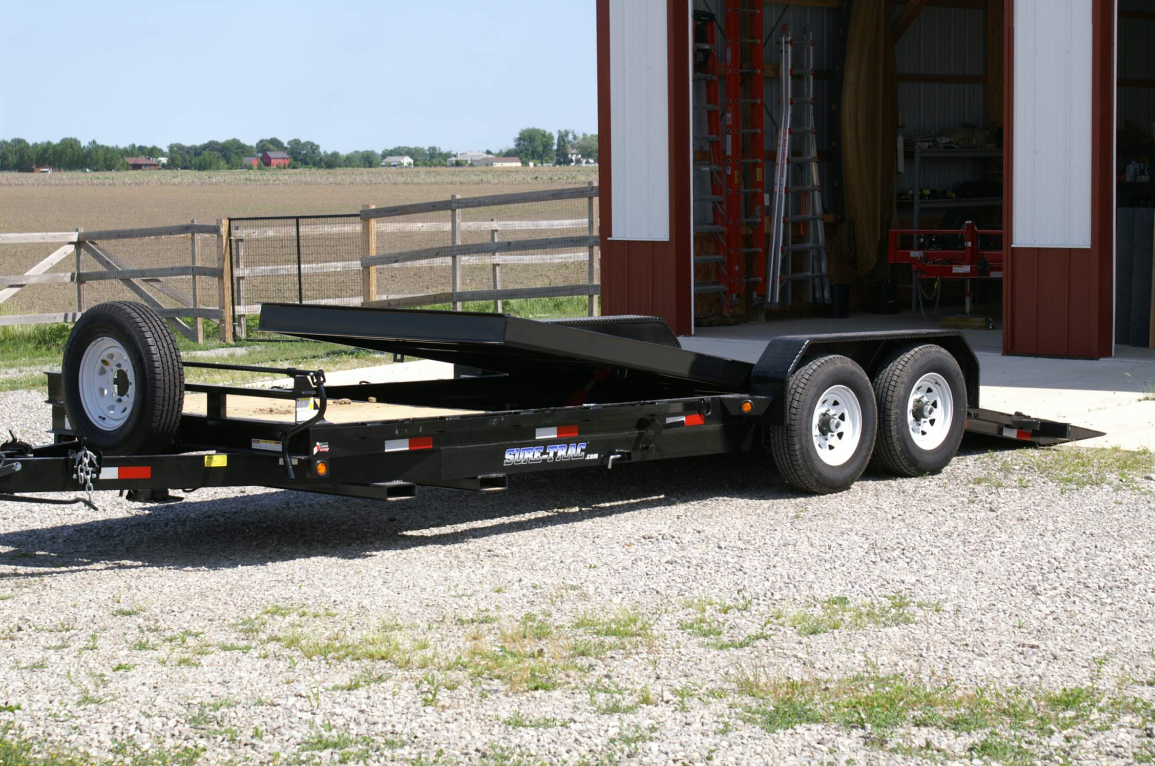

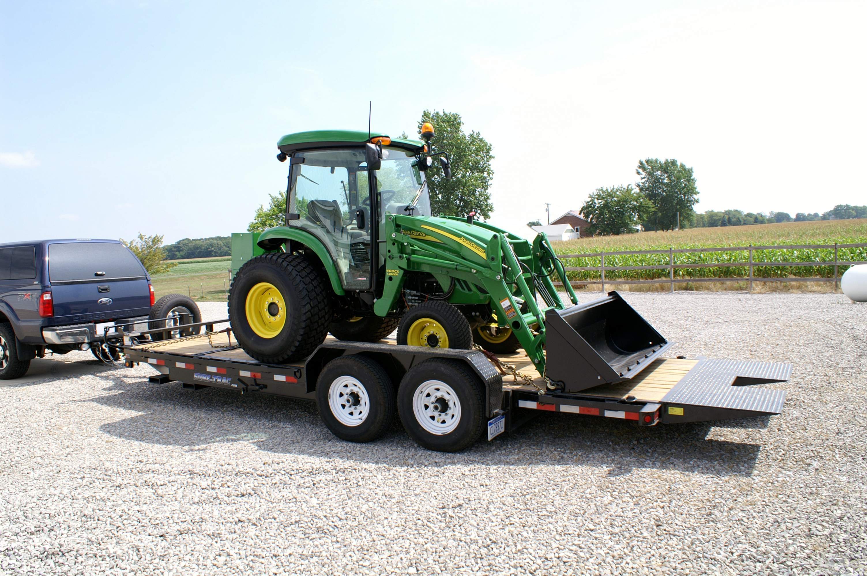

14K tag works great if you have enough truck. I agree that you will be better off with a wood deck. The last couple feet of mine is diamond plate and is extremely slick when wet compared to the wood. You can walk on the wood and skate on the steel if wet.
Sure Trac | Home
If you can afford it they now offer Hot Dipped Galvanized if you are concerned about rust.

Whatever you buy be sure it has good axles like Dexter under it.
Sure Trac | Home
View attachment 292522View attachment 292523
http://www.tractorbynet.com/forums/trailers-transportation/175592-new-trailer.html
Nice trailer.
