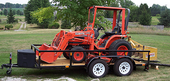

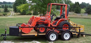

I finished building a trailer this spring for my B7500 which is not too much bigger than your BX. I also struggled with deciding on how big to make the trailer although I really wanted to keep it smaller in size than my buddy's 7 1/2 x 16 footer that I previously borrowed. I have a FEL, MMM and back blade. I decided to size the trailer for the tractor and FEL figuring that I could set the back blade blade down between the bucket and front of the tractor. So I went with a 6 x 12 foot trailer. I'm happy with the way it turned out. But then I got a good deal on a used Box Blade and my trailering now has a new issue as you can see in the picture with the BB hanging off. I could load the BB in the bed of the pickup but would really rather leave it attached to the tractor. So I'll be exploring ideas like some removable stock on an angle above my storage box so the FEL bucket actually rests (and gets strapped down) in front of the trailer. If I had to do all over again I would have gone 14 feet long and not had this issue. So while I see your point about keeping the trailer size down also look to the future if you think you ever may acquire any other implements.

The main issue with your setup is getting the right amount of tongue weight. To do this you need a trailer that will allow you enough room to shift the weight around. Looking at your trailer specs you listed I would guess, based on what my trailer weighs, that the 16' version is in the 1400# range. Its only $10 more than the 14' version so that is a no brainier to me.
Get the 16' with ramps and you will be fine. Just make sure you truck has a brake controller, the trailer has brakes, and you have a tranny cooler on your truck. If not get one, they are under $50 and can save you $2500 in a hurry.
