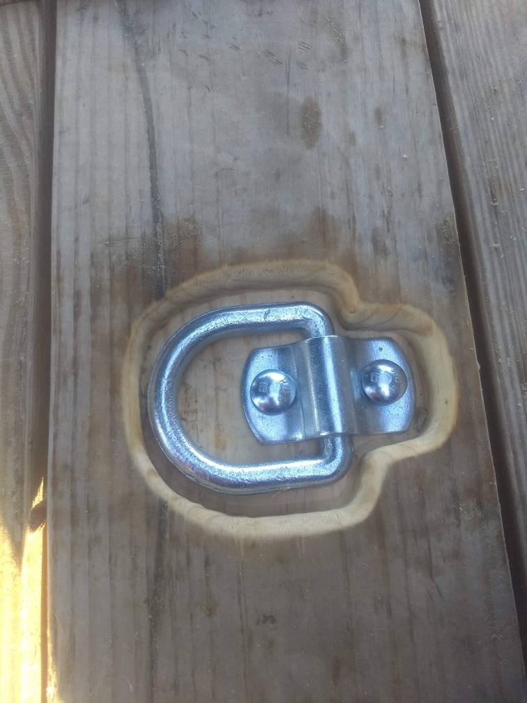

I like having a wood deck. It's something easy for me to replace, work on, and modify. I recently flush mounted some D rings in key locations by routing out where they needed to go.
I'm much more experienced and much better equipped to work with wood than metal.
I have also occasionally screwed something to the decking to help secure cargo.
