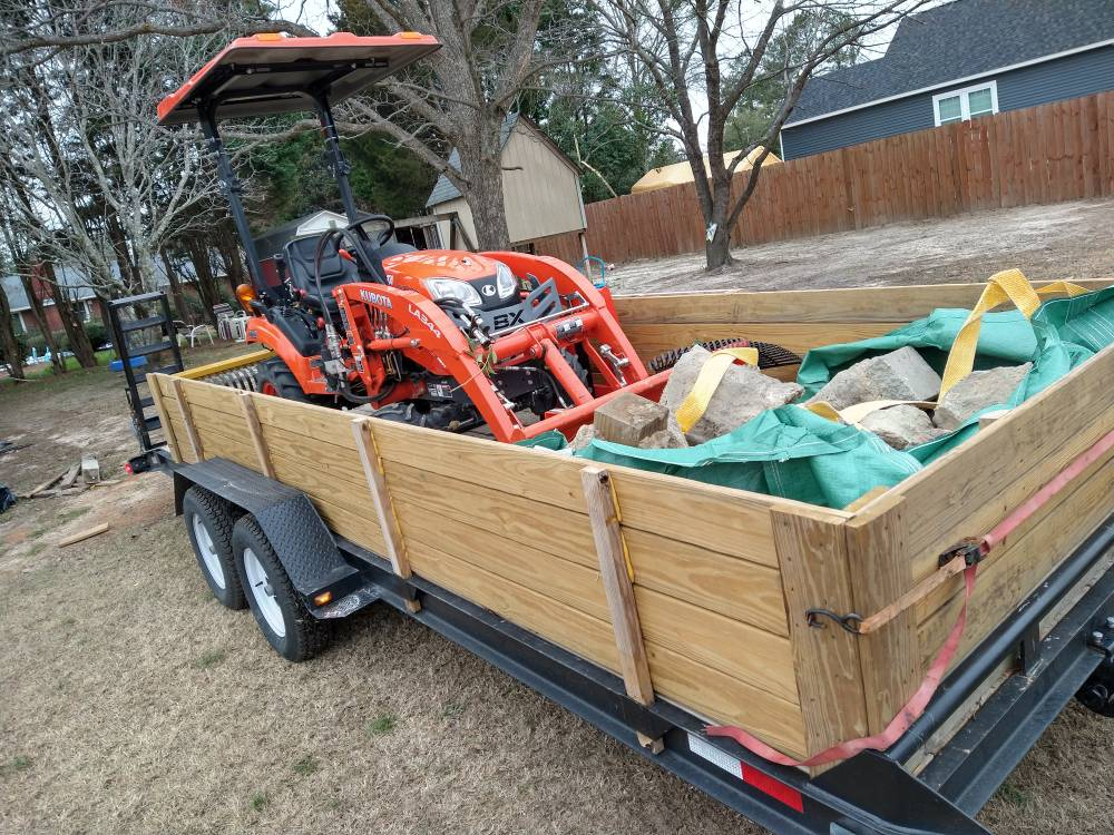

I thought about drilling some drain holes, but I do keep it parked under a shed. I still may do that at some point.
I wanted them recessed because I will haul mulch and whatnot occasionally, and wanted a flat surface so I can scrape it out with the bucket.
I built some sides that go into the stake pockets to contain the loose material. There is a back that goes on when needed. Eyes are attached for a tarp.
Isnt it a bit of task to get it out the back with the wood and the steel ramp together like that?

I'm not sure I understand when you say "wood and steel ramp together". Drive up, scoop, back down. Same as loading or unloading. And/or remove a side (s) and scrape from the ground.
I know you aren't hoisting that supersack with that tiny tractor if it's full of what appears to be concrete blocks.
