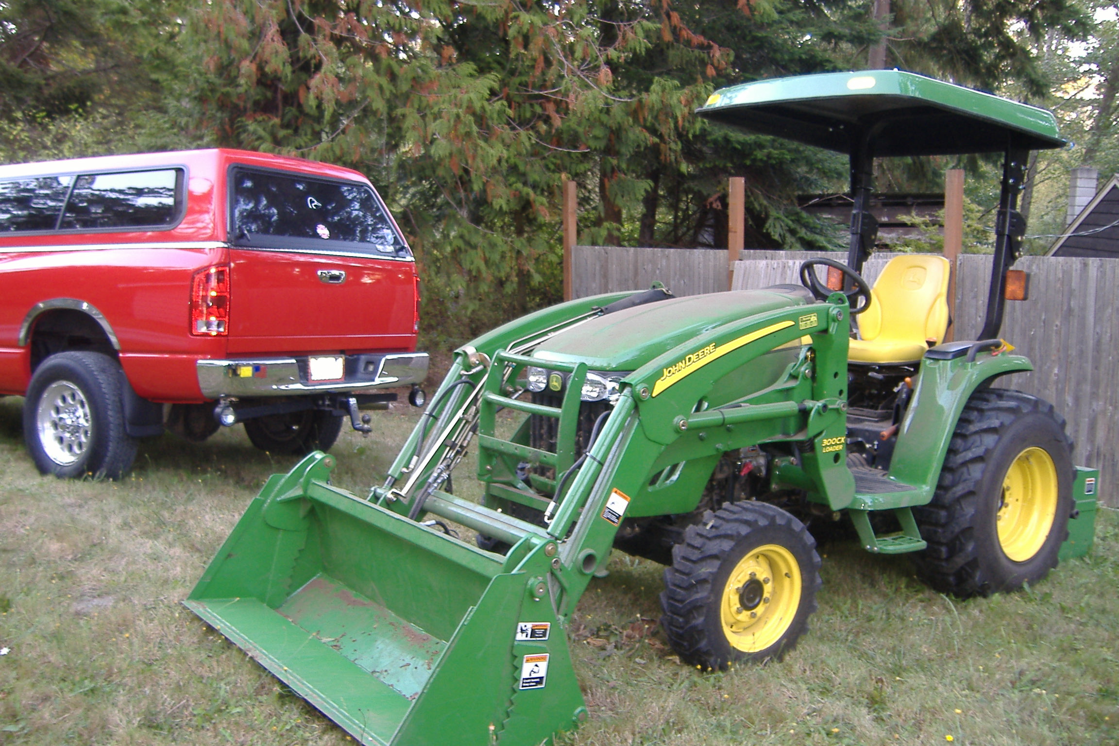

The guy that dropped my new tractor off suggested that I only tow it backwards on the trailer because of the canopy. It seems pretty stout and I could swear that the salesman told me it would hold up fine all day long on the freeway facing forward.
Maybe this guy had something happen to him. Which way do you point the tractor enroute?

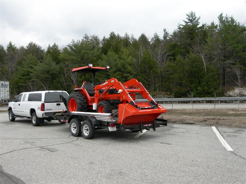

I tow mine at highway speeds. Canopy instructions suggested towing backwards so I do. It's not any more trouble and I don't worry about it.
