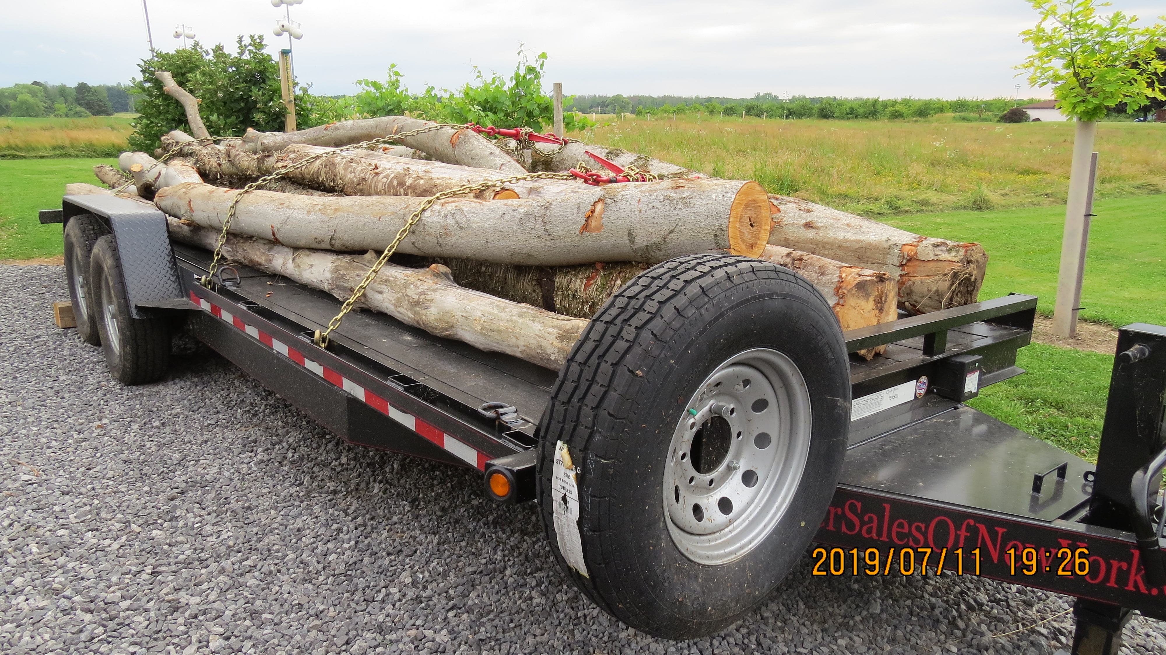

I agree with Redbug and Norm W. I bought a 23' 15,000# tilt trailer. It's a very versatile trailer and not near as heavy as you would think. Bare trailer weighs only 3200#. My excavator weighs in at 6300# and has plenty of wiggle room left over for attachments. Loading/unloading is a breeze compared to ramps. Not a bit of pucker factor. Hauling my tractor with loader, bucket, brush hog and calcium filled rear tires fills the trailer up. Actually the brush hog tail wheel hangs beyond the rear of the trailer. It gets a flag attached so everything is kosher. Weight wise I am most likely close to being maxed out. My truck is a 2500HD with the 6 liter gasser engine. Much more weight or high altitude terrain I would be needing to purchase a new diesel powered truck.

/ Trailer for mini excavator? #16
Great pictures. What a lovely family
