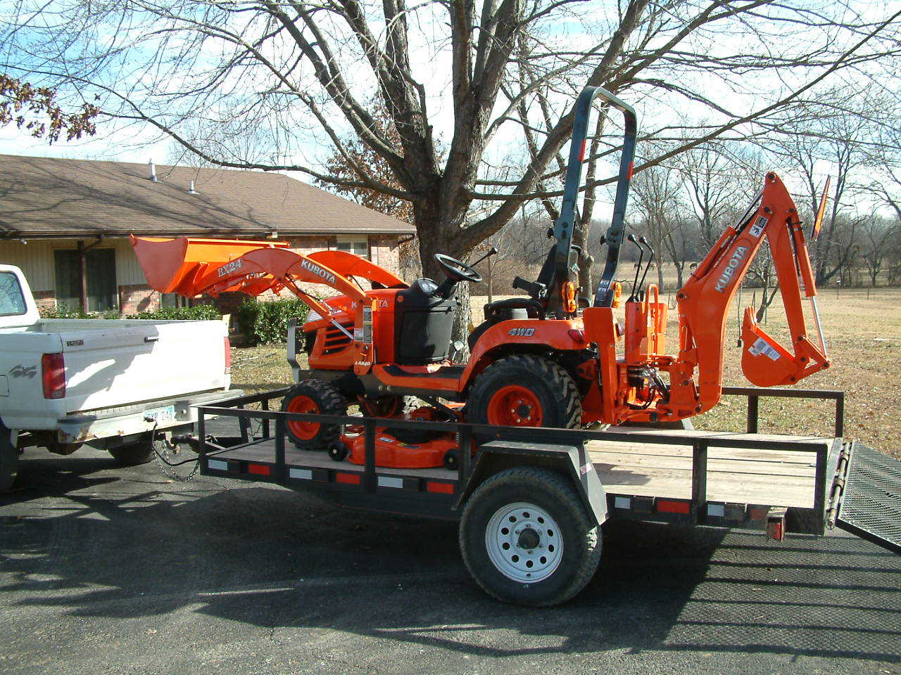

here's the way it arrived from the dealership. yes, the dealer. note the over-loaded tires and single axle, lack of adequate tie downs, pretty illegal looking bucket overhang, excessive tongue weight, high center of gravity, etc.
i'm much more comfortable driving down the road at 70 mph with the new set up in the post above. sure, it fit on the dealership trailer, but that's about all you can say positive about their set up.

What kind of truck would have a bed long enough for a BX24 with the FEL and BH mounted? Seems it would be too long for even a pickup with an 8' box unless the FEL was raised above the cab and the BH hung out the back.
You could remove the bh and fel and deck. Load the tractor in the bed. Put the attachments on a tow behind single axle trailer.

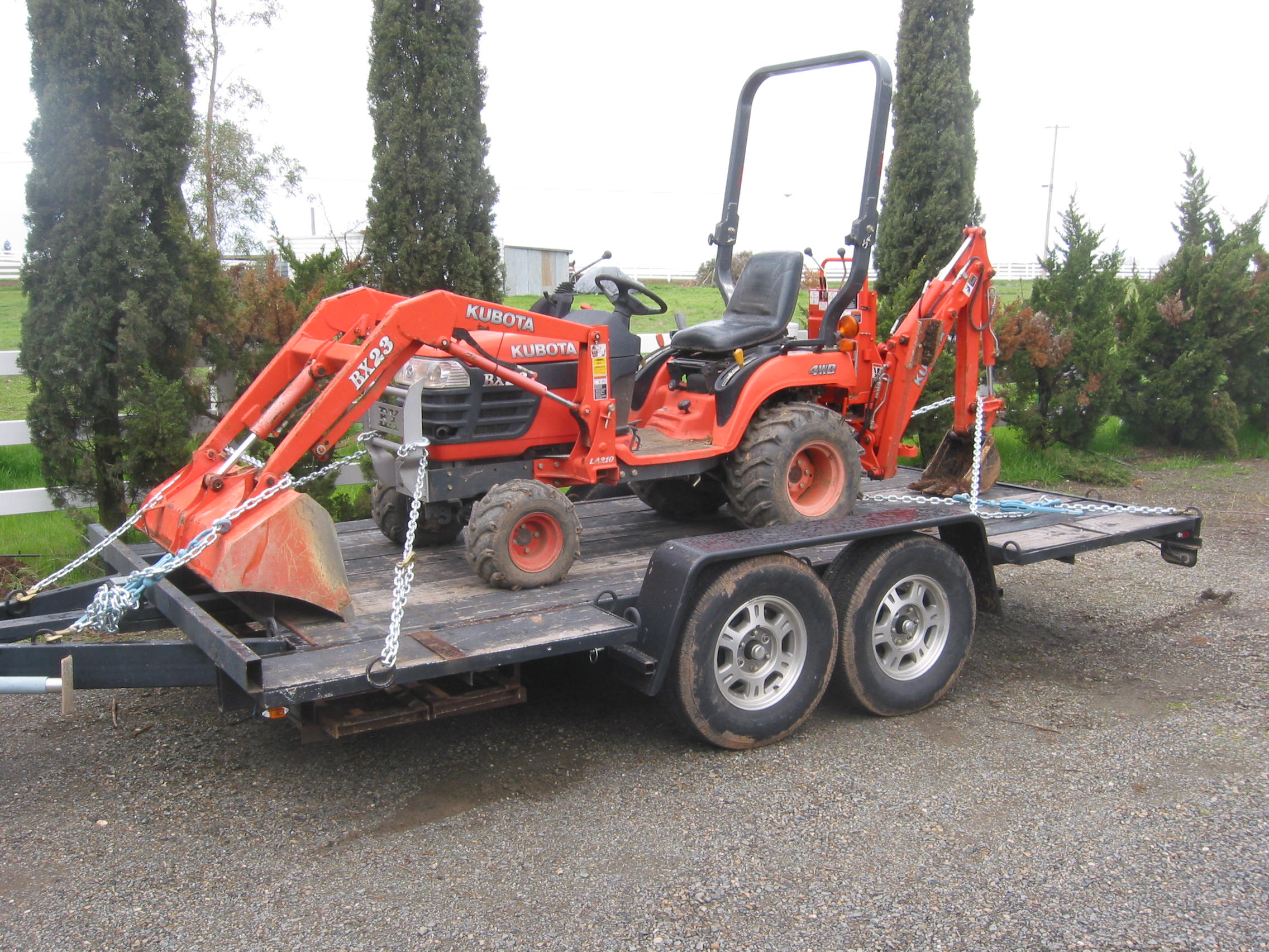

Here is what I use. 16' dual 3500# axle with brakes on both axles. Kind of overkill for the bx but about maxed out with my @5000# jeep on it.

Is the left front tire on your tractor low, or do you pull down hard enough on the chains for the tire to flatten that much?

I like your set up. How much could I expect to pay for a trailer like that?
I also like several of the other trailers but some of them look expensive.

I got the trailer off Craigs list for $500 then added brakes/lights/fenders/miss. Got about $1200 in it now. I got a box to mount on the front if I ever get around to it.
<Mr. Bx23barry: I very much like all the tie-down hoops around the perimeter. Very useful.>
Me too. Only problem is driving over them loading/unloading. I also have some trailer jack stands I put under the rear when I load the jeep.
