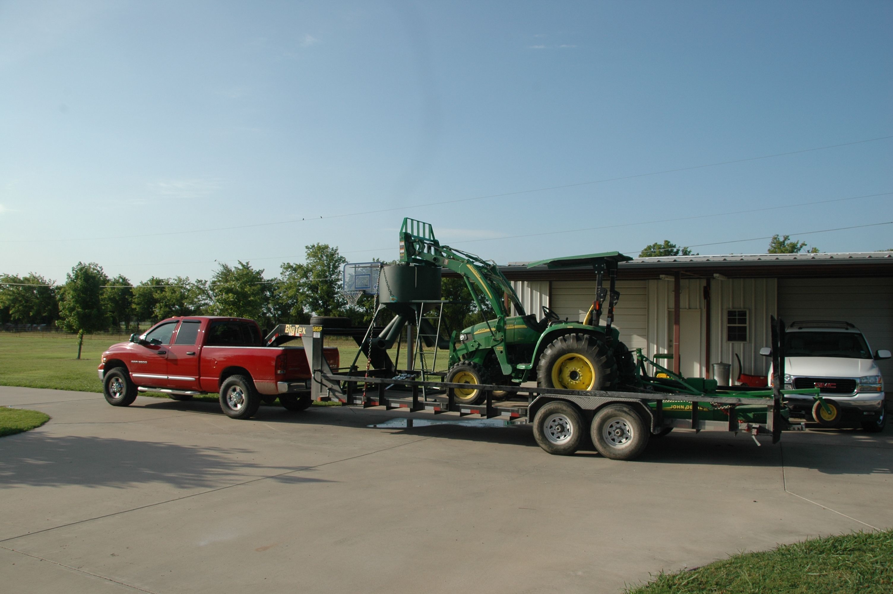

Well I did it now!! Just wait until my wife sees this. If I do not post for awhile you all will know what hapened:rolleyes:
I bought a new 2009 20ft 14K trailer with fold up ramps. I would have gone longer but I do not haul my 4120 with the Frontier RC1073 very often and it is the longest implement I have. This is one awsome trailer.
I don't know what I was thinking when I proposed hauling this load on my 18ft 7K car hauler!!:eek: I think that would have been my last mistake.

/ Trailer for a 4120 #40
John
Nice job, that should work just fine. I think you would have screwed your other trailer up and who knows what else.
