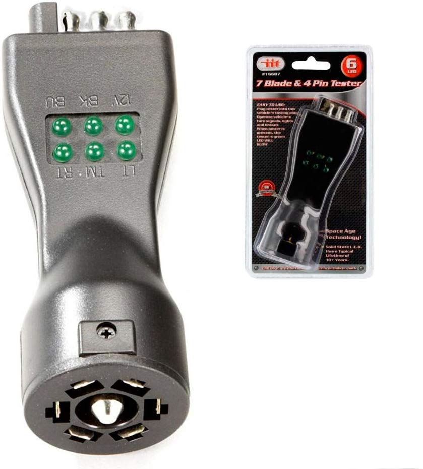

If he wired in an aftermarket brake controller he may not have used the standard wiring configuration. He may have swapped wires on the trailer to make it work. I would start by opening up the trailer plug. Here is the standard wiring schematic.
I bought one of these wiring checkers for less than $20 at O'Reillys. Well worth it to let me know if the truck is the problem or the trailer. Much easier than a test light, which is also handy to have.

You need to get a voltmeter and a helper and check each pin to see when it has voltage and confirm your ground pin. My guess is that you have incorrect wiring on the trailer but you will need to know when/where voltage is coming out of your truck and where it is going on the trailer.

So I checked the truck and it is wired identical to the picture REPowell posted(thanks for the pic). So I guess that is right.
