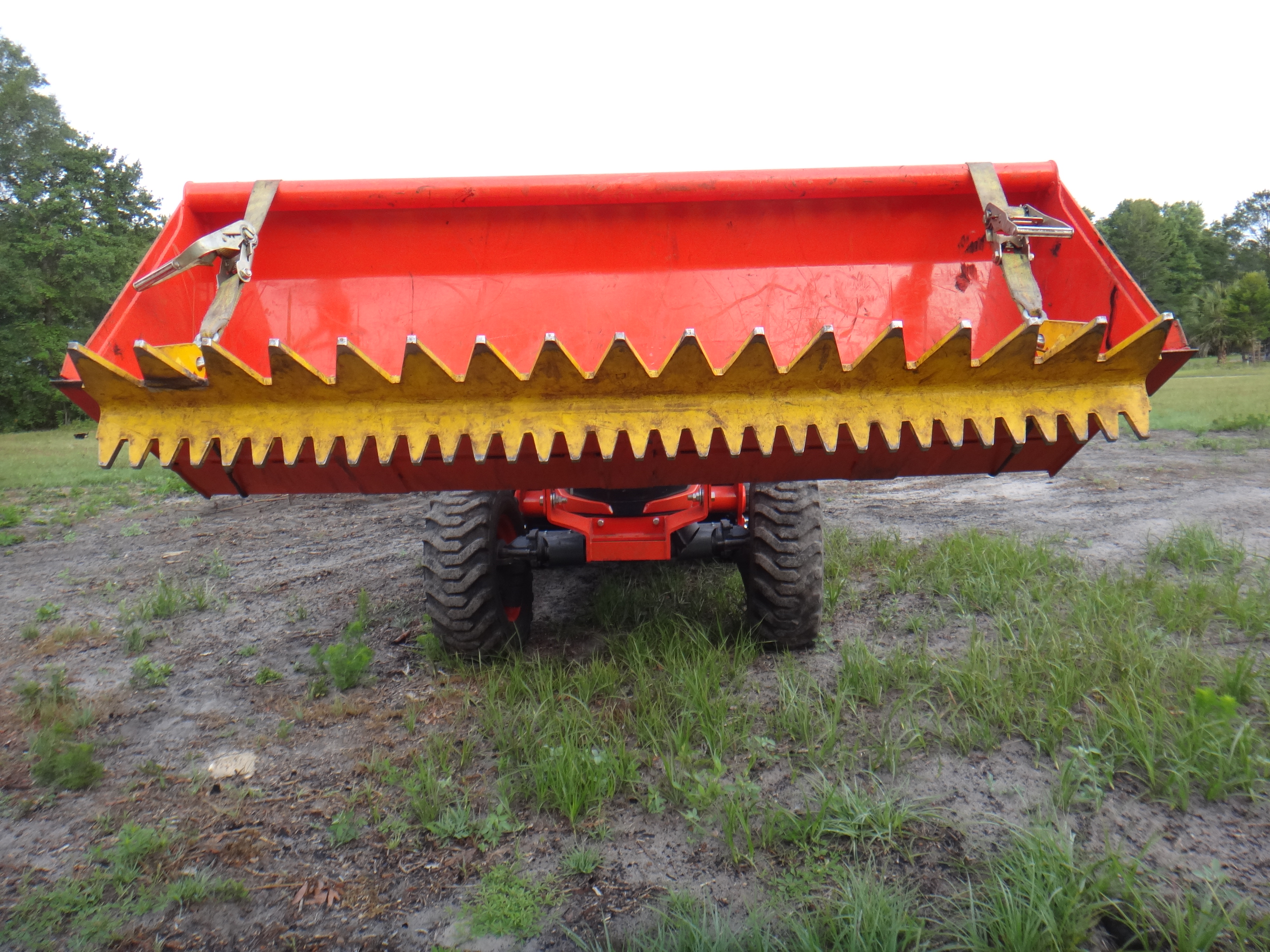

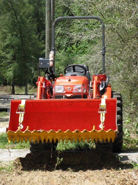

A Ratchet Rake bucket attachment is what you need, not a Box Blade.
Ratchet Rake will allow you to grade after pulling roots. Used prudently, it will prize out 6" - 9" rocks.
Ratchet Rakes are available from the T-B-N Store, button at the top of this page. Delivery by FedEx.
VIDEO: ratchet rake brush clearing - YouTube

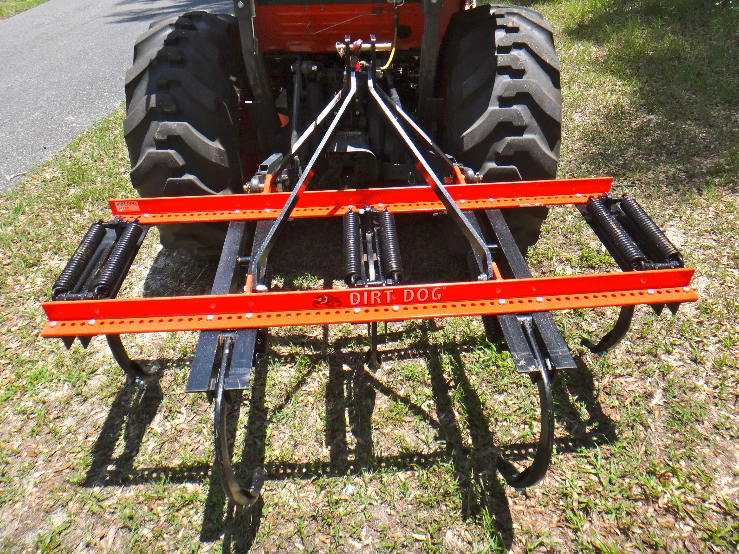

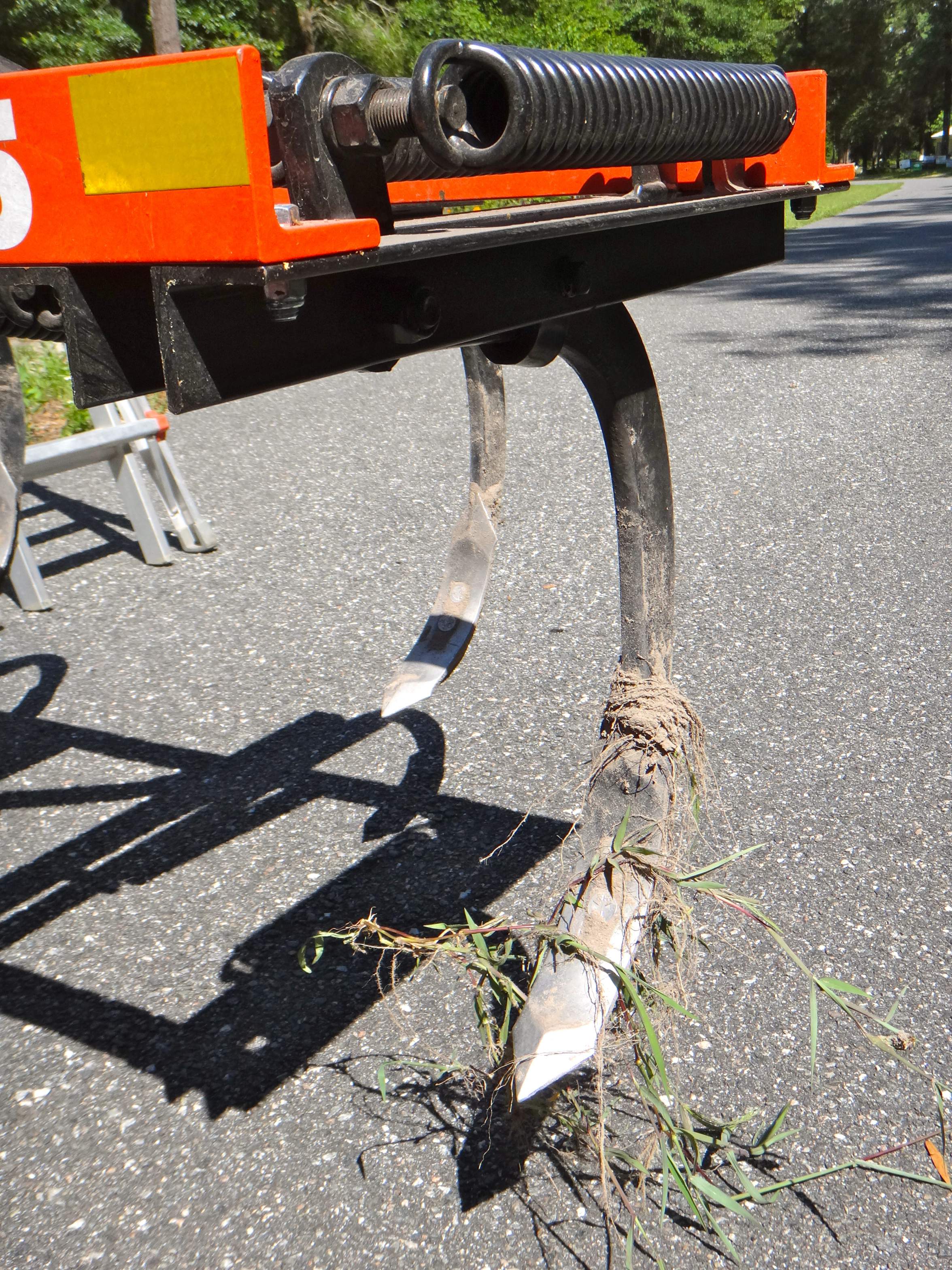

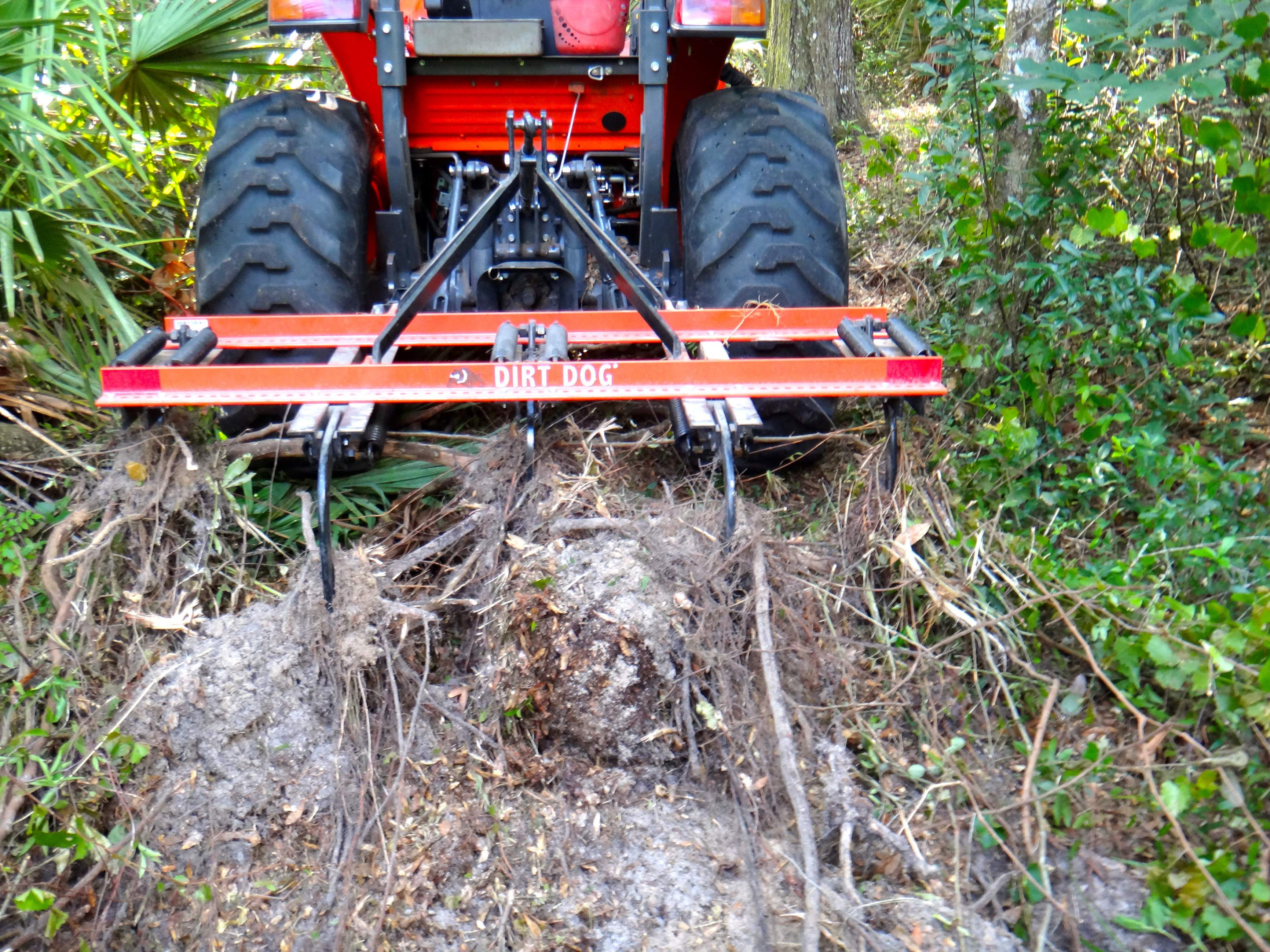

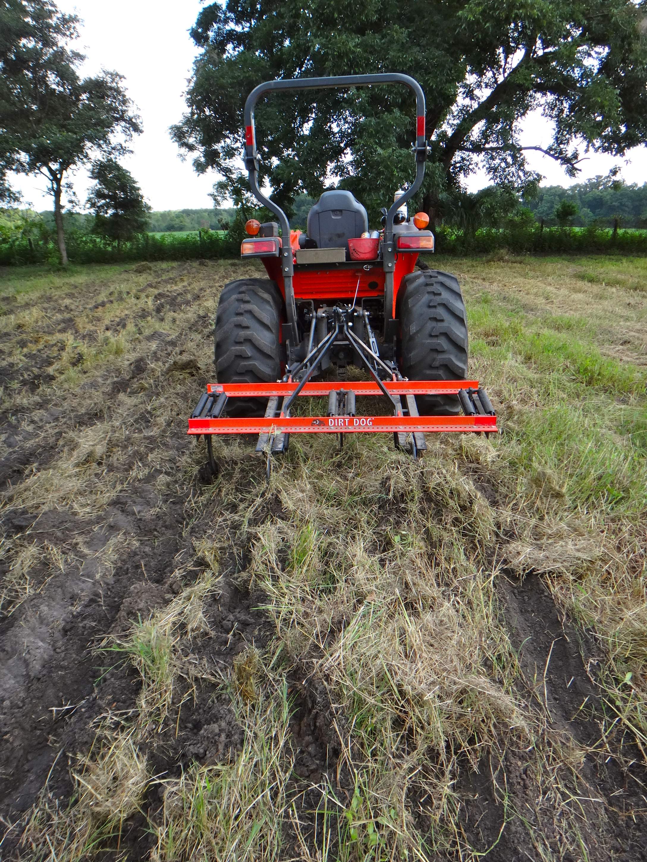

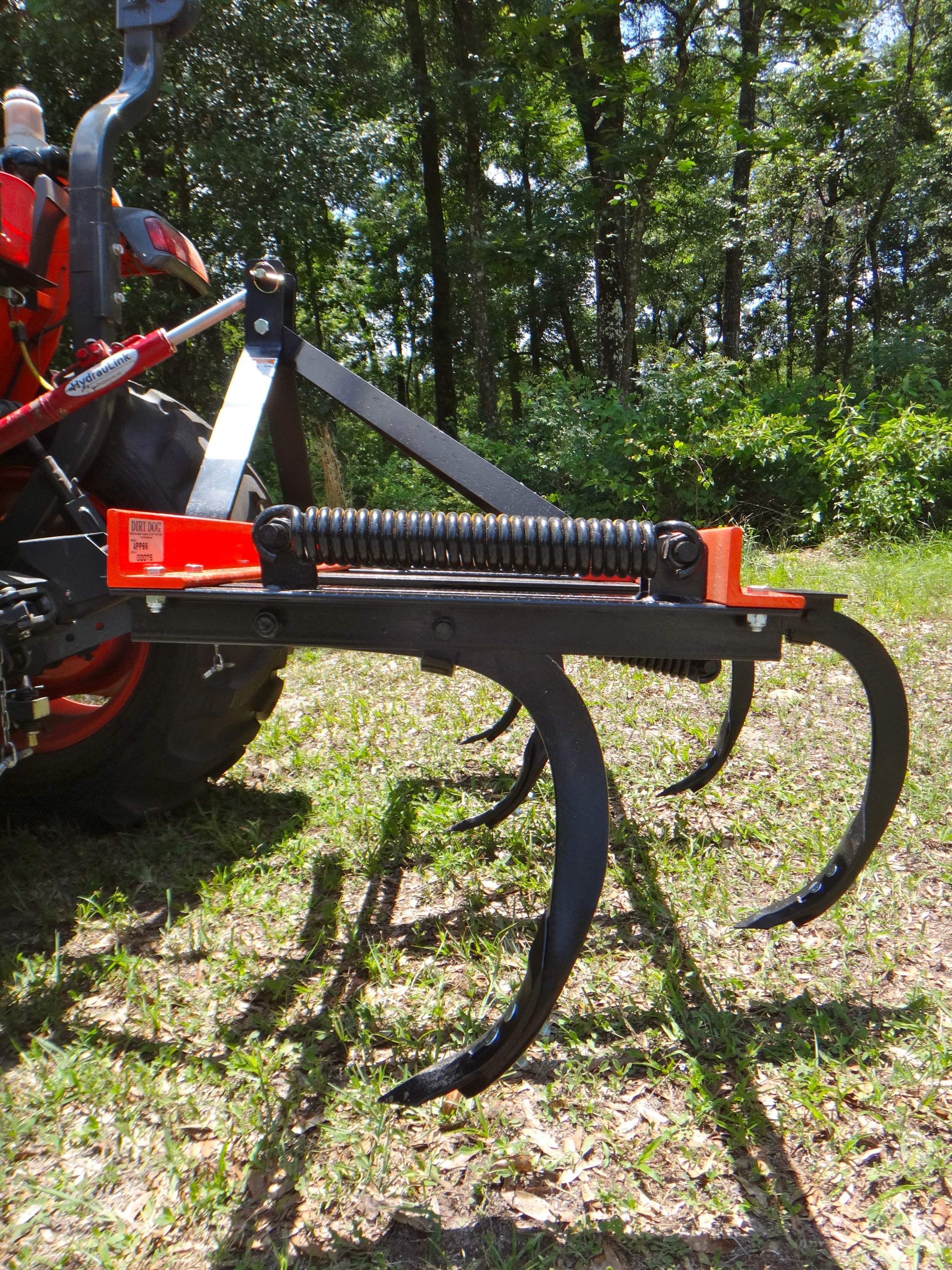

If/when you want to go 10" deep to pull roots and corms a spring-protected Field Cultivator is called for. You could likely pull three, possibly four shanks through MOIST soil with an L2501. You would want to do primary clearing with the Ratchet Rake, then follow with the Field Cultivator, which is a secondary tillage implement.

Thanks Jeff...for both of your posts. I think I am trying too hard to solve many problems with one "combo" tractor. I have pretty much decided to mow with something else and get a separate tractor w/o a mid-mount mower deck to mess with. Also, I think you are absolutely correct that I need more weight or I will find I either damage the tractor or can't use it for my land management tasks. L series may be the most appropriate weight level to start with. ****...that means new trailer and likely tow vehicle...oh well...current tow vehicle has 176K miles so it is time soon anyway. Thanks again...TMR
