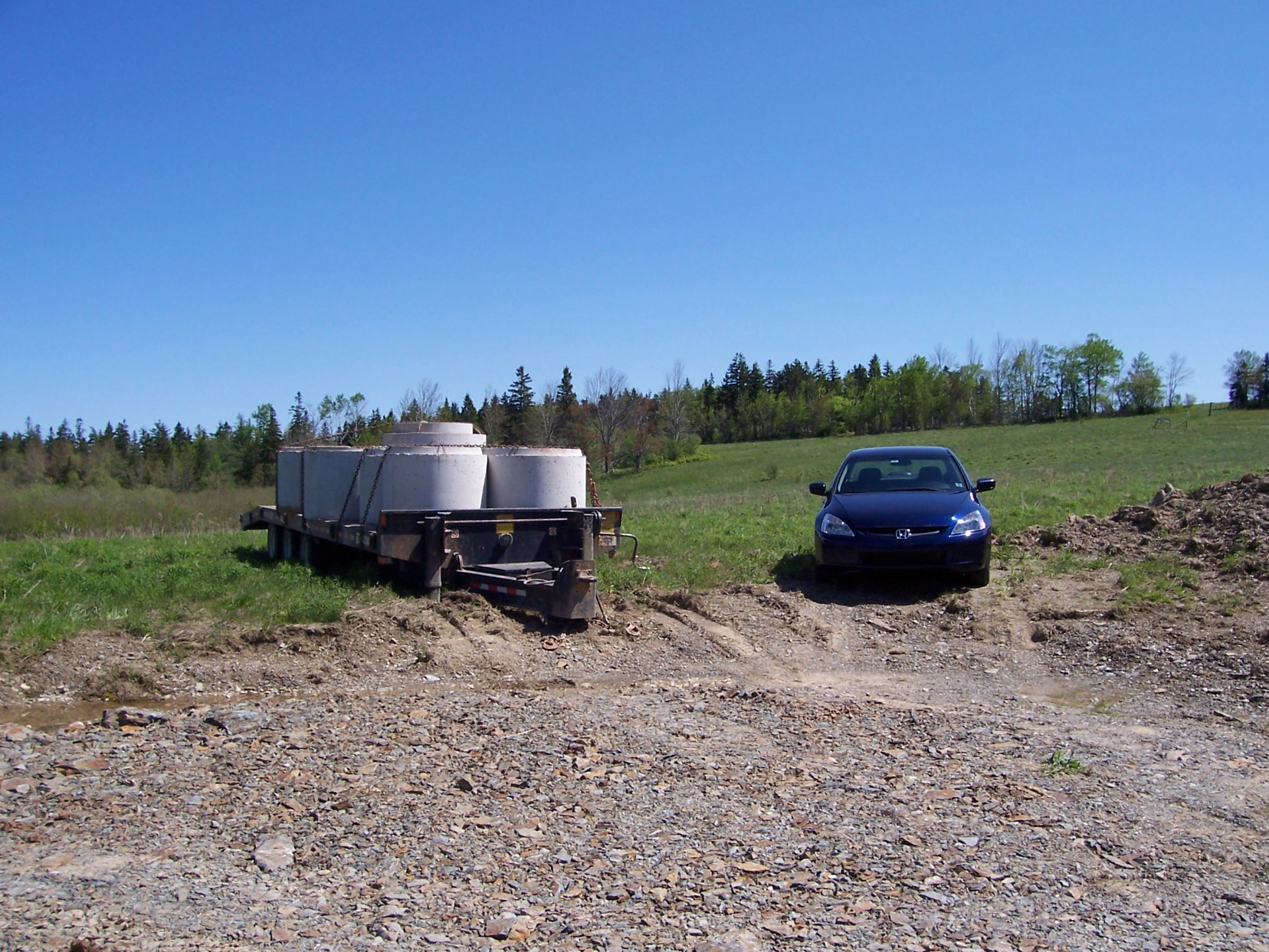

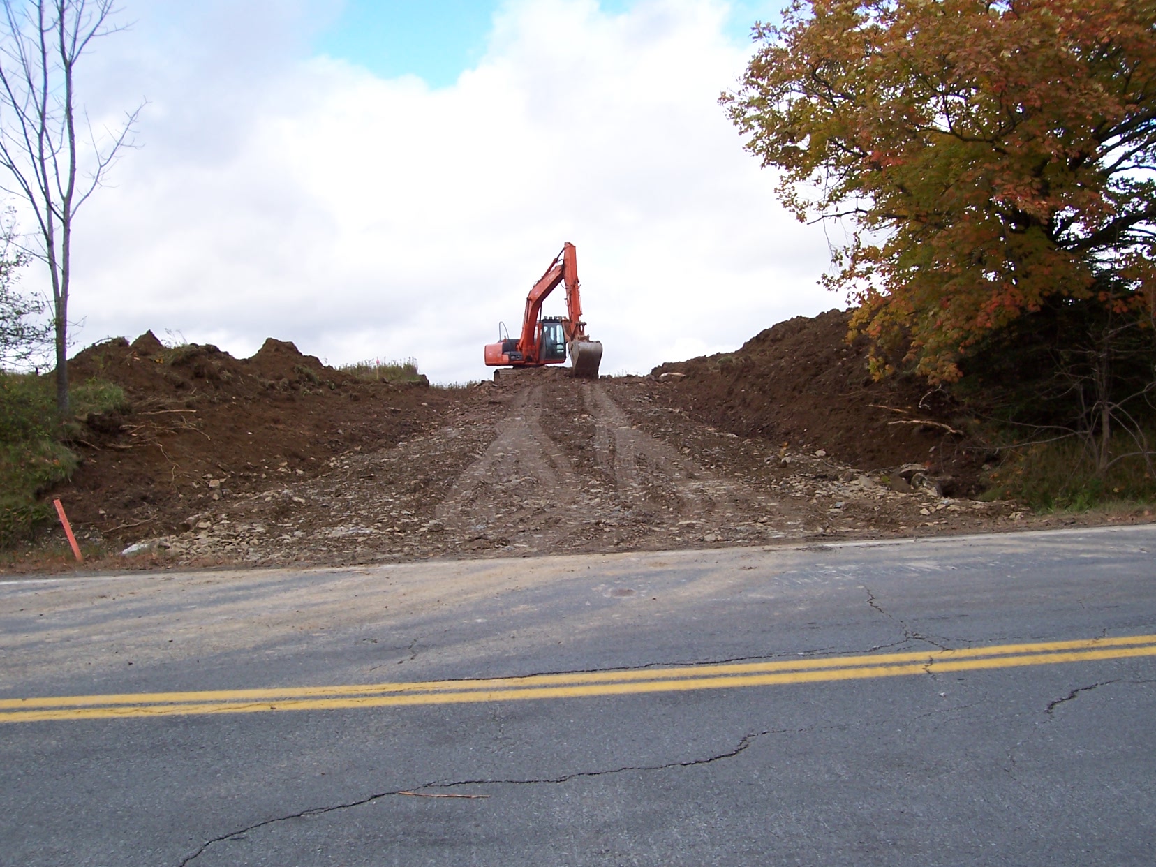

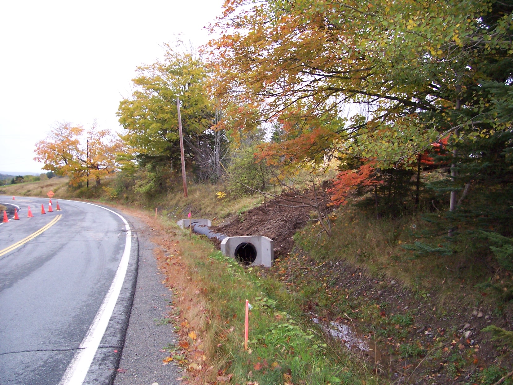

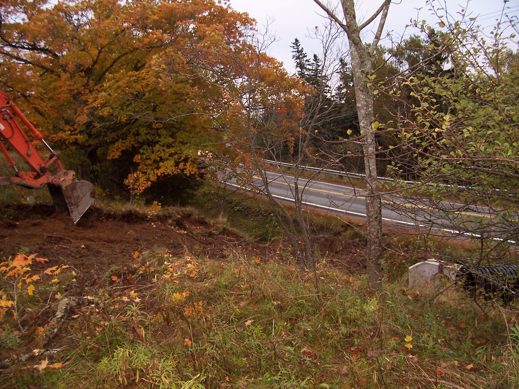

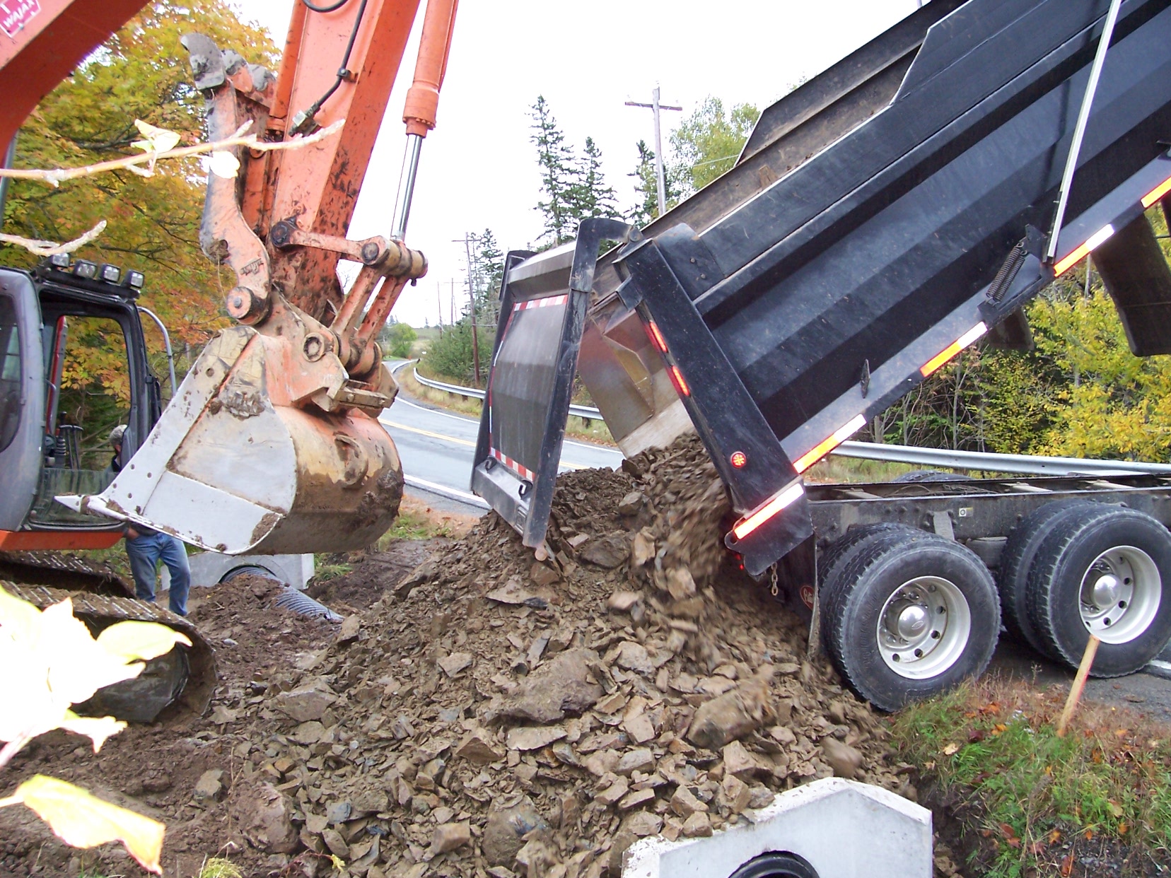

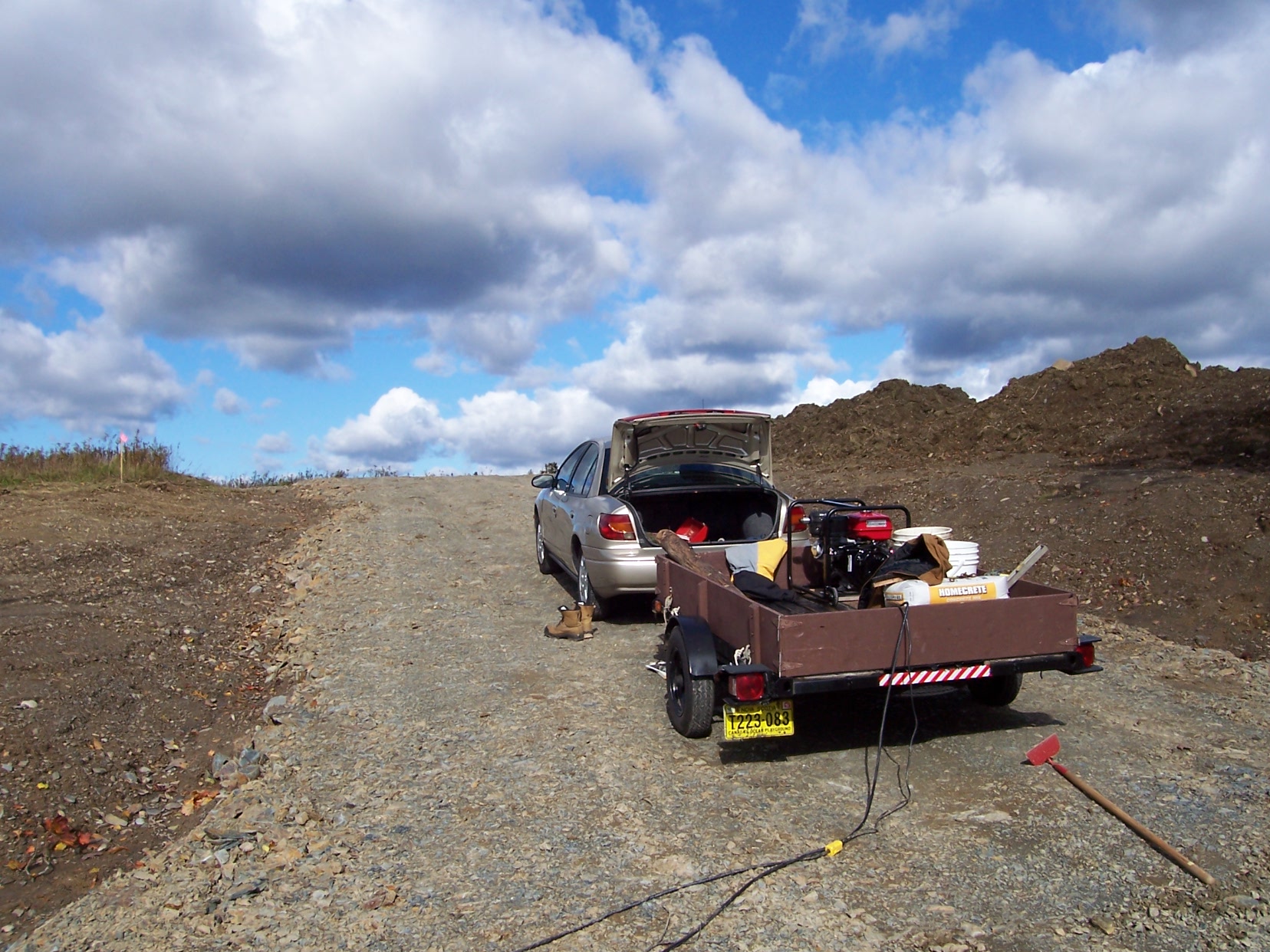

We put in a driveway a few years ago, the excavator operator dug out at least a foot or two of topsoil and clay, then built it back up with what we call pit-run rock, which is a mix of rock up to 6 inch, fines, smaller shards of rock, etc.
Hauling locally, it wasn't expensive. Including excavator time and culverts with concrete ends the whole driveway (250 feet) cost about $3500. More than I really wanted to spend at the time, but you can drive a concrete truck over it any day of the year you like without worrying about damage. We've since top dressed it with class A gravel, 3/4" rock plus fines
Ours is 30 feet wide at the road and narrows toward the top.
