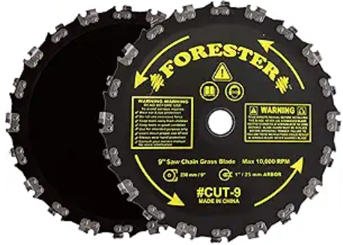

I don't own a Combi Tool, but do own their FS250 and use it often with a saw blade on it - mainly for cutting Buchthorn (an invasive tree that I'm overrun with.) Before that, I owned a similar Jonsered brush cutting saw for many years (until I lent it to a friend who straight-gassed it.) I much prefer the Chisel tooth blade (or the similar Maxi blade sold by other manufacturers) to the one that looks like a circular chainsaw wheel. The chisel or Maxi cut more efficiently.
I use the Forester circular chainsaw wheel on my Stihl Kombis...fwiw - I have the Stihl Kombi KM130R and KM131R models; also use a wire brush for patio and wall work - I saw some posts in this thread about windows breaking while kicking up stones with wire brushes -- misery loves company:)

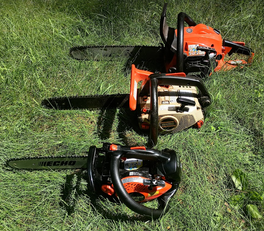

These are my trail saws.
The CS-2511TN is my show pony. Still too new to get down and dirty and put it in the dirt cutting stumps off at ground level. It is crazy light (5.2 lbs) and will get an Egan Performance Pipe once it's broken in.
The CS-4910 is a modded saw, a cutting demon, and my thoroughbred. It makes short work of multiple cuts in large wood.
The CS-3400 is a cheap, older, reed valve, top handle saw, and is my workhorse. It has a 14" bar and a chisel chain and cuts fast enough. More of my time is spent walking and tossing brush. This saw is light, easy to carry, and cuts well. I find myself using it 90% of the time.
My younger self used to chase horsepower (I also have a Husqvarna 562 XP and 572 XP, both with modded mufflers), but I find I can do more trail work and be less tired at the end of the day with a lighter saw.
I borrow my friend's Polan Pro pole saw to trim the overhanging branches, but have little use for that anymore.
How do you keep them sharp?
   / trail clearing technique and tools #1,325
Same way you sharpen a chainsaw.
Not difficult to sharpen, but for my uses, other styles of blades work much more efficiently. I don't see a lot of those Forester-type blades used by guys who use clearing saws professionally.
We'd be spending more time at filing than brush cutting. :LOL:

String won't last long trying to cut grape vines and small saplings where chain saw blades will zip through them in one pass. Chain saw blades aren't the best choice for cutting grass where there are hidden rocks. Neither chain saw blades nor string are the best choice when dealing with a briar patch that needs to be mulched to pieces.

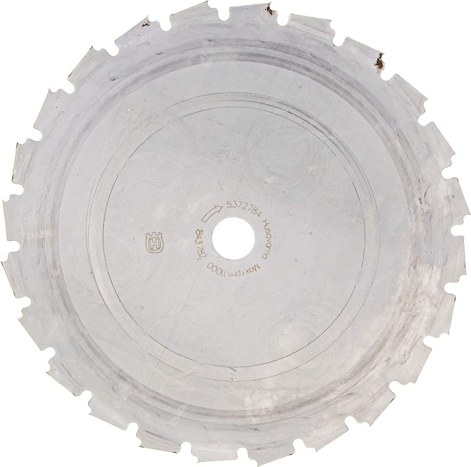

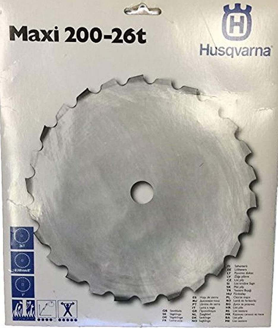

When you are doing thinning - cutting saplings up to a couple of inches in diameter(or more, depending on the clearing saw you are using), there really is not another choice. The metal 3 armed blade won't make through saplings this size, and a string trimmer wont do much more than strip the bark. Something like the Forester blade or the blades that look more like a circular saw are the options for that. Chainsaw blades rob a lot of power. I find the "circular saw"-looking blades a better choice, IF you get a good quality one. Husqvarna and Oregon sell some of the Maxi style (made in Sweden). I suspect others sell them as well - probably all made in the same factory and relabeled. They good quality, hold up well (if you keep them out of the dirt and rocks), and easy to sharpen.

sharpening the chainsaw wheels is a PIA - I usually run them until they die.
I found it no different than sharpening a chainsaw. The Maxi blades are a bit quicker to sharpen.
