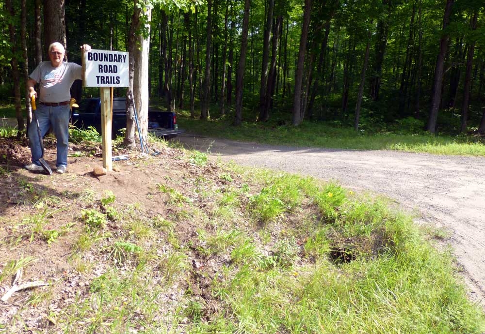

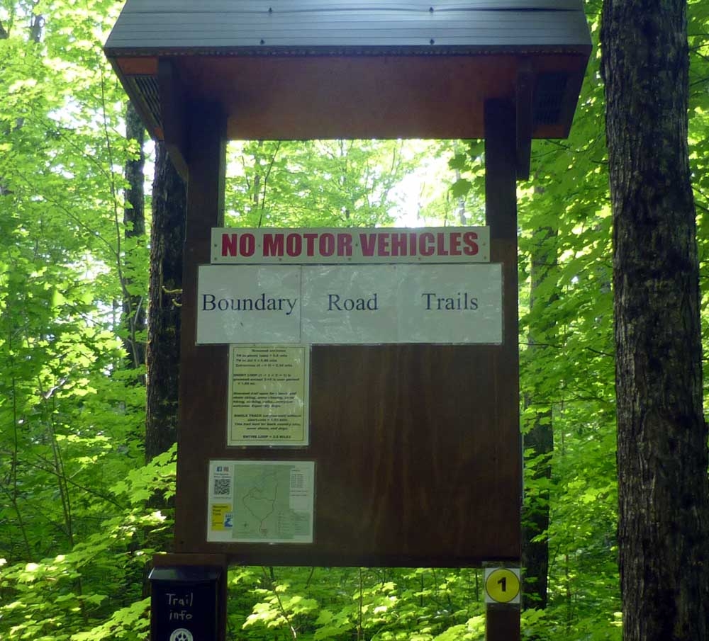

New signage put up at BRT's today.
   / trail clearing technique and tools #1,342
I like your covered kiosk
   / trail clearing technique and tools #1,343
First picture reminds me of the first time I tried to catch a mole. 🙃

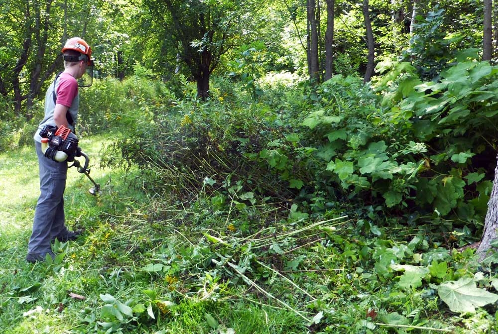

We spent 1/2 a day clearing a portion of the NCT on Sunday. I've had grief with my Echo heads holding onto string but seems I fixed it. Whacked for about three hours before a string broke and all got replaced then. 155 string rocks at this job. You can't see them but there are maple shoots in here.

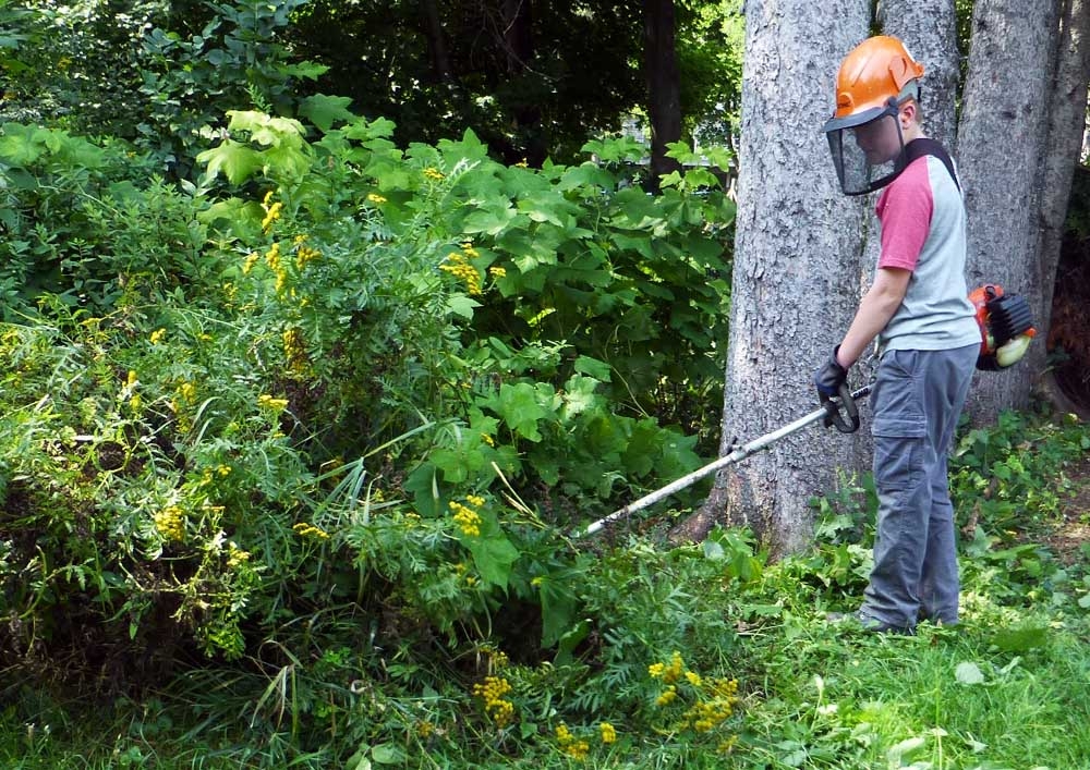

We will be camping over the weekend and working on a connector trail to the NCT. Its quite a drive from town to it but the camp site is 1/2 way there. We did this the past weekend but I managed to not bring a camera card along. (no, I don't like using my phone) This photo was taken years ago in the same area.
