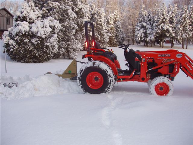

B3030!!! I am biased because I own one. It will do it all. It has the extras that, to me, are necessities (modern looks, position control, telescoping lower links and sway bars on the 3PTH, foot operated tilt wheel that makes getting on and off the tractor much easier) that make owning and operating a tractor a pleasure. I mow with mine (60" MMM,) plow snow (6' RB) and do loader work. It is a snow plowing machine with turf tires. A 72" Rear Blade and the loader makes a good package for snow.
I do the same thing with mine for the 700+ ft driveway, but I have R4's. Do you find any disadvantage with the turf tires in snow? The R4's even break loose sometimes.

I haven't cleared more than 6" yet, but I run turfs without chains and don't have any problems at all. I use nothing but the FEL. A little inefficient, but I haven't gotten to rig anything else up. Once they get all clogged up with snow, I don't know that R4's would perform a whole lot different. Ag's, maybe. Chains, certainly.
Actually, I haven't had much of a reason at all to get anything other than turf's. They've really impressed me. Easy on the lawn, nice riding, and sufficient traction. If it wasn't 4WD, it'd be another story. But 4WD covers about all the bases. In 4W-High, I'll always bog the HST before I lose traction...same for 2W-High, most of the time.

I agree with Keith. The turfs do anything I ask of them except in mud. Only ags would be much better but I try to stay out of the mud if at all possible. For snow I don't think anything can beat the turfs. As an old farm boy I can attest that ags are useless on hard packed snow. The Titan Turfs I have are very much like aggressive all-season truck tires. Lots of rubber contacting the ground with plenty of biting edges. Sometimes I think they are even too aggressive on the lawn when it is wet and soft. Turfs for me.
