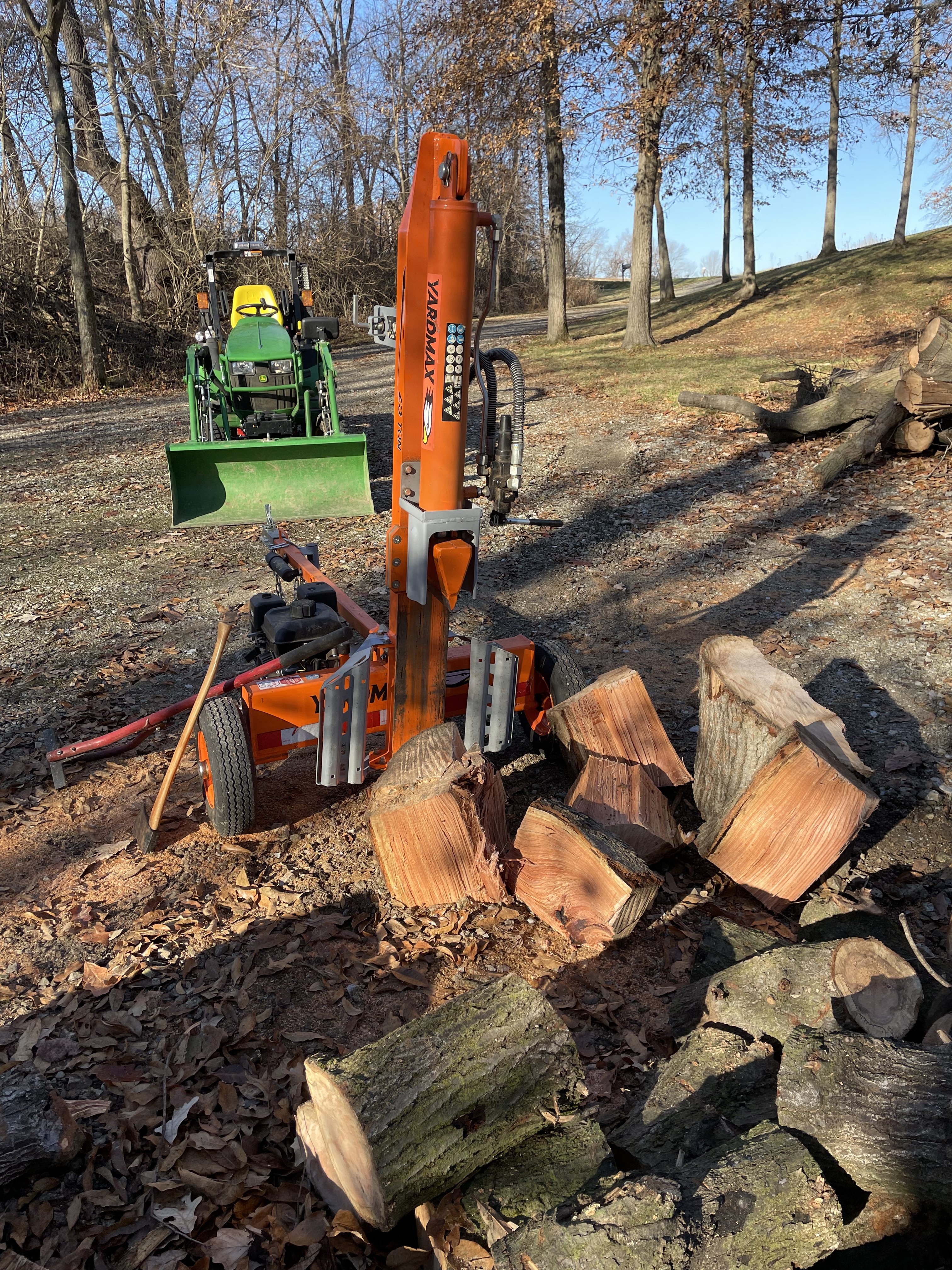

I have a question for those with wood splitting experience:
I just had some acreage timbered and the loggers, at my instruction, left the tops and trunks that had no value, for me to cut and split. I can only work a few hours per day when weather permits. Do I rent a splitter or buy one with the idea of reselling after the project is finished?
It's hard to estimate the number of days the project will take, and the days I can work will often be non consecutive. That means making a 45 minute drive to the rental yard on those days I need the splitter. I'm looking for a 30 ton horizontal / vertical model and no one around here offers long term leases.
Rough cost estimates for renting vs buying are a wash if I can get 70% of the cost back on a resale. From what I've seen on C.L. and Facebook marketplace, this is not unreasonable around here for a lightly used almost new splitter.
I also looked into hiring a contractor but no one around here does that type of work.
So... Do I rent or buy? If I buy, what type splitter would work best? I have a 60HP tractor with rear remotes but the low CFM would make for a slow cycle time on a 30 ton splitter. Splitters with a separate PTO pump are an option but cost more. Both would require the tractor to be running while splitting and not available for moving rounds or split wood. They are also harder to sell.
Self powered splitters seem to be more cost effective and much easier to sell. Any ideas or options I've missed?
Buy a used or new self powered, easy to sell.

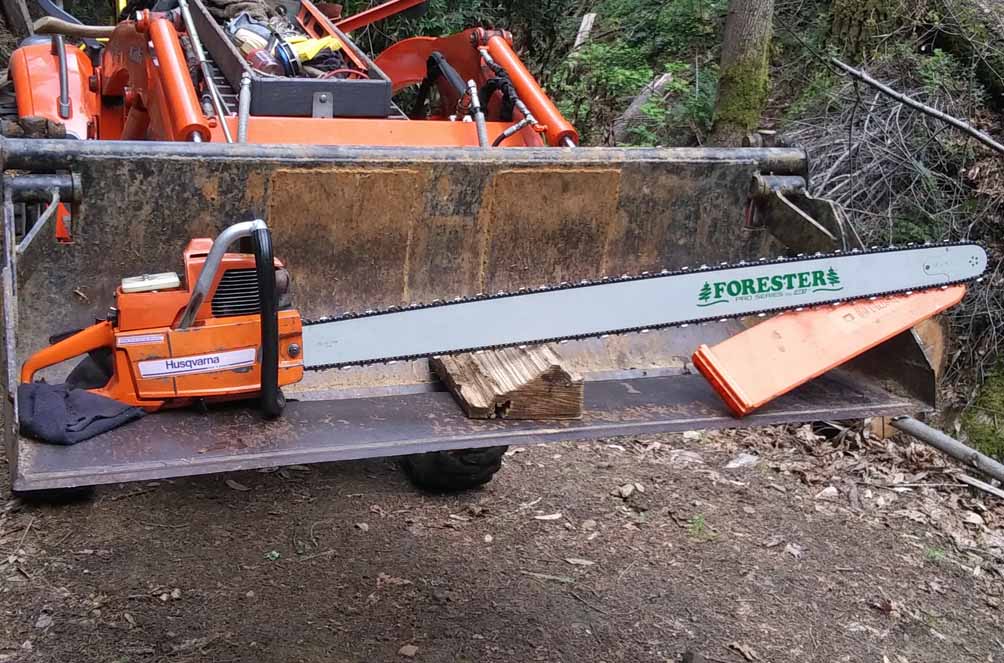

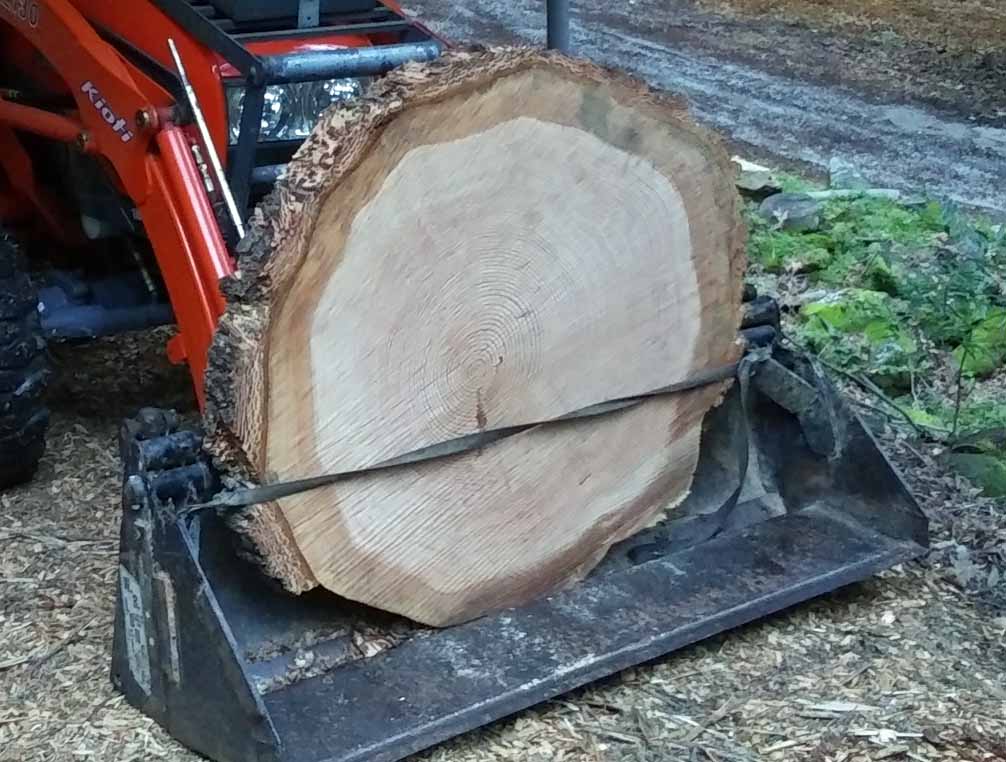

^^^ should have proof read. In my woods I could NOT use the tractor as a lift. To rough and too many trees.

Even more than that, my tractor is my log lift! I buck the rounds, roll them into the bucket, lift and park it right next to the infeed side of my splitter. This way, I can keep the splitter horizontal and move faster than I ever could with heavy rounds in vertical mode.
