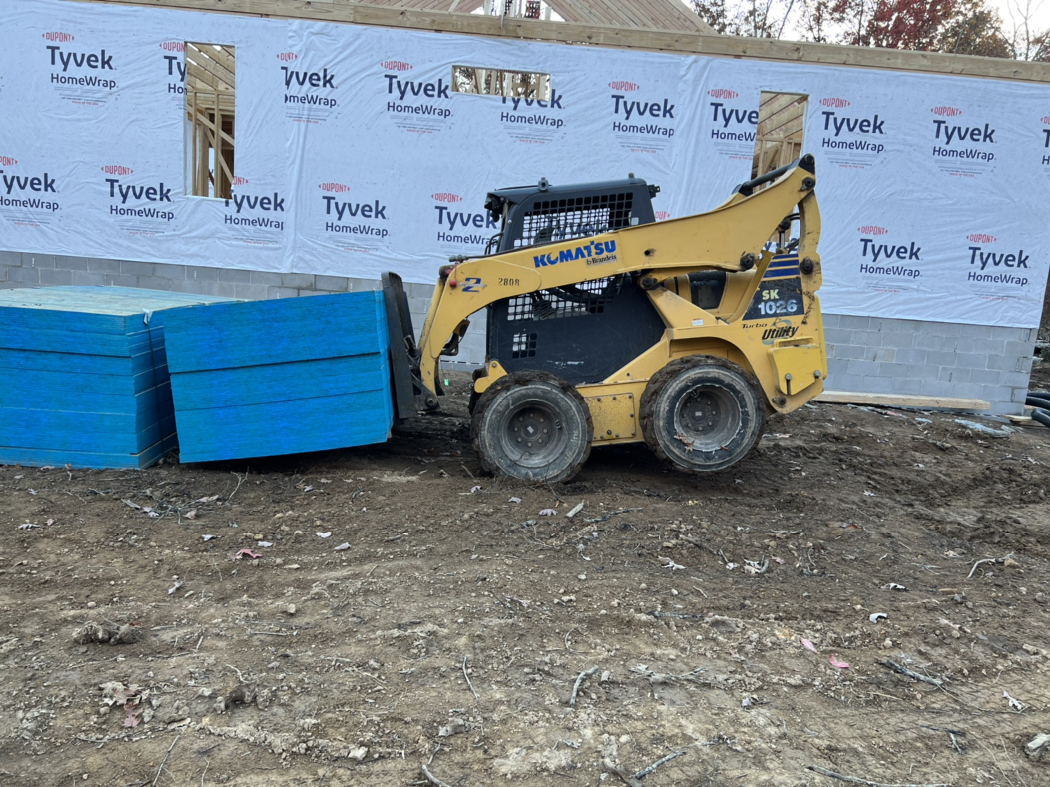

I’ll run my machine tipped up on the front wheels with the pallet dragging the ground because I can’t lift it all the way up. I bought them to work and if they live a hard life in the process I can live with that. They’re built tough and are pretty well designed to be beat on in the construction business. The M59 however really wasn’t designed for that kind of treatment. The skid steers and mini x are far tougher built than the M59 was.

I suspect the 1/3 or 50% derate from actual lift capacity has something to do with the dynamics of a machine in motion vs stationary operation.
It’s one thing to be able to lift something off the ground, and it’s another thing to be able to safely transport that load across who knows what terrain.
I unloaded a 58 bag pallet of ready mix concrete using my CTL, from my F450 last years. Getting it off was no issue, but it was a little dicey moving it across the yard. Low and slow is the way to go. I can see why the manufacturer would add some sort of safety factor to protect themselves. You’re probably not going to hurt the CTL in a forward tipping event, though. It’s injury that’s the concern.
