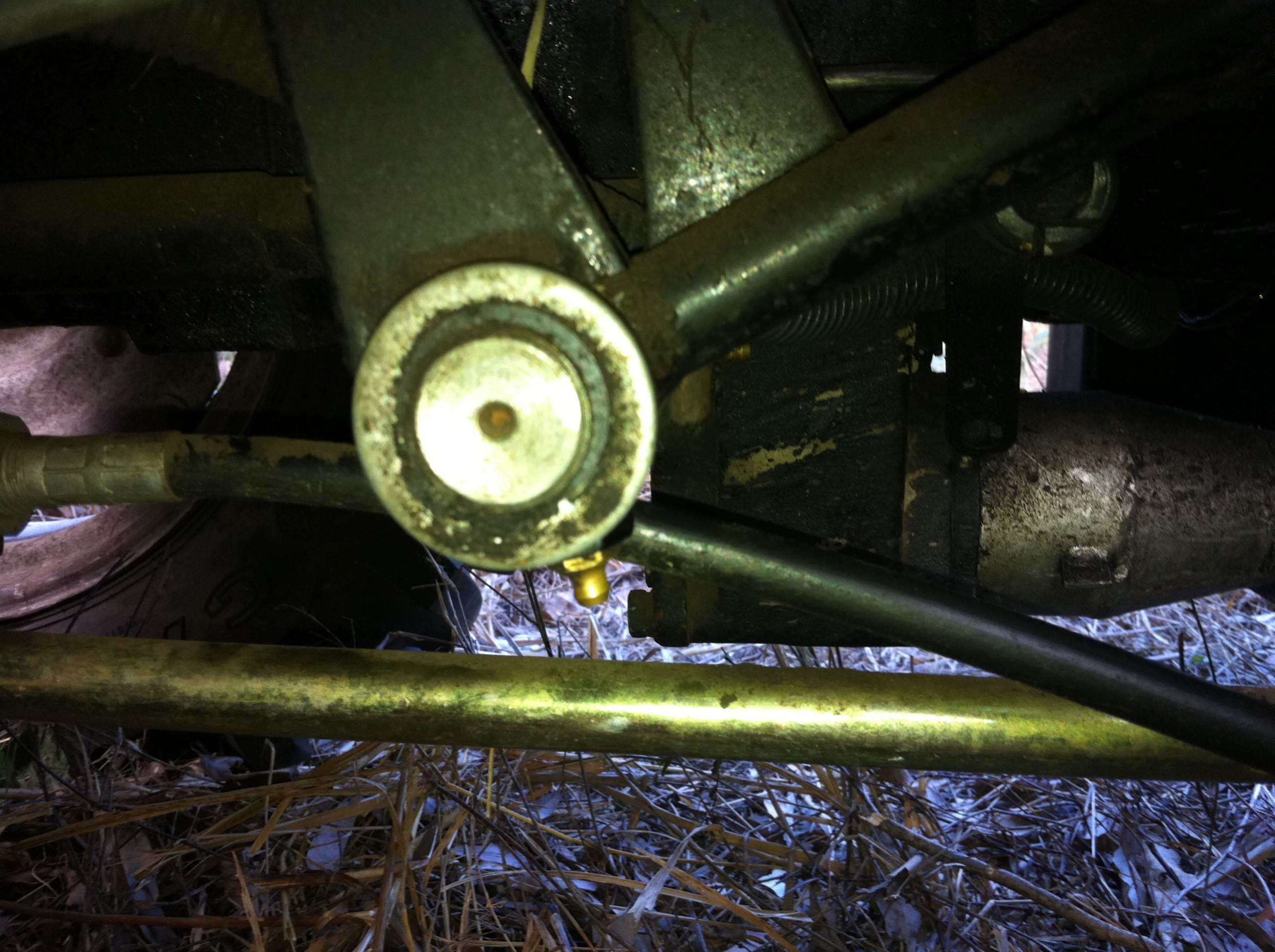

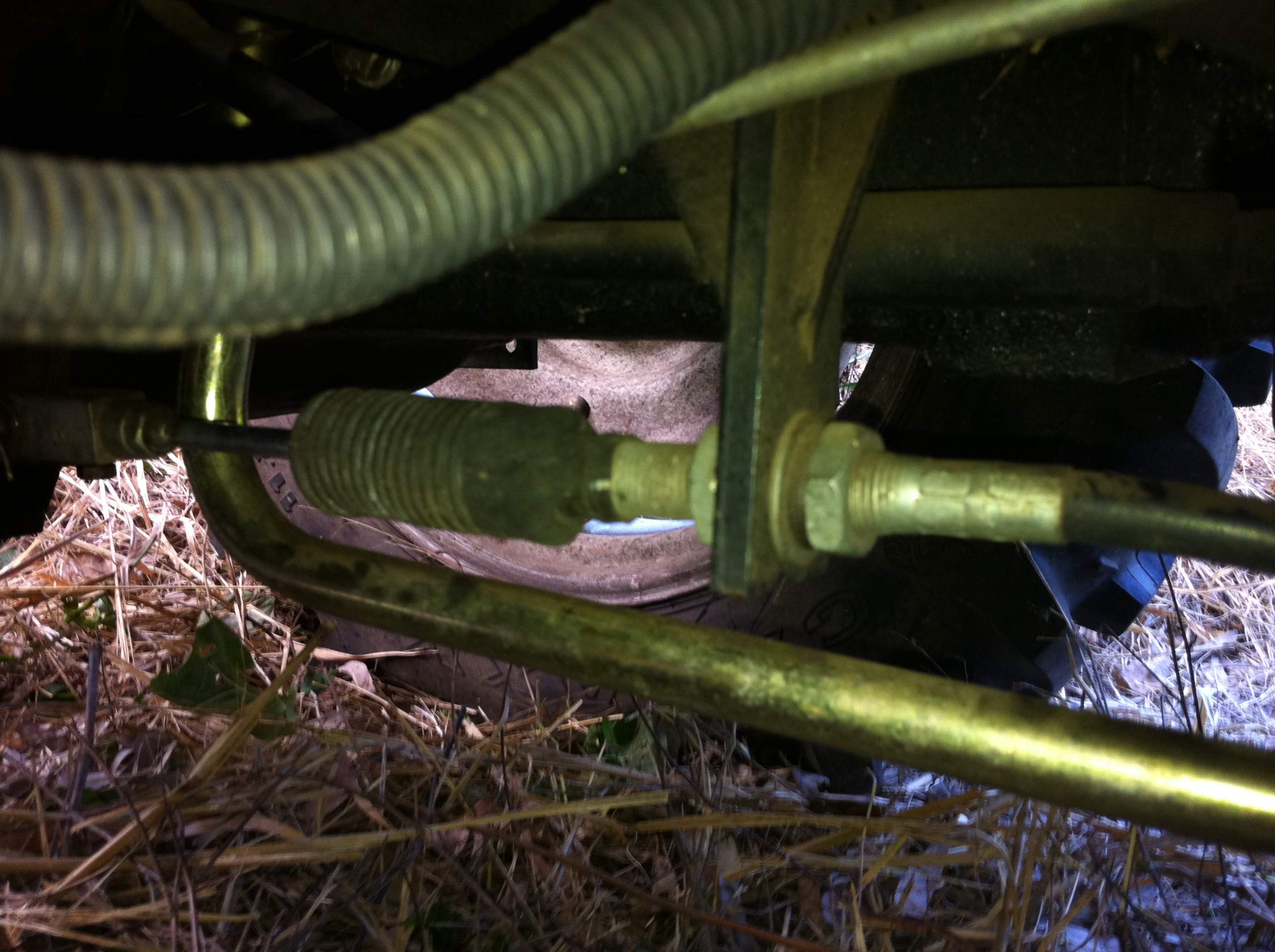

Hi Greg,
Thank you for your prompt response.
I have attached a couple of pictures to assist in this regard.
Just to start, we were thinking the pins were in picture 17, is this correct?
Sorry but best make sure we are checking the right pins, are they under the plastic sleeve?
Thanks again,
Justin

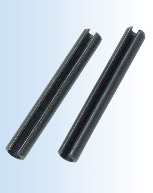

I get the impression that you took photos of the split pins. What I was referring to was the roll pin or pins at one or both ends of the shuttle shift cable. This thread may help as well. But if yours is not actually fixed with roll pins, I apologize for the misdirection.

I don't think you are looking at the place Greg is refering to(none of yor pics showed it anyway). Should be on the right side of the gearbox, down near the brake pedal, right about floorboard level. The linkage moved by the shuttle shift cable rushes/pulls on a bellcrank that is pinned to a shaft that passes thru the shuttle case side cover. That bellcrank is pinned to the shaft with a rollpin like Greg pictured. If you work the lever, and the bellcrank moves, but the shaft in the center dosn't move, the pin is sheared.
If that center shaft that passes thru the shuttle case cover IS rotating with the bellcrank, the problem most likley is inside, and you will have to remove the floorboard and that creeper side case cover. Inside, the other end of that rod moves a cam/lever like device that slides a rod and shift fork to move the gear from forward to reverse. It could be that that inner cam has sheared it's pin, and the shaft is rotating but the cam/lever inside is not. Here are some inside pics of both the creeper and shuttle transmission, provided by one of our fine parts dealers here.
