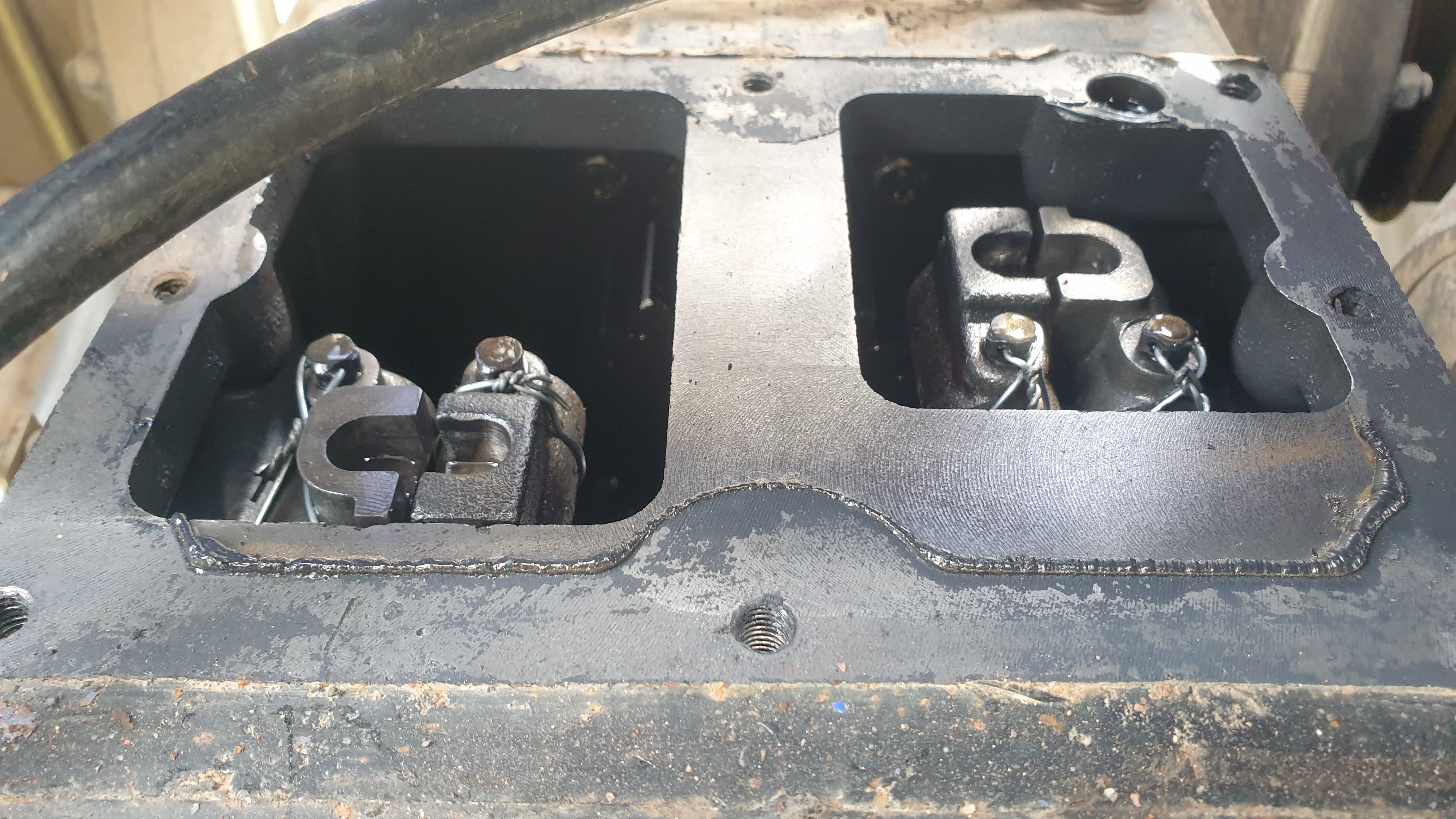

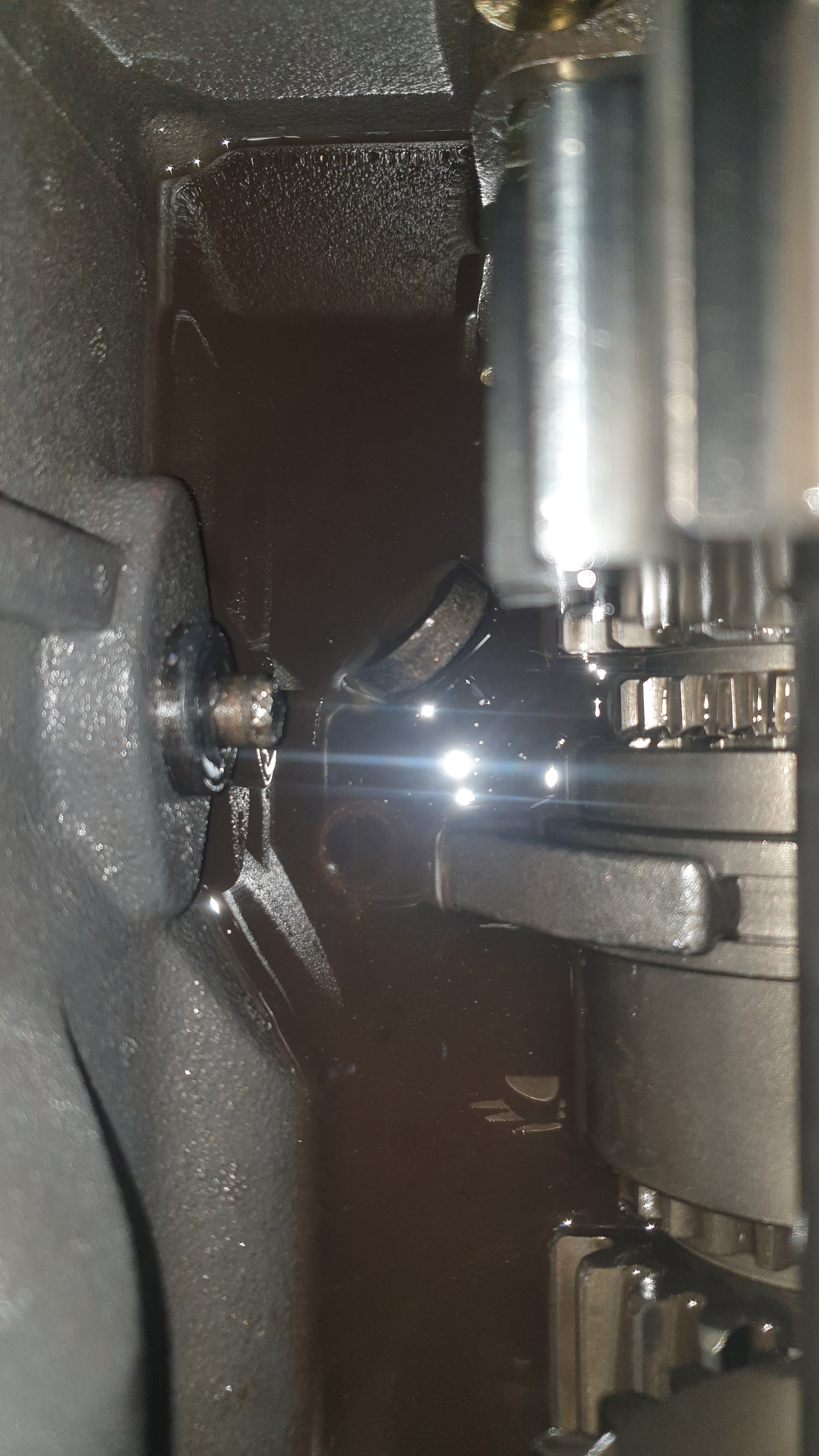

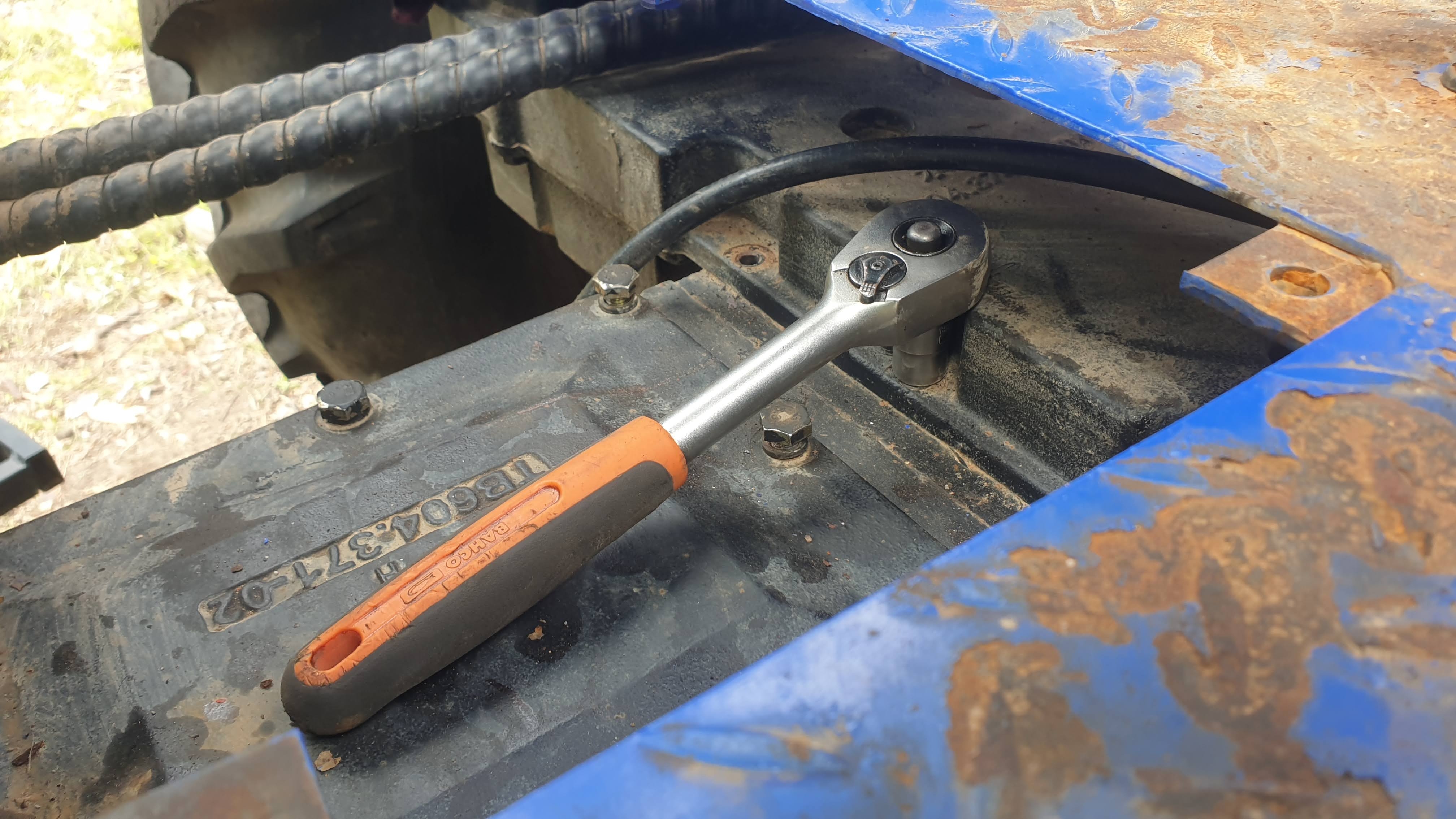

I'm going through this right now with a Trident 554.
Shuttle shift went sloppy and stopped shifting. On this tractor it is operated by a bowden cable like a bicycle brake or similar. The cable linkage runs down to the right side of the transmission case area.
I was hopeful for a broken roll pin but in this case it was a broken shift fork.
I had a floor access panel under the rubber mat flooring that was helpful though not directly over the shuttle shift fork.
It looks simple enough to repair but I do have some questions if anyone is familiar with this part.

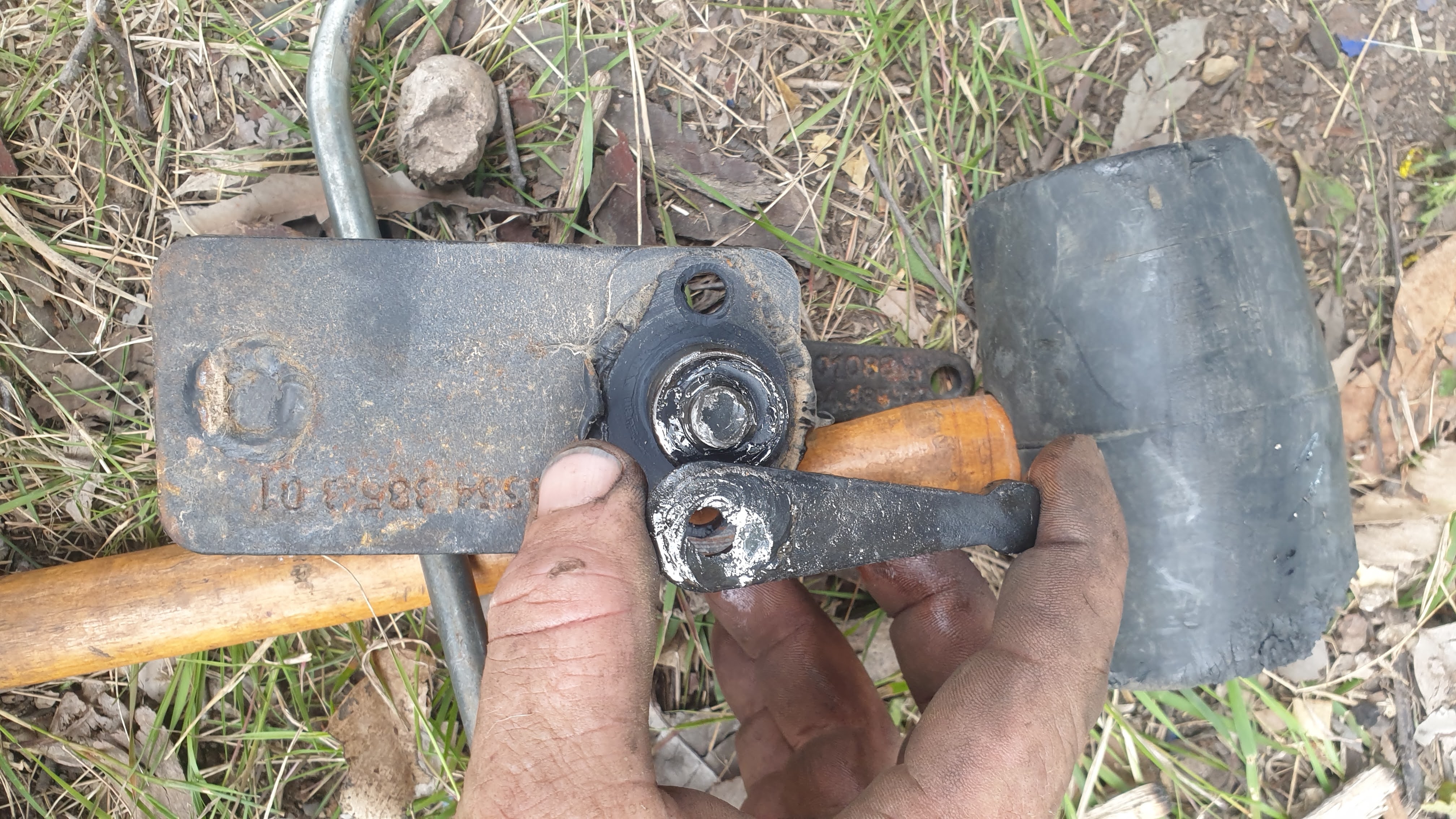

/ Shuttle Shift Broken #9
Looks like the weld broke. Maybe you can figure out about where it should be based on the markings of the original welds. If so then weld it up and put it back in and adjust it. Doesn't look too bad to me. And it's not precision fit ! It's Chinesium !

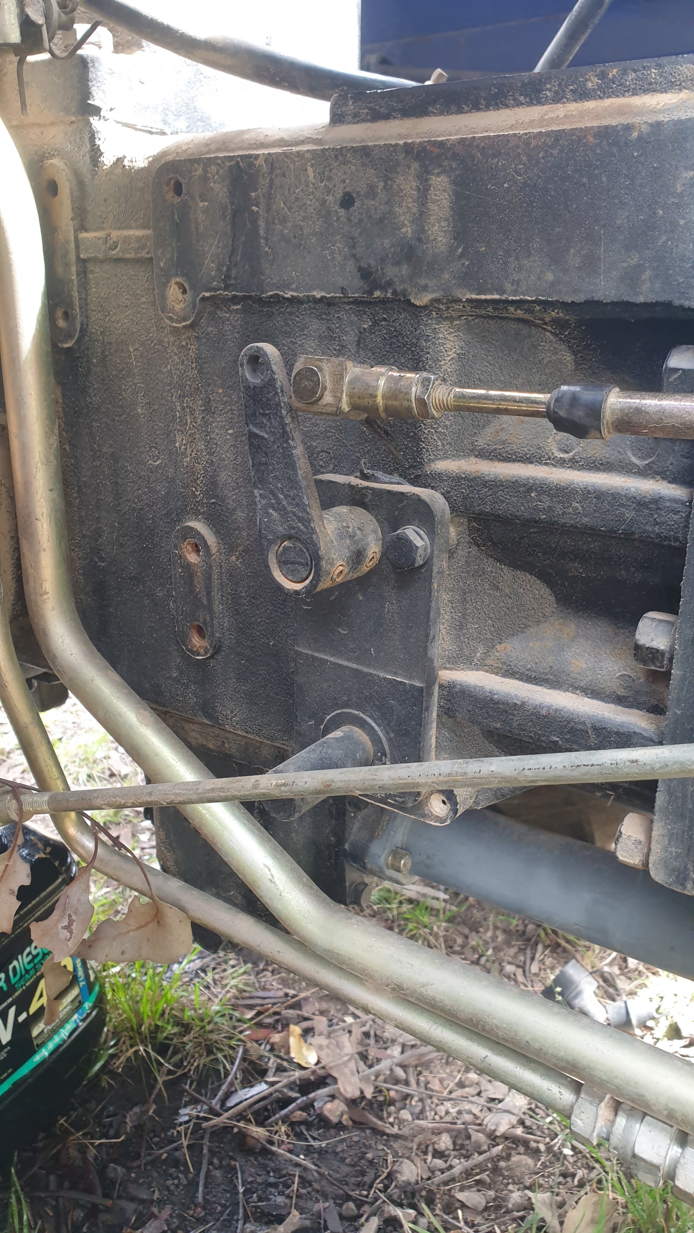

Looks quite similar to my set up except I don't have a cable. It's a solid linkage or two from the shifter to the trans.
Your access looks similar too, although it's hard to tell on mine because the cab floor is limiting the view from underneath, and
there is pretty much no view from above. I took the seat out and I can see a little bit if I crank my head the right way.
I'm really hoping mine is not a broken shift fork. More than hoping.... I'm almost pleading.
Yes, it is very easy to see how it was together and to line it up as it was. It's a simple weld job to put it back as was but I'm hoping some further info I can make it better. I suspect it was not properly aligned and that was causing shifting issues and contributed to the weld breaking in the first place.

Don't stress about it. Can you share some pictures of up under the skirt of your tractor? If the linkage for the shuttle shift going in to the case is similar I might be able to give you some tips.
