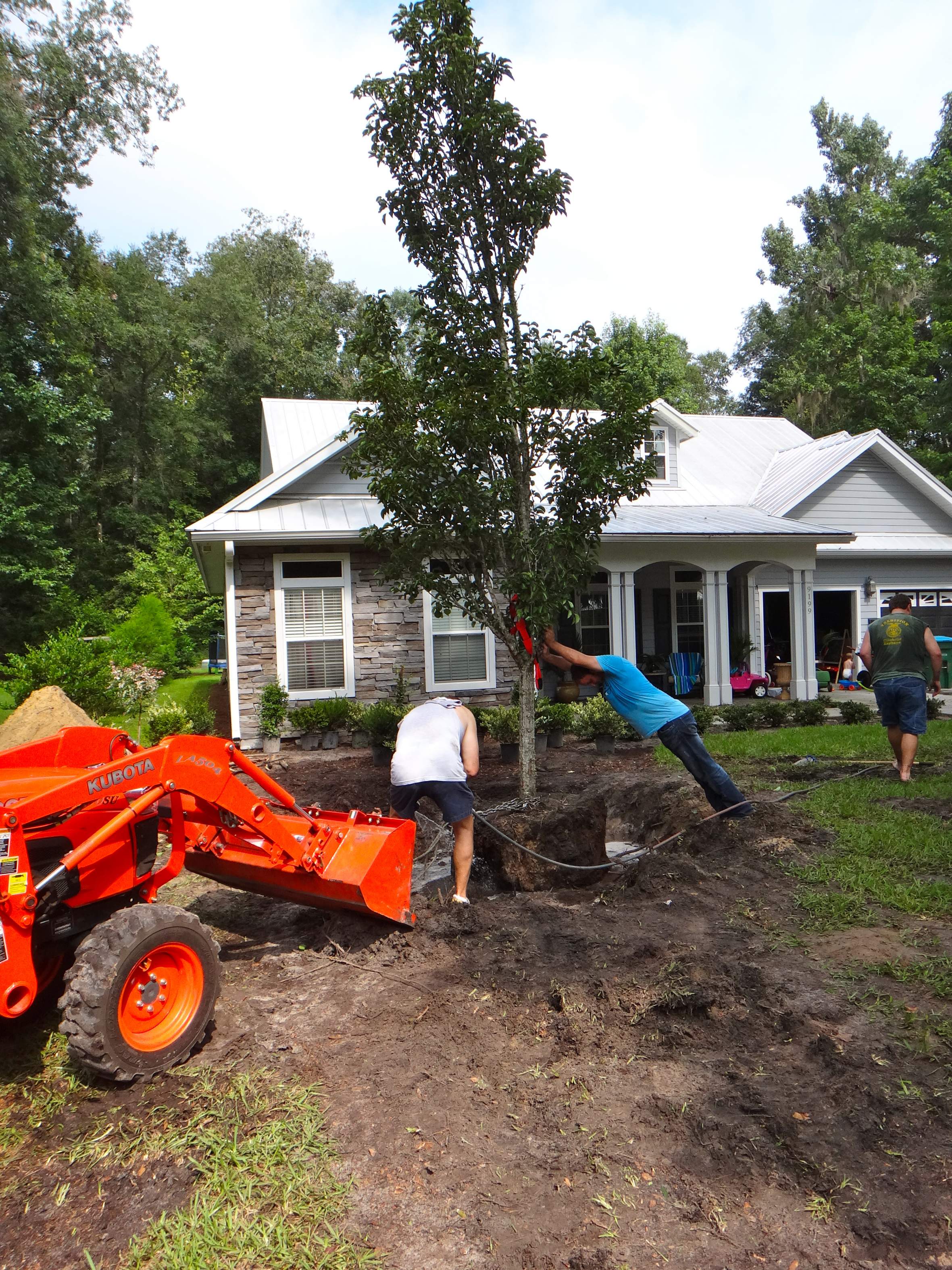

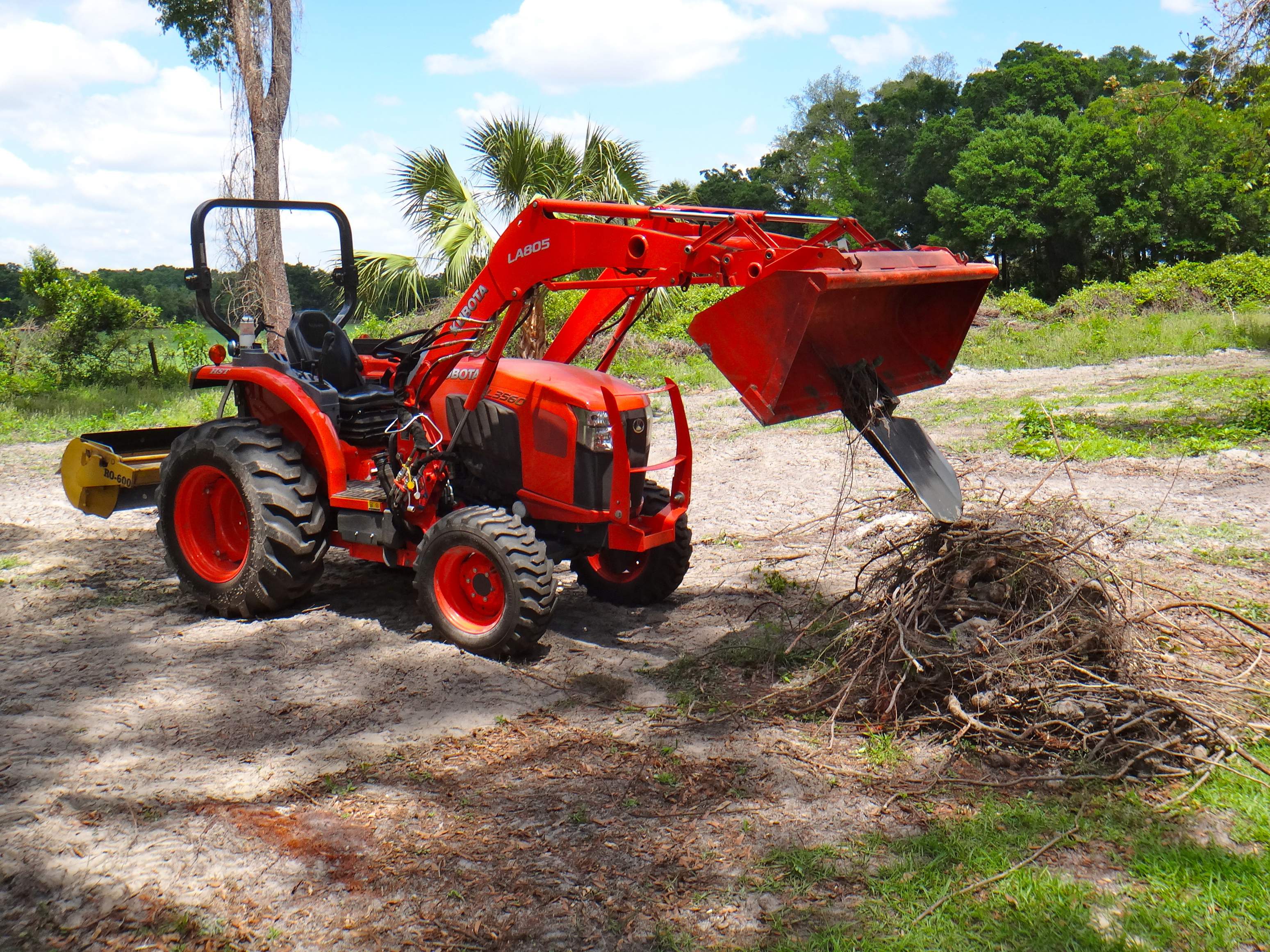

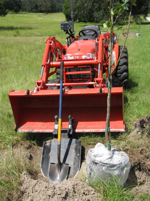

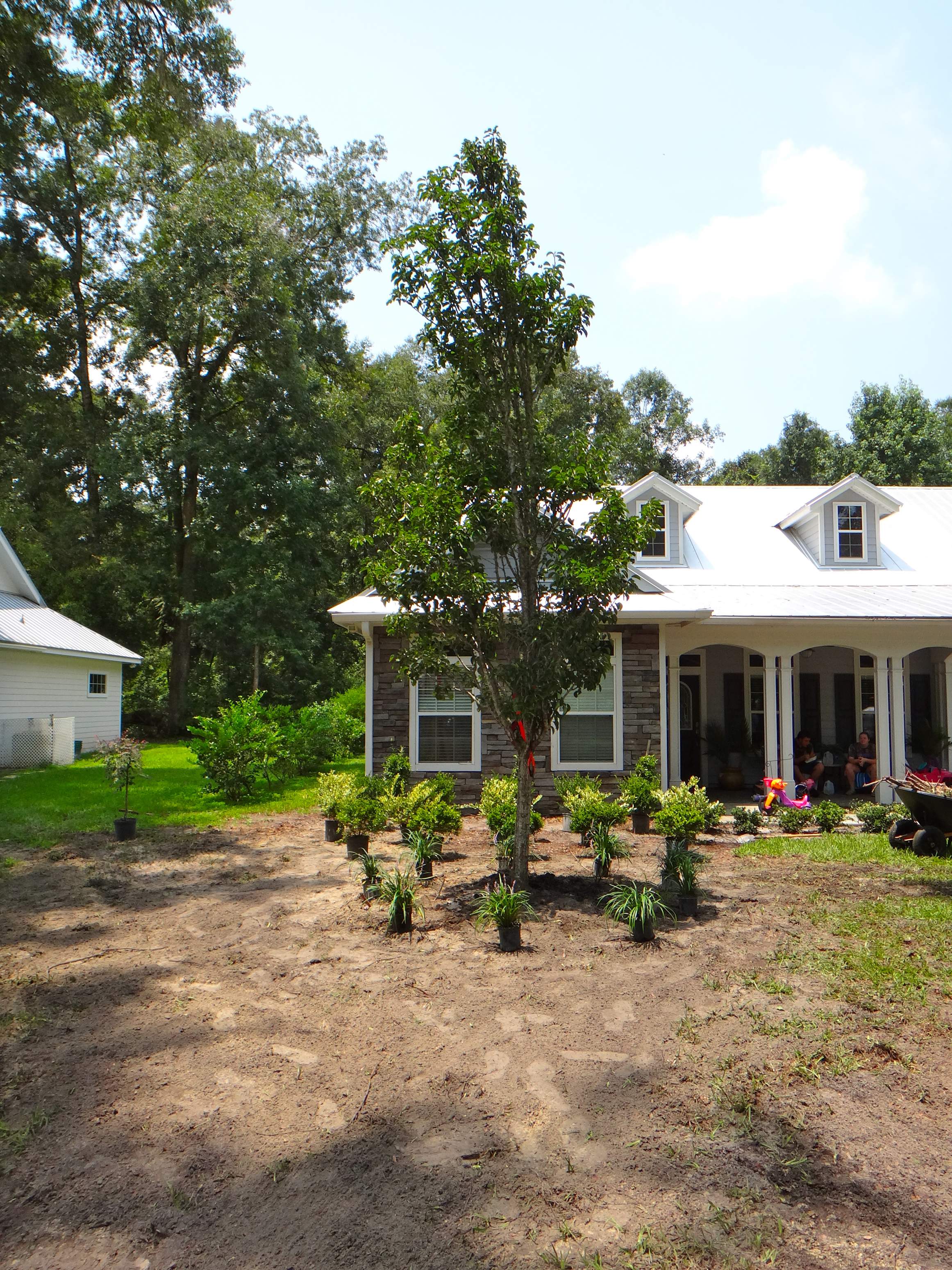

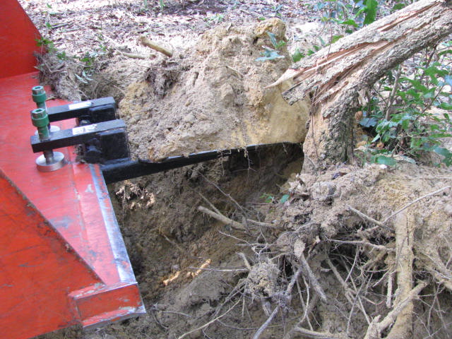

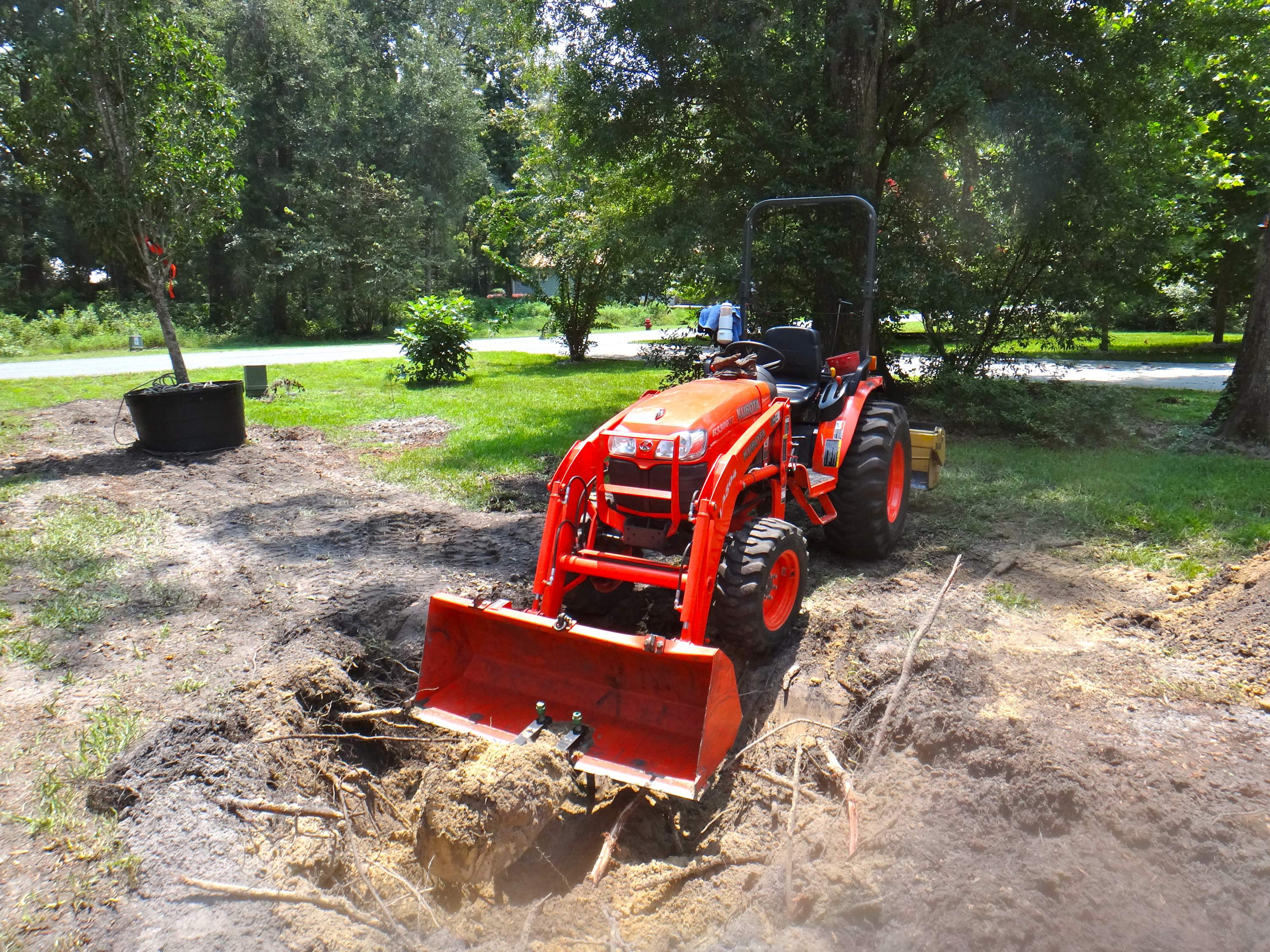

/ tractor sizing question #8

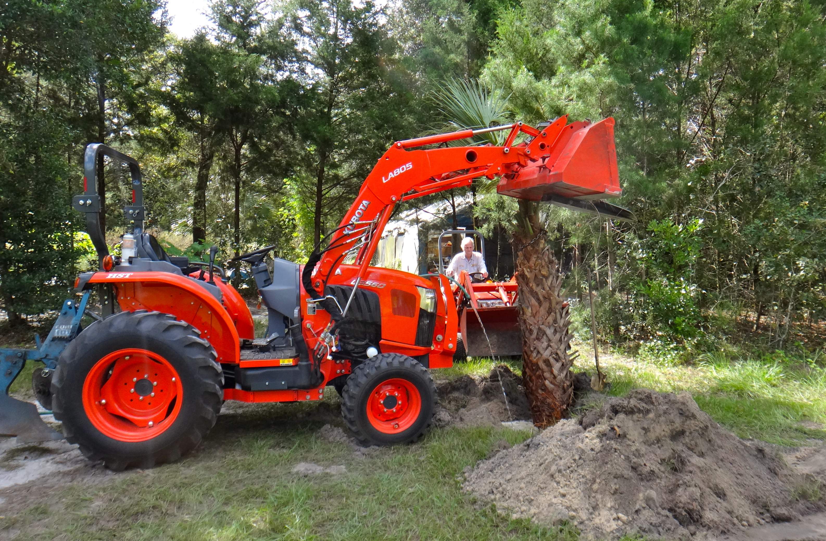

I recommend a Bucket Spade for orchard and tree planting.
LINK: Tractor and Skidsteer bucket spade shovel
That is probably OK for your sandy loam soil, but I sure wouldn't use it at my place, at least not with it attached to the FEL bucket like that. My brother in law had a hay spear like that is it sure would bend the lip on the FEL bucket. We ordered a quick attach plate from EA and then mounted a rear hay spear on it and it made for much heavier lifts. I think I would do the same for you spade. I thing the QA plate was less than $150 but was well worth the effort for modifying the hay spear.
