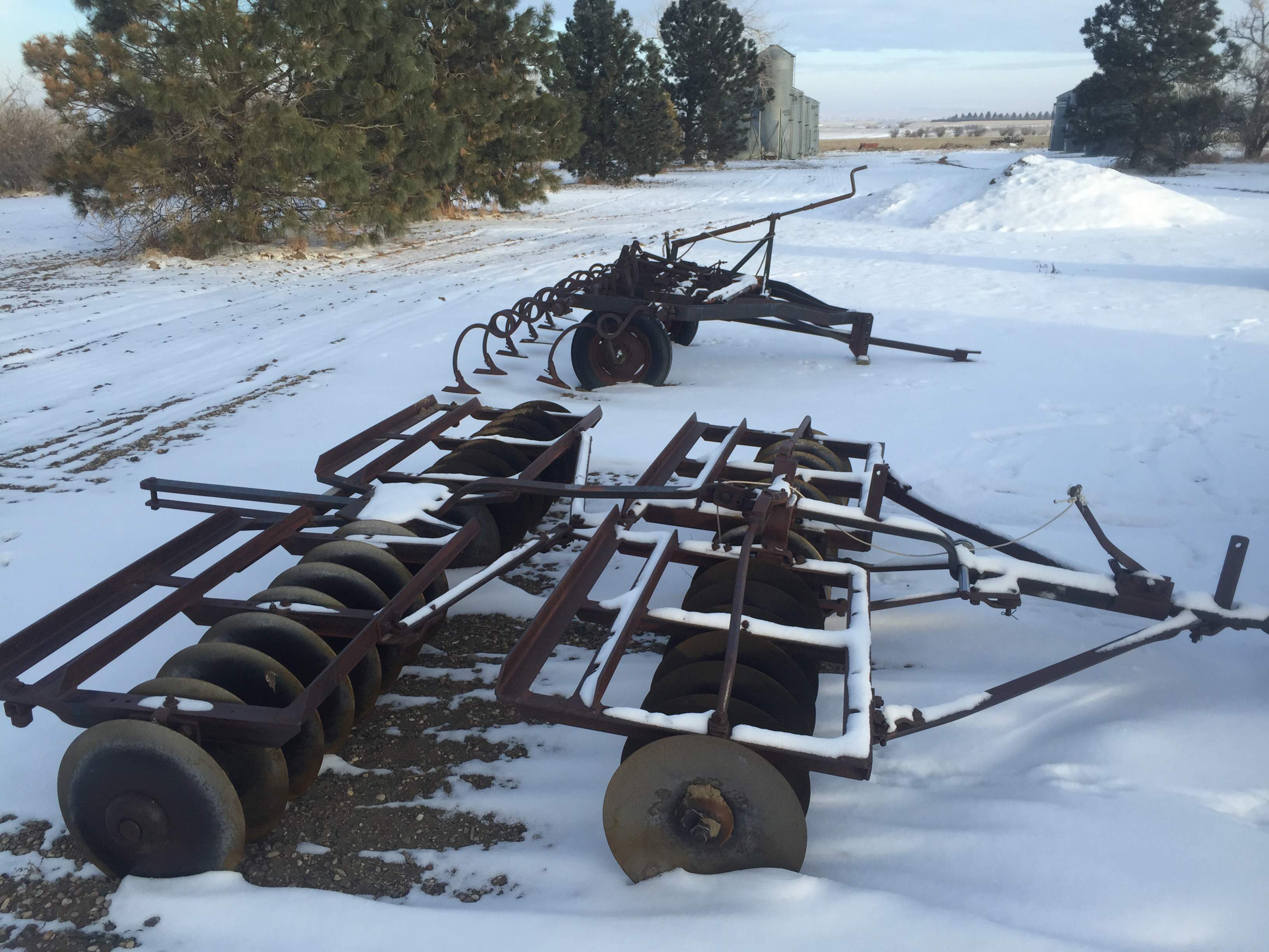

Welcome to TBN. To pull either of the two implements I would recommend 4WD and at least 75 engine hp. Both of those implements are fairly good sized. It would probably be more economical to drop down to 50 hp/4WD and properly sized implements. You could sell both of those implements and use the money on the new tractor and implements.
Good advice.
You can go to 50hp but get 4wd as well. YOu can try those implements...remove a few disks and shanks..and dig less deeply into the ground to adapt the implements to your tractor and needs. You likely will go to newer implements over time.
HST is your friend, wife will love it as well...just get it...it is safer, tough and reliable.

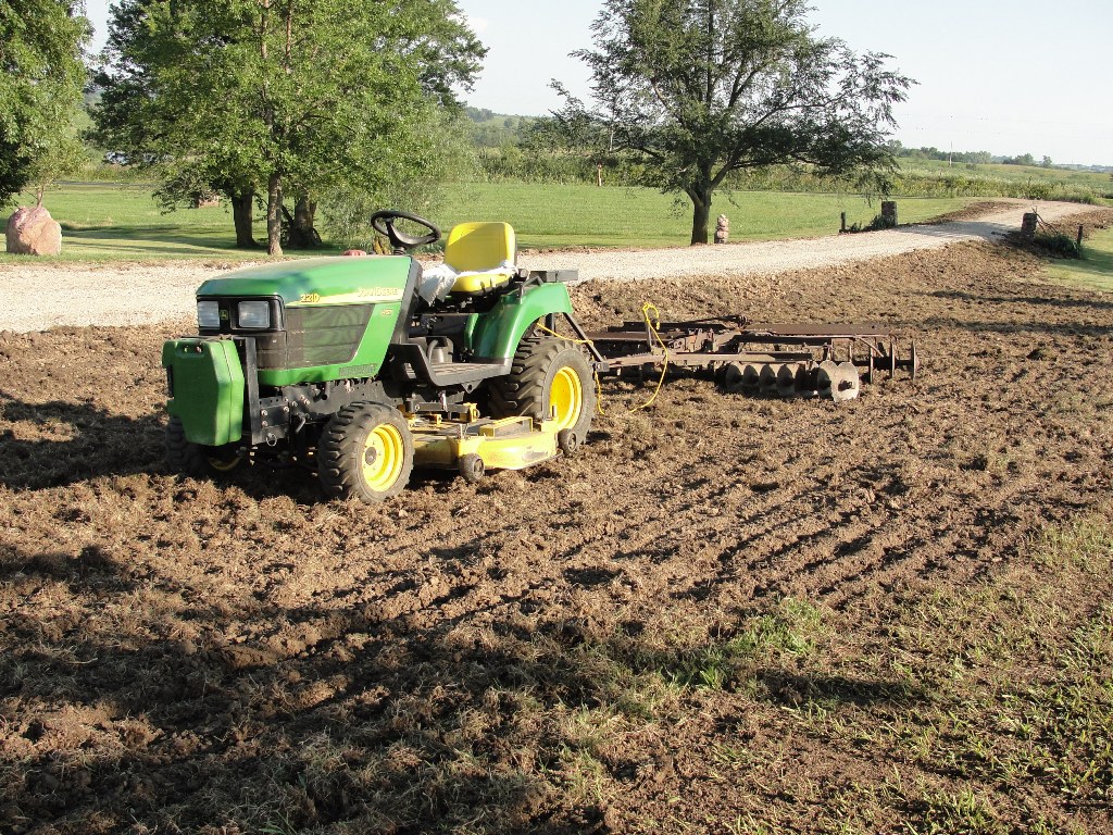

37 acres is not a huge tract. Lots of people around here farmed with a 35hp 2wd tractor. You would need at least that much, but 75 horsepower is overkill in my opinion. A hydro saps a bit of power but too big can make your tractor harder to manage. Take a look at a Kioti DK45se hydro.
I'm the guy that usually says "buy big". But in this case, I'm with you MM. A small CUT 30-40HP tractor will do everything needed on this property.
I think you'll get a lot more personal satisfaction out of improving your property with a small tractor, taking longer to do it, than you will with a large tractor, doing it fast, and making a big payment.
As for the disc pictured. Check out picture.
