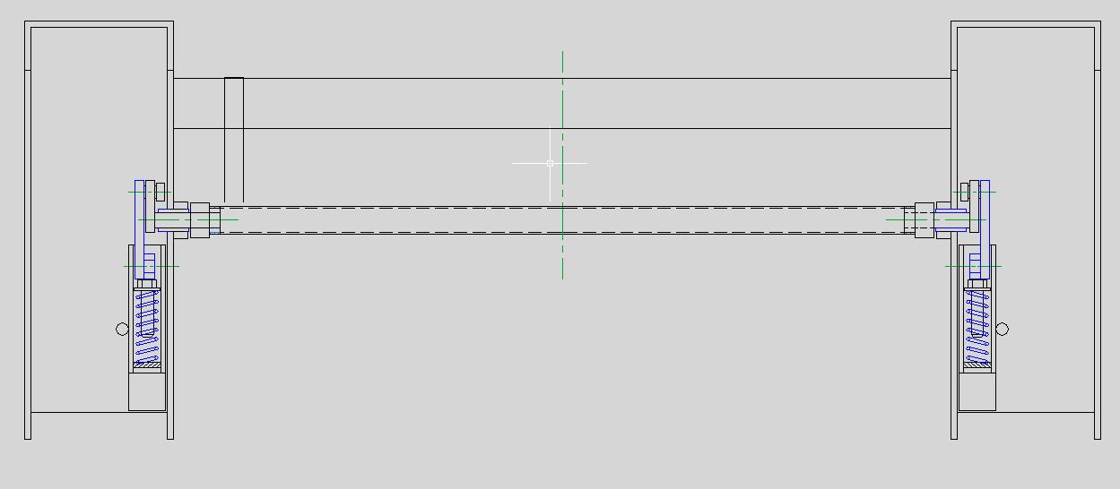

I have been working on this for a while and recently started the actual fabrication work. I have a Montana with their style of QA (sliding pins) and it works ok but I find that it makes a sloppy connection. It's also not compatable with any others.
My dad also recently purchased a 'bota L3400 with the crappy 3ph ;)and a pinned-on bucket - they don't have a QA for his loader. I looked at the aftermarket SS adapters but I don't like how far the push the bucket out; this would not be too big of a deal on the Montana (because it already has a QA) but the already marginal L3400 loader would loose to much lift, etc. I decided that I would design and build my own.

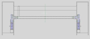

My design is based around the following:
1. Has to be simple - use standard materials available with no special tools required ('normal' people don't have mills, surface grinders, etc :D)
2. The basic form of the SS assembly and lock mechanism has to be compatible or easily adapted to any loader configuration (width) for compact tractors (probably 25 to 50 hp).
3. Light weight
4. Only one release handle is needed to operate both lock pins:cool:
5. If possible, allow the possibility of adding a power lock/unlock feature:cool::cool:
The following tools are required to build: disk grinder, chop saw, welder, drill press (max 7/8 hole is required). I also have a small Myford lathe that I used to modify some parts but those parts are easily substituted for 'off the shelf' items.
This is a cross section view of the design (from AutoCad).
The side plates (the actuall angular parts that engage the SS) are rectangular tubes, 2x4". I had the shop cut the angles for me to make sure they were true. The lock pins are connected to each other by a tube so that both can be released by one handle.
Pictures and more details next.

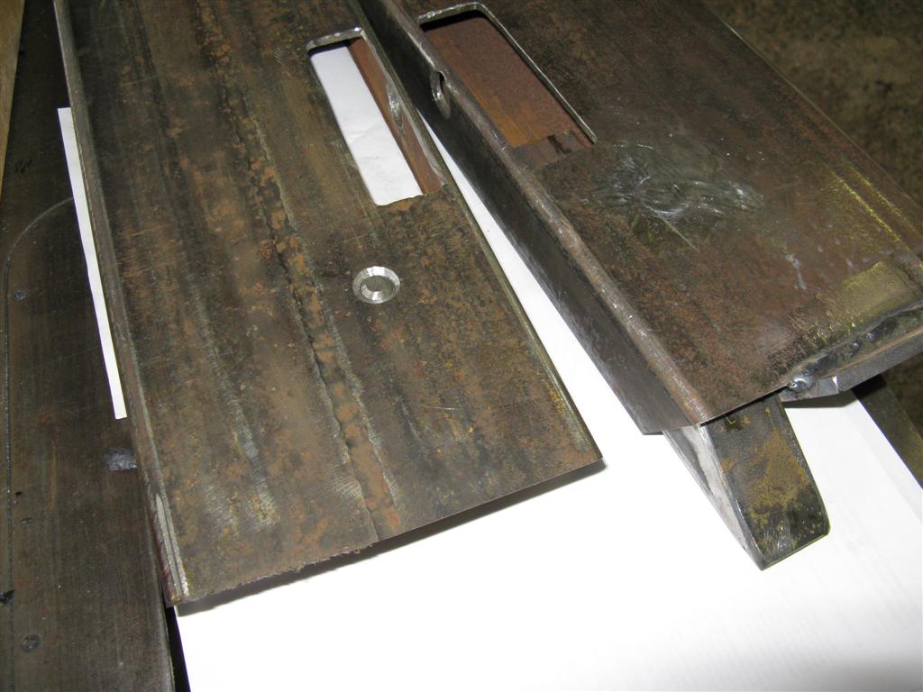

Here is the rectangular tube with cut out. The cut out allows extra room for the release / lock mechanism to work. The round pin keeps the lock pin captive against the tube wall.

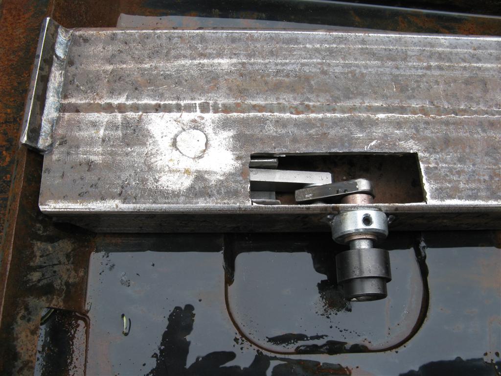

Now back to the rec tube. This is the main bearing and lever mechanism to drive and lock the pin. The lever mechanism will lock with an "over center".
here the lock pin and lever mechanism have been installed. The main bearing collar has only been tacked in place for now. I will also add a grease zerk above the set screw. The set screw locks the bronze bearing sleave in place; this allow the lever to adjusted to clear the cut out.

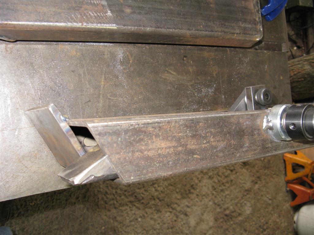

Now Have to weld the top cap plate to the rec tube.
This plate must finish flush on the front side. The angle of this plate is 45 deg.
View of the bottom plate with pin installed.

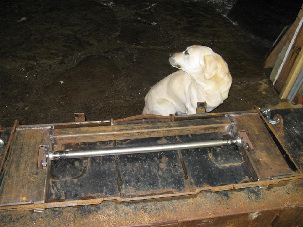

The main difference in this design is the ability to lock and unlock with only one handle. A thin wall torque tube is used to connect the latch levers. When I welded the short levers to the keyed shaft I was careful to align the key the same way. Before welding the torque tube to the hubs I bottomed both levers in the locked position to make sure they are oriented the same way. I turned the V-series 5/8" hubs down to fit inside the 1" steel tube; to avoid lathe work a large pipe size could be used. I preferred to turn the hub down to a light press fit to ensure they were square when welded.
Both sides are done; I have to make a short handle to fit the torque tube and then move on to fitting the QA to my tractor. My dog is a little camera shy;)

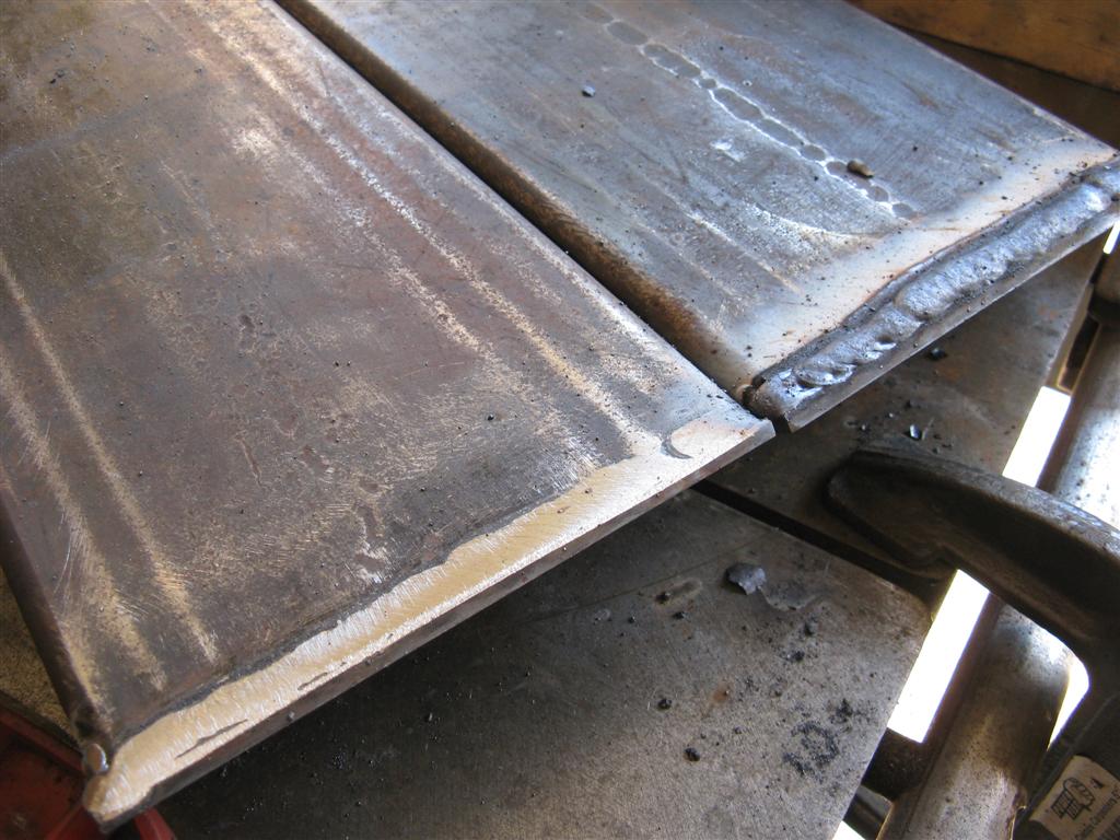

Tacked together. Note that the mounting plate is formed with a relief angle; if your bucket is not square to the tractor this allows you to engage the mounting plate easier. The top corner of the QA will have a button (1/4? on it to center itself better.
Here both sides are tacked together and it is sitting on my bucket.
