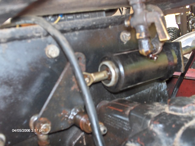

Carl,
If you have an older PT, it may have a unit called a Hydro-back. My 1445 has one that looks like this.
If you do have the Hydro-back, call Terry, and he will talk you through the process. It involves getting all wheels off the ground.
It may be as simple as cleaning out around the treadle, and lube it.
The Hydro-back is the black tube thingy in the center, which shifts the fluid to forward or reverse and is supposed to come back to neutral. I think that most of the treadle units will creep sooner or later.

The Hydro-back is right above the tram pump, and the lever on the left is what gives direction to the pump.
You may just have the hydraulic treadle, which uses feedback from the treadle to position the squash plate in the pump. There should be an adjustment of some kind, at the treadle or the pump.

I know how to adjust the 1445, which has a Hydra-back. Yours might be a Hydra-back, or hydraulic shifted. You should call Terry. The cable might need cleaning, and lubed.

Bob,
Thanks, that is the first time I have ever seen anything about adjusting the Hydro-back. It is usually coming from Terry over the phone. If I remember right, that is about how Terry told me to adjust the neutral setting. I know the replacement cable is about $115.00. Essentially the Hydro-back is a spring with in a spring, and they push/pull against each other to bring the lever back to neutral, that is assuming that the foot pedal is cleaned and lubed, and the cable is cleaned and lubed. . I took mine apart and cleaned everything. I sprayed some WD-40 through the cable, and then dripped some Teflon stuff through the cable. It's working about 85 % now. I have some pictures if I can find them.
009 Hydro-back location
002 Hydro-back separated
011 Hydro-back linkage
015 Adjusting nut
014 Shift lever
006 Tram pump, PTO pump. Hydro-back above tram pump

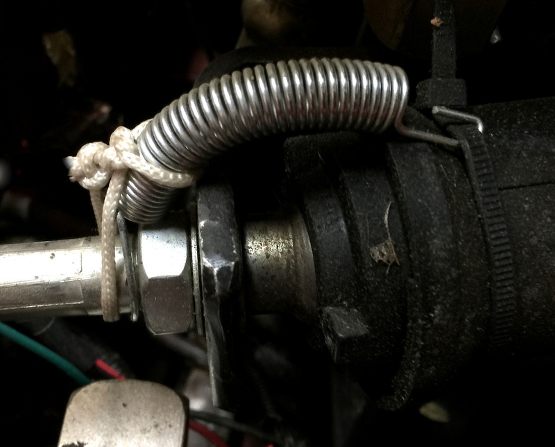

This may or may not help anyone based on my past experience with the older hydro-back cleaning and adjustment. I found that even after adjustment, there was still some play in the unit and it would still creep backwards. After I attached a spring to one end of the hydro-back the creeping stopped .. Link below .. If this applies to anyone else I can take a picture of the attached spring.

I would love to see a picture of your spring install.
/ Tractor rolls at idle #18
Not a problem Bob ..
Really more of a rig than an install nothing complicated but it worked for me and I haven't had a problem since. Not sure how useful it would be for anyone else but I was looking for a quick fix here it is ..
I had cleaned the cylinder inside and out and adjusted it several times. Each time the PT would still slowly creep forward or backward. The spring took up the little bit of play that was in the cable and cylinder. There was just enough play to cancel out the the adjustments I made...
