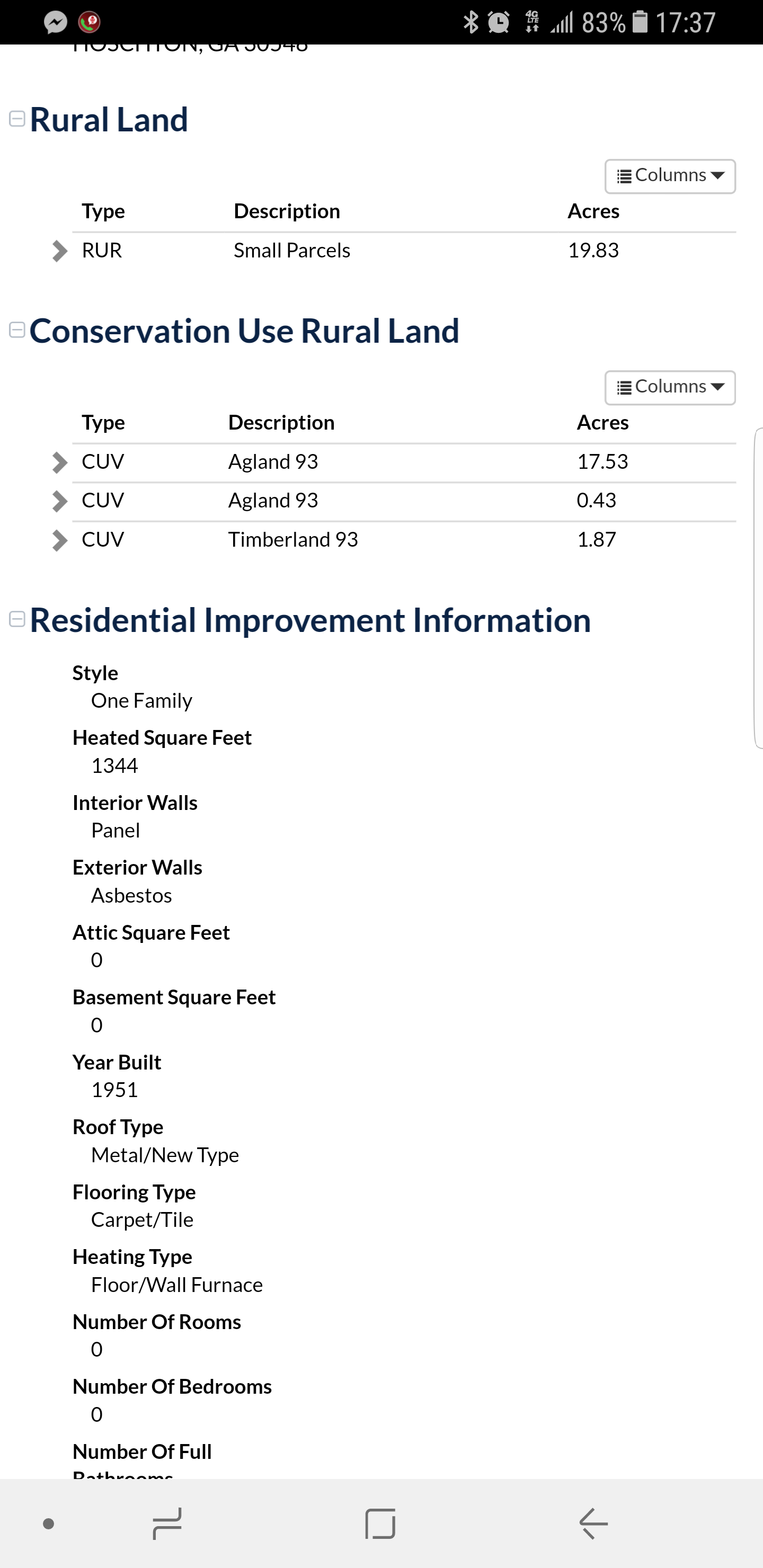

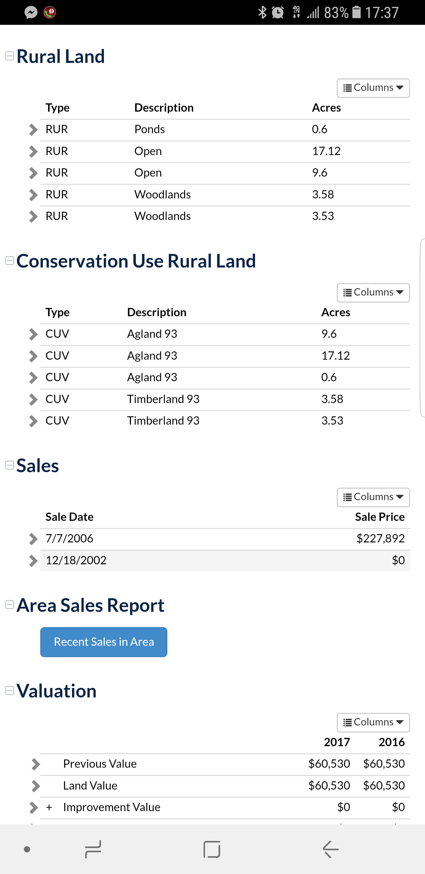

We just put money down on roughly 54 acres in north east georgia. Our family thinks were are nuts. Once the kids are done with school we will be moving out there. For the time being we will be getting everything back up and running. I am including aerial shots of the property as well as the breakdown of the land. As you can see there is an old house on it that is not uninhabitable at this time. Land is majority pasture, fairly flat. Back portion is fairly overgrown in parts with small saplings, brush, and some bamboo. I would like to get most of it cut back to use it for hay. Anyways i think i will be getting a LS tractor as they have been the most peasant to deal with and seem to have most bang for buck. So....what HP rating? Also what size cutter? Any other suggestions. Wanting to go cab tractor.
Front with house is roughly 19 acres and back is roughly 34. Front has the house.

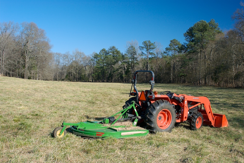

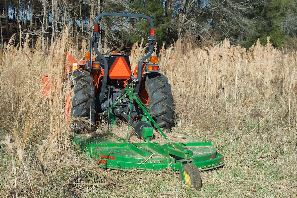

Well, just for a reference, I tackled this with my 45 hp tractor and light duty 6' cutter:
This is the end result:
It took a long time and there was only minimal brush mixed in, but it was not a problem for the tractor or the tiny mower. So as to a 10' mower I think a lot depends on what you are cutting and how wet it is. If the stuff in these pictures had been green and wet it would have been tougher if not impossible. Most cutters have a recommended minimum PTO hp. If you will be doing lots of pasture work you may need two. A 10' pull behind and maybe a 6-7' three point for smaller roads and confined areas.
