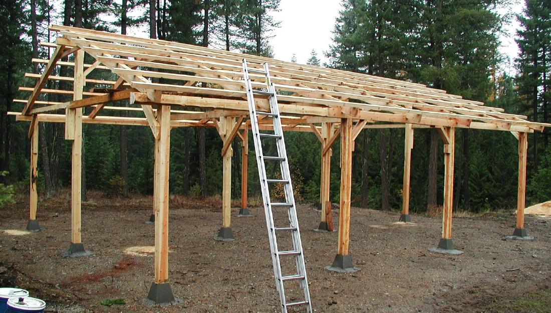

Its been awhile since the last post on this project, other things had to be done also, but winter is coming, so the push is on. The site is eyeball leveled using the bucket and backblade on the L4610. Wet down and wheel rolled a few times for compaction. I hand dug holes for the concrete to hold the pinned pier blocks, then mixed and set the same. The size worked out to 24 by 32 feet. No particular reason for that size, just seemed practical. I cut a few trees off the site (backhoed the stumps) and gathered a few more for poles, as you may recall on the last post my wife was peeling them. After some research on the net, and Dan McCartys suggestion, I bought a Logosol chainsaw mill and a Husky 394 from the local saw shop. This is a good setup for milling posts. I was carefull to keep the logs clean by carrying them with the fork attachments on the loader bucket. I am finding the fork attachments to be one of the most usefull implements I own.

This picture shows the site, and a couple of the milled center posts are set. The crude crossmembers only serve to hold them in place temporarily. The original plan was to build with round posts, but now I am going to build something closer to timber framed. I have not done this before, so I will wing it as I go. More pictures as the project goes.

Actually I was kind of letting the thread die. This may be a bit too primitive for most folks. No power, gravel floor, no insulation or enclosing walls. This pic was taken before I screwed the 29 guage steel roof on. The sawmill worked out nicely.

Would be kinda nice to see the finished project rather than letting the thread die an early death. Sometimes simpler is better. Good looking pole barn for somebody that claims they don't know what they're doing.
   / Tractor Pole Barn, part 3- the sawmill #13
ditto seeing the end of the project! Looking very good from your last pic. Folks need all sorts of different styles for their own applications, and from what I've seen so far on your project, it ain't no slouch job!! That will still be standing for your grandkids!
