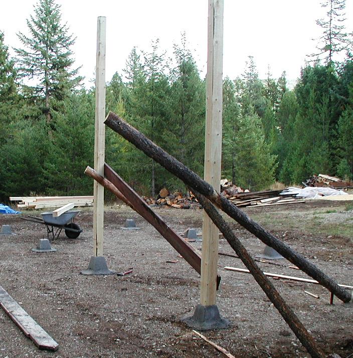

Its been awhile since the last post on this project, other things had to be done also, but winter is coming, so the push is on. The site is eyeball leveled using the bucket and backblade on the L4610. Wet down and wheel rolled a few times for compaction. I hand dug holes for the concrete to hold the pinned pier blocks, then mixed and set the same. The size worked out to 24 by 32 feet. No particular reason for that size, just seemed practical. I cut a few trees off the site (backhoed the stumps) and gathered a few more for poles, as you may recall on the last post my wife was peeling them. After some research on the net, and Dan McCartys suggestion, I bought a Logosol chainsaw mill and a Husky 394 from the local saw shop. This is a good setup for milling posts. I was carefull to keep the logs clean by carrying them with the fork attachments on the loader bucket. I am finding the fork attachments to be one of the most usefull implements I own.

This picture shows the site, and a couple of the milled center posts are set. The crude crossmembers only serve to hold them in place temporarily. The original plan was to build with round posts, but now I am going to build something closer to timber framed. I have not done this before, so I will wing it as I go. More pictures as the project goes.

Hello Treeboone,
I was curious on a couple things...
How long did you let the lumber dry before putting it use? {to prevent the twisting and warping etc.}
Assuming Idaho winter is like NY frost line about 40-48"...how come you dug the pole footings by hand? Why not a post hole digger?
Whew... that seems to be a lot of extra work...
   / Tractor Pole Barn, part 3- the sawmill #6
I have to say that I admire your ambition. That's quite a project to mill all the lumbar yourself and HAND DIG those footings! Looks like you've done a superb job.
John, good questions. First, how dry is the lumber? It has been a dry summer, so it ain't dripping (grin). The main supports are Lodgepole pine. They will split, but are not prone to the warp like Douglas fir.
I dug footings about 12 to 18 inches or until I hit native rocks. I once had a post hole digger, but there were so few places where it could be used (Rocks) that I traded it off for a back blade. We do get frost heave, but not bad enough to hurt a building like this. I suppose if it were conventional construction it would be a bigger concern. My house, and 2 small shops are built with round poles, so far so good. I suppose calling this a "barn" is taking liberty with the meaning. Maybe "well ventilated equipment cover" would be a more accurate description of the product
