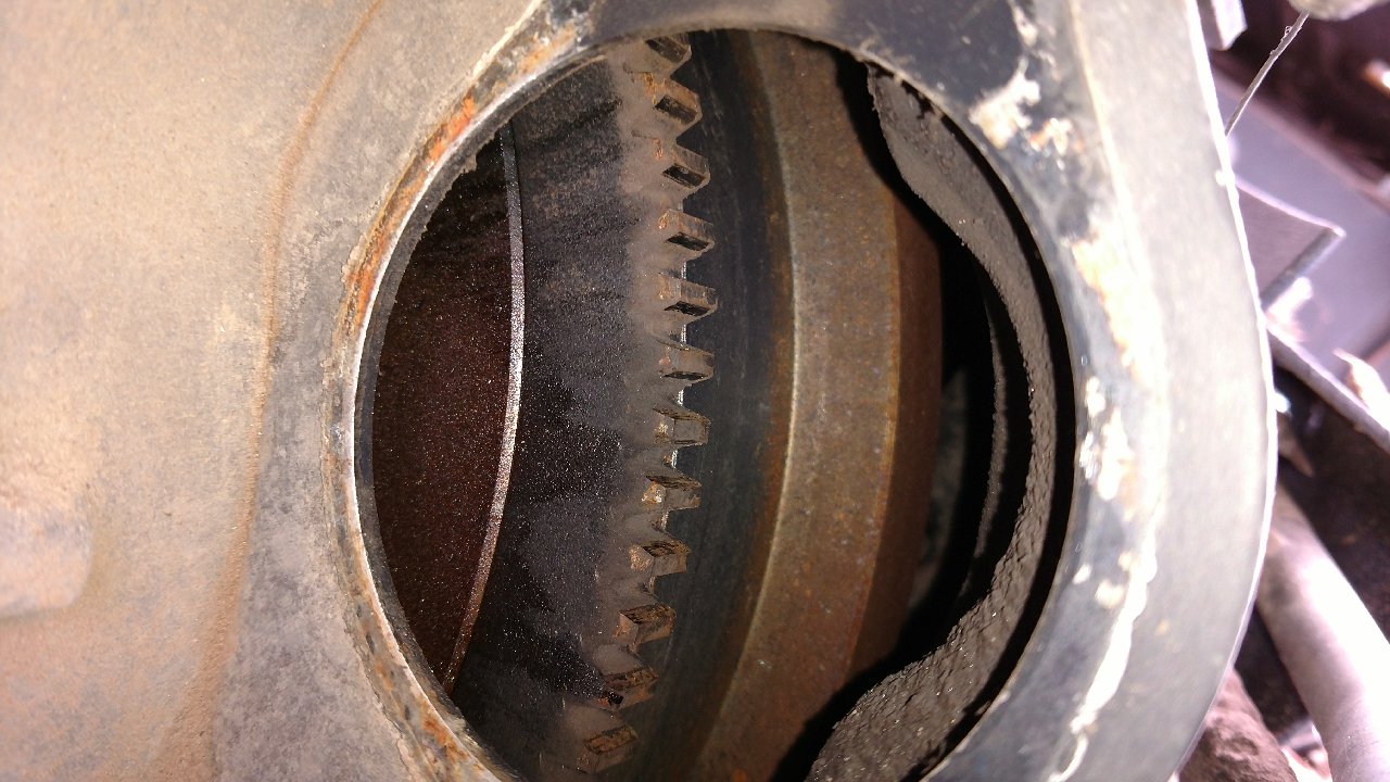

Can't get the tractor to start this morning. Starter spins but there's a grinding sound. I thought surely a bad starter but, pulled the starter out and engaged it and it's throwing the gear and spinning fine and that has me a little confused. I don't really know what else it could be though. I would welcome any alternative suggestions or confirmation of my initial diagnosis.

Check the starter gear. Are the teeth good, none missing or broken?
Check the flywheel where the starter engages for the same.

The teeth all look fine, none missing and no obvious chunks. The video was shot after re-installing it. Since it all looked good, I hoped that maybe it would work if reinstalled. It never does but, I hoped anyway.

That sounds like the gear isn't being pushed out to the flywheel. I used to have a truck that had a bad spot on the flywheel, it made a grinding noise. Good idea to check the flywheel at that spot but unless there's a big chunk taken out or something is no longer lined up it should make some noise more than a free spinning starter.

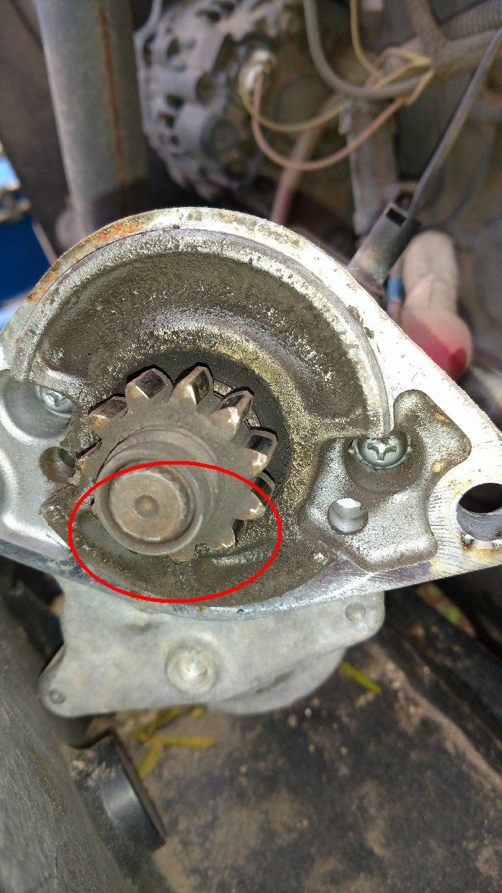

Here are the gears. I don't see anything but, maybe I'm missing it.

Take a picture of the gears in this area, please...

Spray the starter drive gear with some lube, looks very dry and possibly binding.

I would like to see the inside of that starter. I think you'll find something is sticking or broken inside it. The external gear spins but may not have any torque. That unit looks like it will have gears inside.

I decided to go with my initial impression and replace the starter. Fortunately, the dealer a couple of towns over had one and it's all fixed up. The only thing I don't like about living in a rural area is how long it takes to go get something like this if it isn't local. Almost 3 hours round trip but, at least it's fixed so I can get back to building the pad for my shop.

Looks like a gear reduction starter. It sounds like one of the gears inside it is damaged. I would keep the bad starter for parts. I find that when you're not in an immediate need things like starters are much cheaper on-line. That old one might be able to piece your new one back together years from now and buy you enough time to order one.
