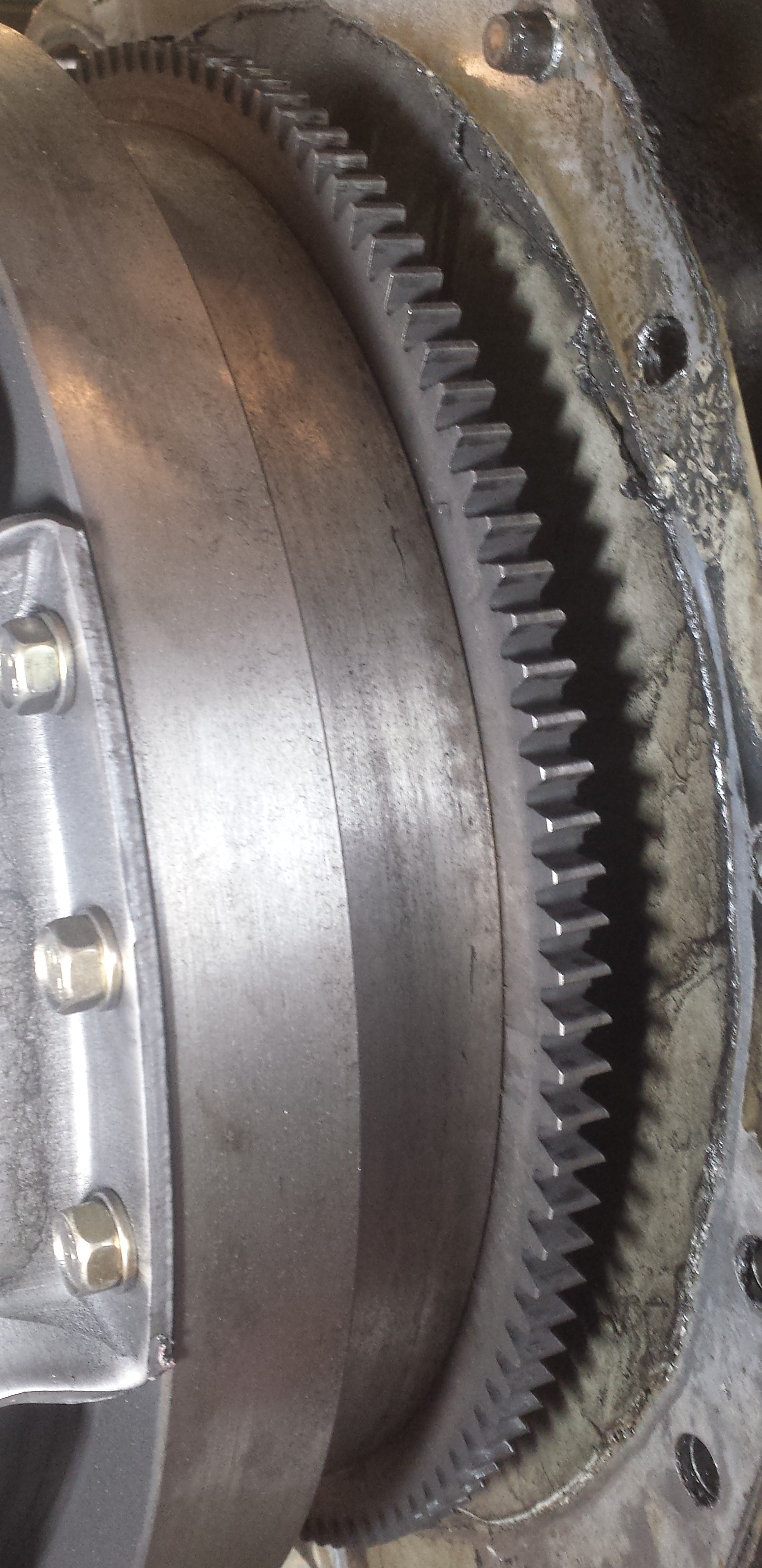

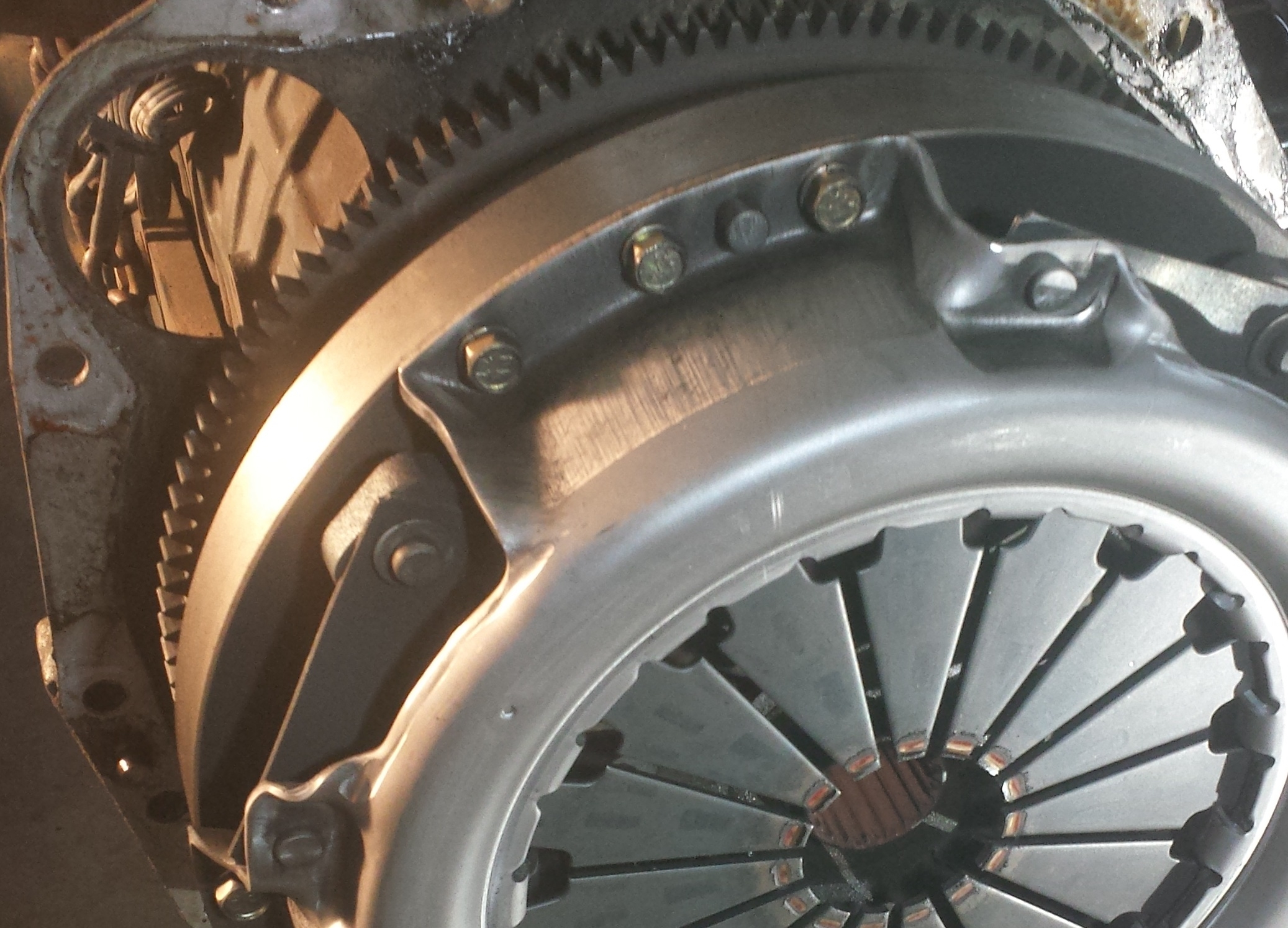

Sigh... This problem continues to plague me and I'm about to the point of splitting the tractor (again) to replace the ring gear.

The tractor is stored in a heated shop (see above). If the engine is cold, the starter gear just hammers against the ring gear and doesn't want to engage and spin the engine. (If I let it hammer the ring gear for a long time, it might get enough of a spin and start).
I have been using the block heater to warm the engine before starting attempts. Initially, this made the starter gear spin the engine and start perfectly. Then over time, it has become less effective and I've had to warm the engine for longer. Yesterday, I left the block heater on over night but when I went to start the tractor in the morning I got the ring gear hammering. I let it hammer and it eventually started.
Once the tractor starts and warms up, the starter will engage and re-start perfectly every time. If you turn off the engine and let the engine get cold, it will be hammering the ring gear again.
If the ring gear is so worn... why does the starter gear engage perfectly, spin and start the engine perfectly when the engine is warm?
With a worn ring gear, it seems like it should be failing to engage no matter the engine temperature.
I don't want to split the tractor unless I absolutely have to.
Thanks for any ideas!

Not sure what I should be 'marking'... the crank pulley? Not sure why it would start perfectly every time when the engine has been running and is warm?
Attached are a couple of photos of the ring gear from when I did the split a few years back. Not the best photos but they might show something others would recognize.
Thanks again.

Finally... this problem is solved.
Turns out, the starter had bad grounding when the tractor (engine and transmission) were cold. But that grounding improved when the tractor was warmed up. When the tractor got cold again, the grounding was bad again.
I added a wire from the starter mounting bolt to the ground point on the tractor frame. This provides permanent good grounding to the starter and it is starting perfectly now regardless of tractor temperature.
